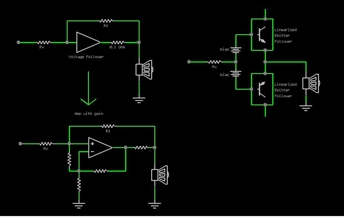

I am using two independent stage(Voltage Follower for output stage) in single global FB (current sense). I cannot reach many advantage from single stage like commonly used.

I think the inductive effect is more from the fact that the amplifier getting closer to its gain-bandwidth product has less open loop gain at higher frequencies and this the amount of feedback is dropping accordingly. This means that the feedback's effect on output impedance is going to lift with rising frequency and so up goes output impedance. I'm speaking only of typical amplifiers with lots of open loop gain and a global feedback loop. The effects are different for different topologies.
If you were you make a negative impedance amplifier it would depend again on the characteristics of your particular topology. If this were effected using positive feedback around the amplifier then the same rule applies; closer to the gain-badwidth product means less open loop gain, less feedback, impedance rises (generally). I'm sure there are exceptions to this very simple rule.
