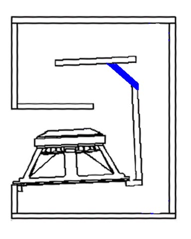

Although Brian’s "dogfood" method seems to work it also seems to have a negative side effect; lowering gain/efficiency at LF. When you narrowing the horn’s path bigger then 1/6 of its dimension it clearly looses its efficiency. I’m not sure about the explanation but I think that narrowing, forces the same amount of air molecules to pass trough the small 'port'. This results in a heavier air mass which results in loss in energy.
Instead I’m wondering about expanding the hornpath at problem areas. The whole horn system is based on this principle. Expanding means lowering the airmass trough the path. This results in gain.
Now, when we expand on those corresponding places (1/2 wavelenght) where dips occur (as part of the design) maybe there is a change we can influencing the dip in a positive way without changing the efficiency at LF (the longer wavelengths will not ‘see’ the relative small expansion since it doesn’t correspondent to their frequency).
For the THAM I think there is this extra space/volume for dip-correction. If it generates enough extra volume is another question but maybe somebody with Akabak knowledge could help us here.
In my new suggestion for dip-correction you can see I get the extra volume from the corner correction at the other side. This will be around 1meter in the pathway. Probably this new suggestion works even better if the other two corners in the same segment have corner bracings (corner corrections).
1meter 1/2 wavelength has a corresponding frequency of 172Hz, just where the dips is...
What do you guys think?

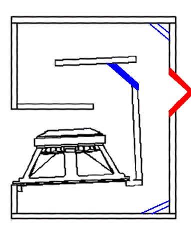

A more dramatic approach would be generating extra volume at the outside. Maybe not very practical but you could make it perfectly fit with center frequency and outlines for the working limits (changing Q).
(now you can also see where the idea came from... the extra volume in corners and their corresponding frequencies in the upper band 😉 )

The problem area you've identified in your diagram is incorrect. The DFD is actually located at bend #3 (starting from S1), not bend #1.
Another idea I had to deal with the notch was to include a resonater at that point (by basically adding a false bottom to the horn with an opening of suitable size that opens into bend #3), but I didn't know how to sim that, and it would increase overall volume, which might be better spent making the horn larger 🙂.
Whoops - no, you're correct - I forgot that I tend to look at the THAM design with the driver on top, not below.. 🙂

If it were my cabinet, I'd try adding a small restriction on the last horn part above the speaker.1meter 1/2 wavelength has a corresponding frequency of 172Hz, just where the dips is...
Clamp a 20mm, 40mm, 80mm etc. wide piece in there and measure the results.
No cabinet damage if it does not improve the response, and the test should only take a few minutes.
Unfortunately, if the "fix" corrects the dip, it will probably also add a peak somewhere else 🙁.

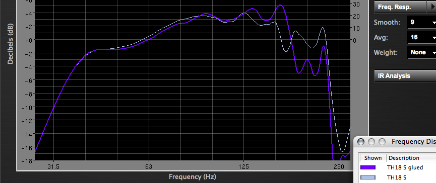

Just noticed the upper response changed quite a bit in my Keystone TH cabinet between the clamp test and the build.
The differences as far as I remember was the addition of a 3/4 inch by 2 inch front panel cleat the width of the cabinet (about a 7% reduction in area), two front panel braces, each about 3 inches, and I also rounded the inside and outside of the opening.
The out of band loss is of no consequence for my use, but a seemingly small difference may have a larger effect than you might think it would.
