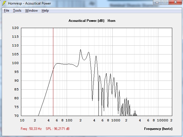

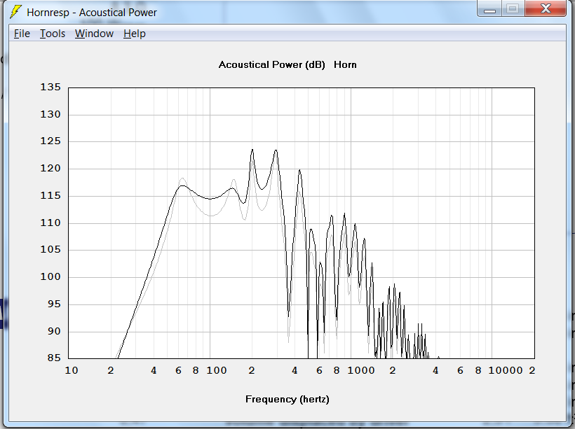

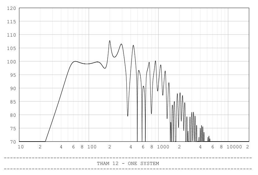

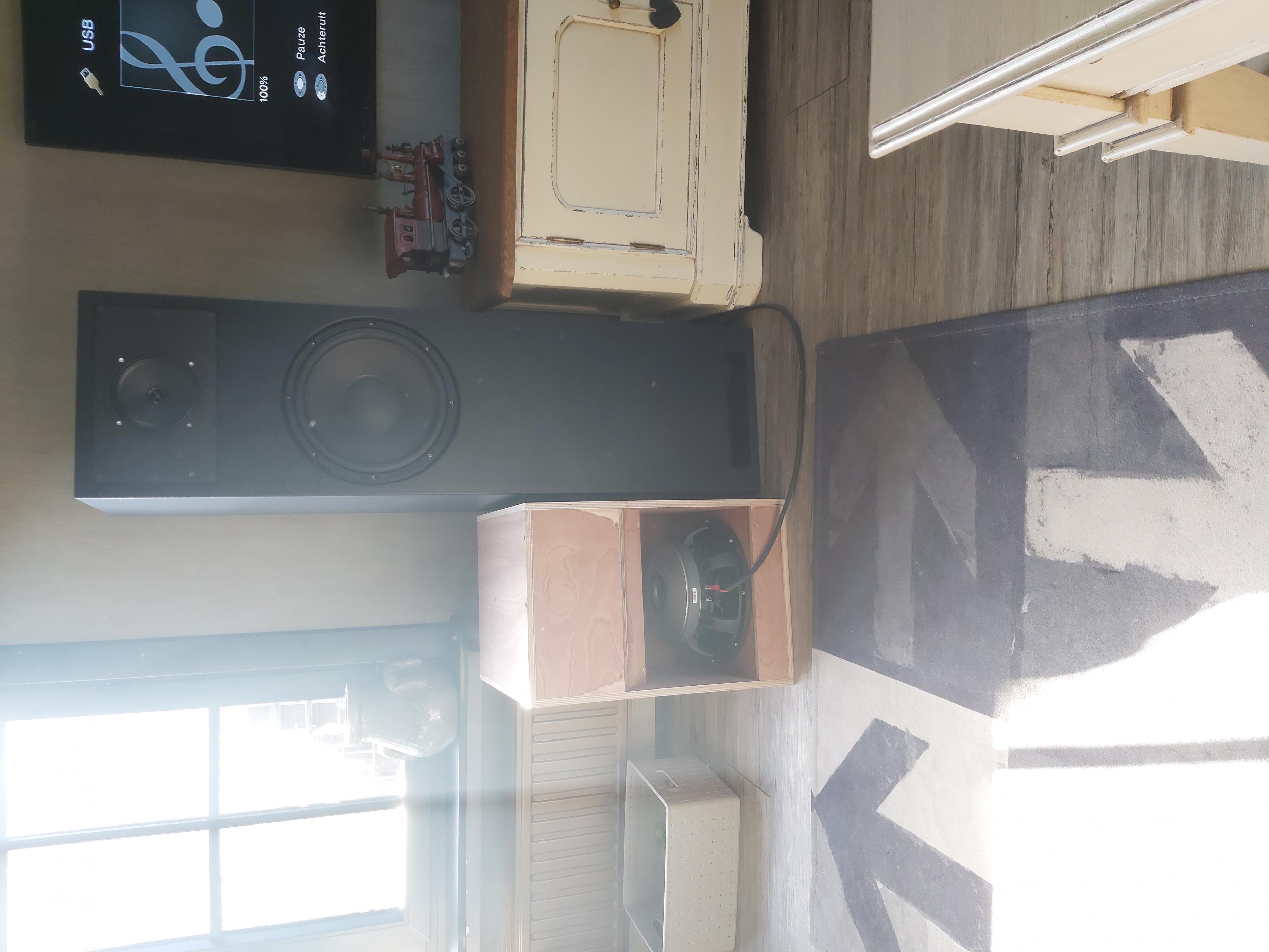

THAM12 - a compact 12" TH

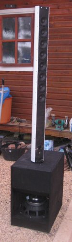

THAM 12 + 8x 3FE25
IMG_1181_cropped.jpgthis one uses the faitalpro 12" and 8 3FE25 as line top.
working on a DSP version with 8 active channels (ADAU1452 + 4xTPA3116) for beam steering and shading, not yet ready ...

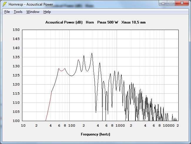

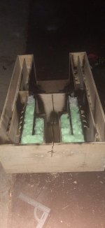

Nice. I need some bass boxes for my system, not larger than Peavey FH-1 but going lower. And I need this "horn kick" to be present. A folded tapped horn should deliver that, now I need to find out the model that would fit the best.
I have good luck with the roar layout and even catering to TS parameters and changing it slightly. (Longer and skinner) or (shorter and wider) is a function of Vas (and tge Qts fir Fs) or that approach seems to work for my drivers.. a bms 12 pair recently(friends build) . And splitting the initial path into a stepped can get some car audio drivers with Bl^2/re to work very good it seems. You can get really creative if a stub is positioned and tuned with conjunction of the system. (Rabbit hole to be honest).

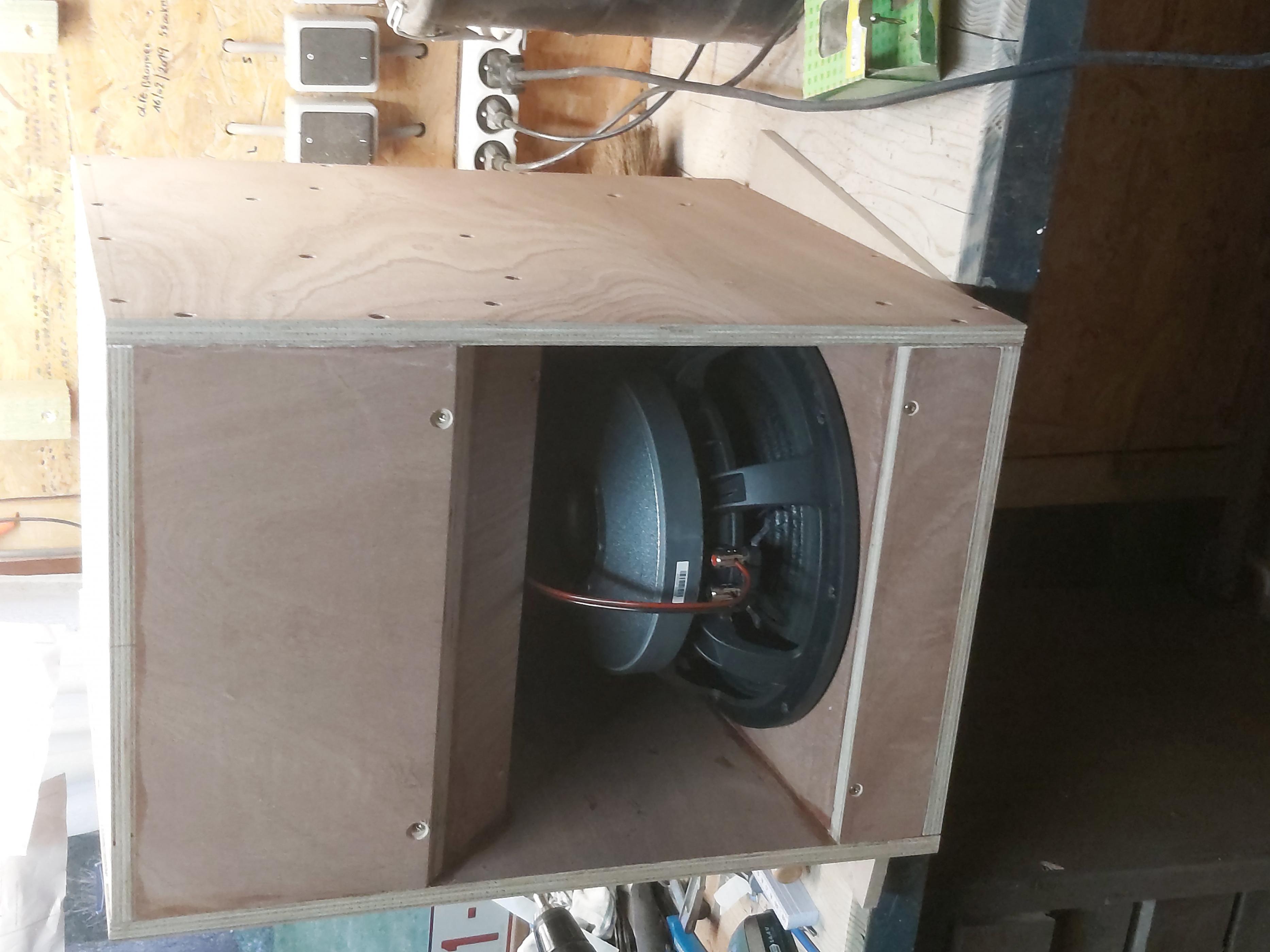

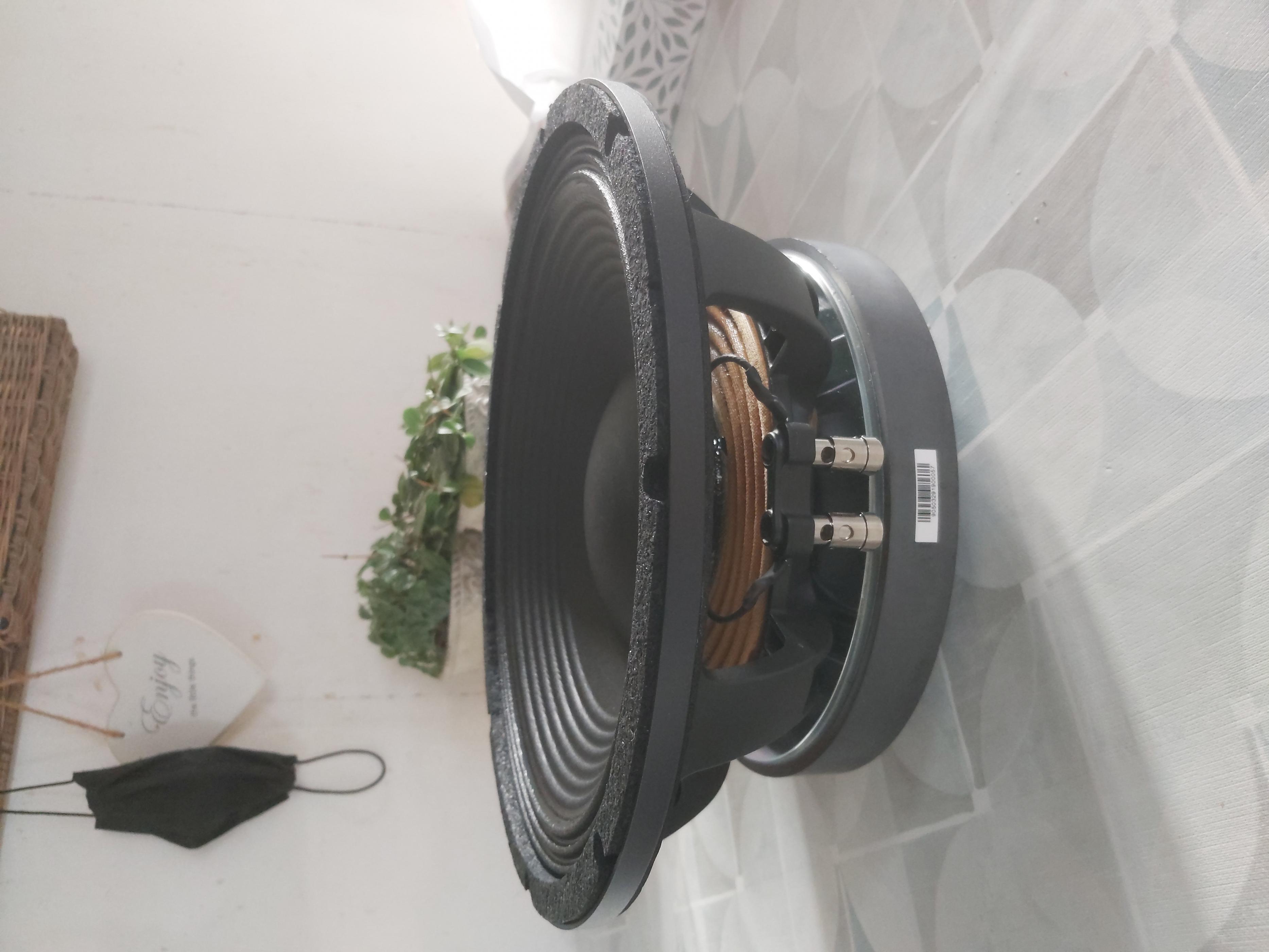

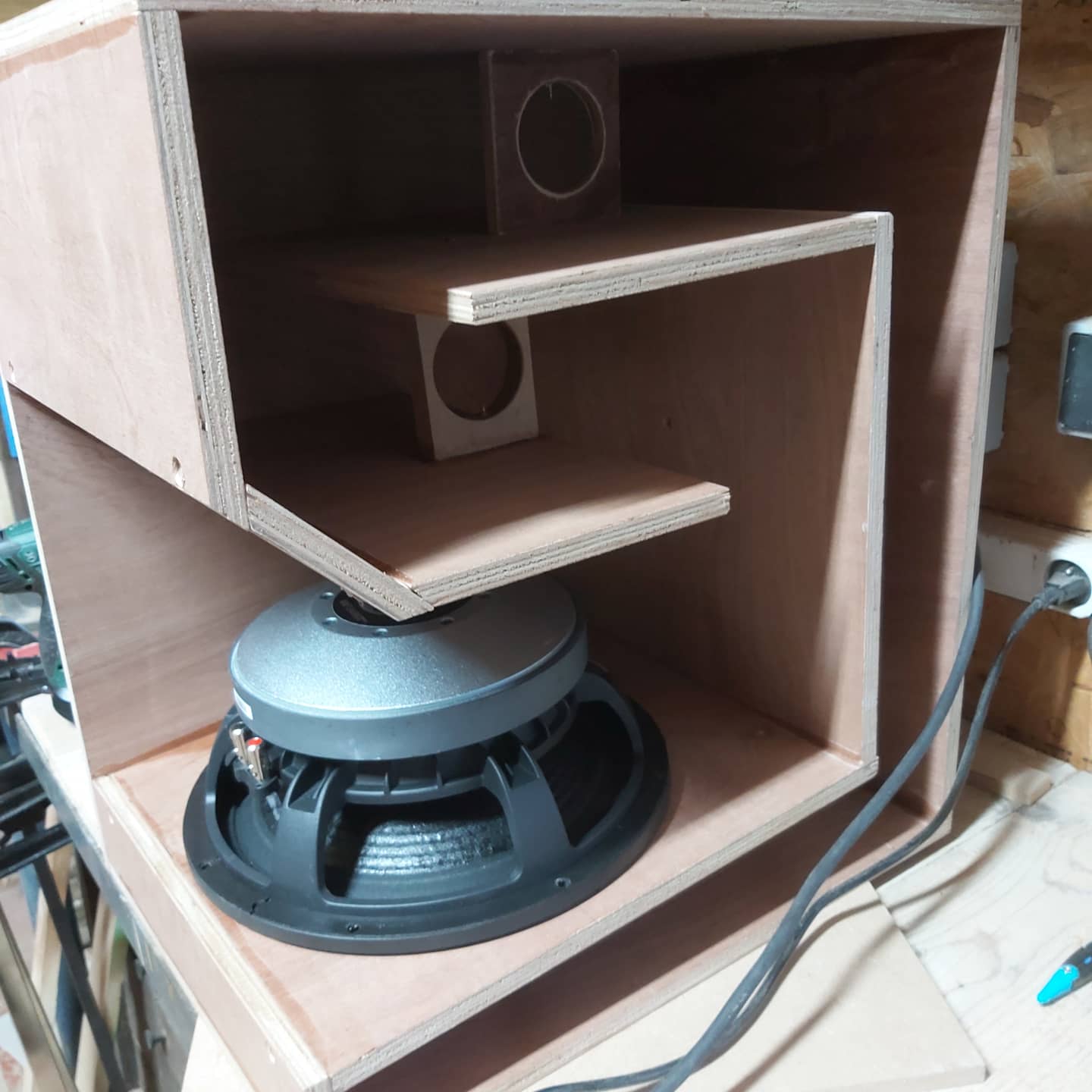

Here ar some pics from the tham 12 with lavoce waf124.01.
Actualy I like it alot,like more product from lavoce.
I made the tham 12 35cm wide inside instead of 32cm.
Could not get to the bolts with my big hands.
Playing with 1600w on that driver from 40-150hz 48/24db.
For about 108€ ex vat hardly find better I think
