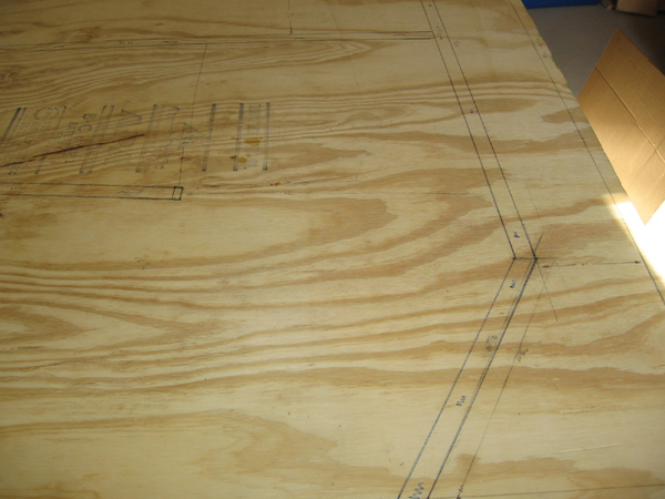

Reviving a old thread, question for the guys who built this. I am having trouble figuring out were the angled piece begins and end. I know it is 60 degrees from the out side edge but were do I mark out my 60 degree line. Hopefully my question makes since. I see that they have a 4" measurement from the inside of one of the out side pieces, to were the joint would be. But how far in do I measure off of.
Any help would be appreciated.
One more thing as I am thinking about it, if the overall dimensions are 45x48x11", if you cut 1/4" dados in both sides, that would total a 1/2". Subtract that from 1 1/2" between the 2 outer panels, which makes each panel 1/2" or 1". Then you only cut the rest of the panels 9 1/2" once recessed in the 1/4" dado you would have a overall outer dimension of 10 1/2". Wouldn't you want to cut the inside panels to 10". Man I hate trying to type this out.
Here is a picture of what I am talking about hopefully this helps you help me.
I cut rabbets and dados in my build to ensure a solid build with no air leaks. I kept the interior volume the same and made whatever dimension adjustments I needed to not disturb the dimensions in your drawing.
It appears the distance from the right side of the angled lower speaker baffle to the left interior horn throat wall is 9.25".
If you decide to use dados or rabbet joints the interior height should remain as designed, 9.5".
If it's the interior height should remain 9.5" then I just need to compensate for the dados by adding .5" to the interior walls.
Thanks a bunch I think I have what I need to properly get the template laid out.
