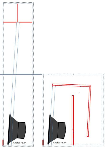

Hi NWCgrad,
I derived a sideview of the driver from the data in Post #61.
Working from bjorno's Hornresp model (Post #61) I ended up with a first try that uses a constant 3 degree angle. This is just a first stab at it (still a little bigger than necessary), but at least you can get an idea of where this goes, and maybe it's just fine as it is, anyway:
My questions right now are:
1. Is the overall size acceptable?
2. Do you want to build up the baffle boards as bjorno described it in Post #57?
3. Do you want to add a center divider to support all the panels (this adds one wood thickness to the interior width, unless you cut a lot of holes/cutouts into the center support)? In this 1st try I added the displaced volume to the duct height.
4. Where do you want the port to be located? Bjorno's Hornresp places the port directly adjacent to the front of the woofer. A round port in that location would also be my preference.
5. I'm drawing with 18mm/0.709" wood thickness, if you want another thickness, this would be the time to change it.

Hi NWCgrad,
1. Is the overall size acceptable? - I like the height, but seems a little deep. I can live with it.
2. Do you want to build up the baffle boards as bjorno described it in Post #57? - I have not seen other builds do so. But with strong bass output down to 10 Hz it is probably a good idea. Can the baffle with the driver be 2 sheets like bjorno originally called for?
3. Do you want to add a center divider to support all the panels (this adds one wood thickness to the interior width, unless you cut a lot of holes/cutouts into the center support)? In this 1st try I added the displaced volume to the duct height. - since the hieght is okay I would leave alone. I had planned on cutting shapes fewm to bracing but it would be less work not to.
4. Where do you want the port to be located? Bjorno's Hornresp places the port directly adjacent to the front of the woofer. A round port in that location would also be my preference. - I thought bjorno indicated that by being as low as possible it maximized low frequency extension. I leave this to the experts.
5. I'm drawing with 18mm/0.709" wood thickness, if you want another thickness, this would be the time to change it. - That is the thickness I would use 3/4 inch).
Don't quite know when I'll get back to this, but it won't be too long.

Hi NWCgrad,
Here is the 2nd attempt at bjorno's T-TQWT for the Maelstrom 18", as we discussed, I tried to get as close as I can to the simulation values (this time not adding any additional volume for braces or stuffing), particularly for the L23 and S2/S3 dimensions, the rest flows from there assuming a constant expansion angle.
I'm also showing a number of suggestions as to stuffing (we still need bjorno's final density and placement calculations), bracing, driver mounting, access plates (for driver and stuffing) and S4 location(s). You should work out how to interconnect the boards, etc., a great example is Danley's DTS-10 kit: Danley DTS-10 "Super Spud" DIY kit .
I hope this will give you a starting point from which to decide how to put the puzzle together.

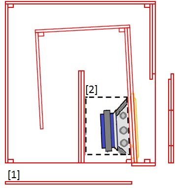

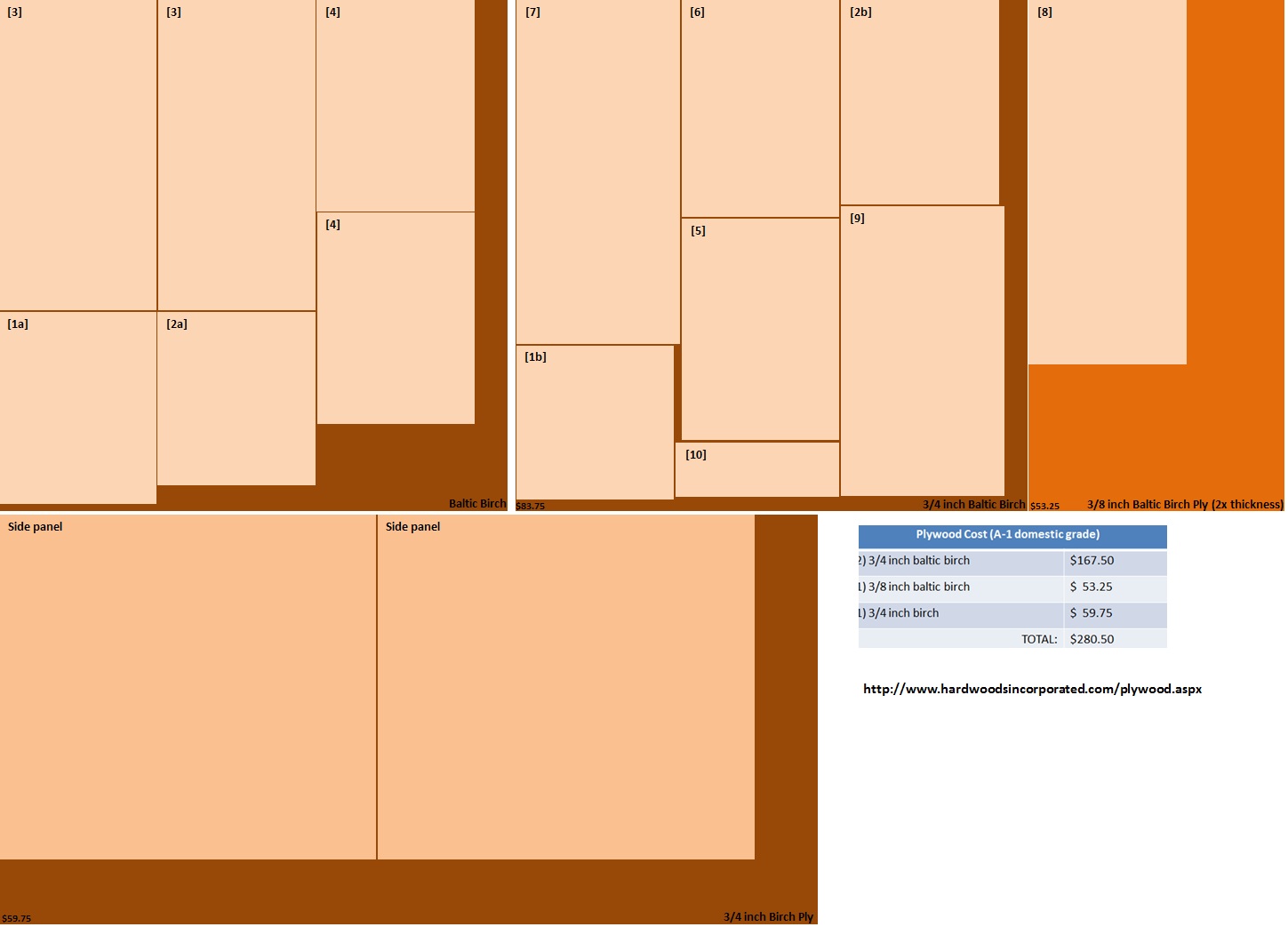

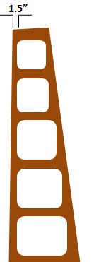

Oliver,
Thank you for the dimensions, they really helped with my cutsheet preparation.
Why is the bottom panel separated and not a solid single piece [1]. Is this to assist with putting this heavy driver into the enclosure?
I added a side panel [2] to allow for two persons to assist with installing the driver, but I am concerned about air leakage.
I will add significant bracing as shown in your earlier attachement, but is 1.5 inches of material on the edges sufficient (see attachement)? This diagram is not the exact scheme I would use, but it shows the general idea. I assume the braces should be 3/4inch plywood.

Why not have the whole front panel removable?
Hi NWCgrad,
In reference to your Post #74: I made the bottom piece removable to provide access to the duct sections that need to be filled with stuffing, and to the back of the driver; the little portion of the bottom panel at the lower right I left fixed to strengthen the box; A side panel (or two) (your #[2]) should be helpful, especially if you decide to mount the driver from behind the driver mounting baffle (the S1/S2 side). For the bracing I would go with about 2" minimum where possible, and maybe round holes or triangular cutouts; 3/4" thickness should be adequate.
