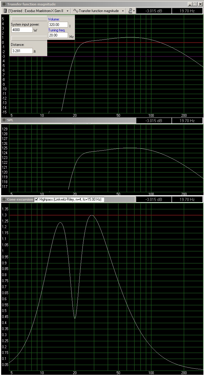

A basic 320L total volume, 20Hz tuned vented alignment utilizing a vent of 365cm (Equivalent to 2 6" flared ports) seems to have just as much sensitivity and maximum output as the TQWP presented here over it's useful bandwidth. In addition the vented alignment will have better response in the time domain and could potentially be used up till 150Hz or higher if needed.
The TQWP seems quite similar in operation to a 6th or even 4th order BP. What are it's advantages against them?
Josh, I modeled the 320 L vented alignment in WinISD (attached) and it looks pretty good. It is also quite a bit smaller, which may be of importance in many rooms. For my particular requirements I think the TQWP is better suited as its - 3 dB extension is around 13 Hz vice - 14 dB for the vented alignment at 13 Hz (- 22 dB w/ 15 Hz HPF, 4th order LR required to maximize SPL). To match my 4 sealed LAB-12 subs I need an output of 120 dB - not that I will ever play it that loud as I tend to listen to movies below THX reference level as I find THX level to loud (I must be getting old!)

Here is a vented system to compare to the proposed TQWP. Sensitivity and output headroom seem to be virtually the same as does driver excursion at the same input voltage. The vented system could be used up to 125Hz instead of maybe 55Hz max. Yes the port is quite large and long but it is not that difficult to pull something like that off. Many have done it. I'd expect maybe 4-6db of port compression near tuning at full tilt with that vent area and driver. The TQWP only has a 394cm mouth which isn't that much larger so there might be some compression there as well. Also all of the horn type designs that I've seen tested all have significant compression at maximum output levels too. The maximum output appears to be about the same all in all but the TQWP has much more restricted bandwidth, will probably ring mightily at 58Hz and exhibits worse group delay. I'm not seeing what the big advantage is?
Josh, no issues on my end as I am exploring the options so that I can make an informed decision on my next build. When I followed the crowd and built a sealed 24" cube for the driver I did not model the response. This configuration would be great in multiples, but a single one does not allow me to fill in the missing octaves below the LAB-12's. I modeled it with LT and could get down deep, but excursion limited output to 110 dB or less.

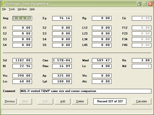

The HR program models the vented enclosure you show a lot better than WinISD. I am having a hard time figuring out the port size from the input screen shot - I am not very good with HR.
