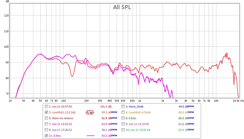

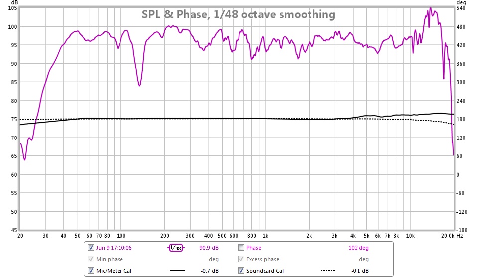

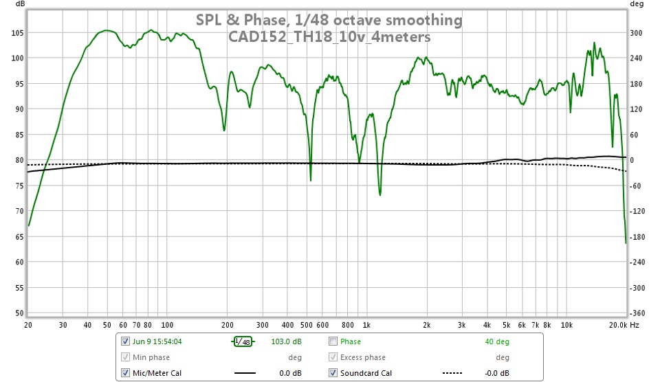

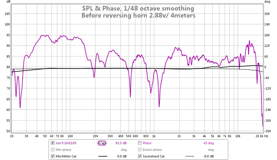

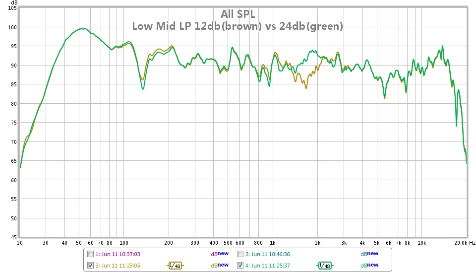

second round measurments
I was able to do some more measuring and wanted to share.
The setup is the same as before, but levels have changed, since I don't have a SPL meter.
REW with a DBX RTA mic and a not validated calibration file I found with google. External calibrated Yamaha Steinberg soundcard, DBX DRPA+ setup with LOW: HP 30hz/24db, MID: HP 100hz/12db, LP 1.12khz/24db HIGH: HP 1.4khz/24db. MID and HIGH has a 6.2ms delay to allign with the sub. The mic is 4meters from the speaker and 1.6 meters high, pointing directly to the horn.
Before:
After:
In the after I reversed the leads on the horn, which I think helped removing quite a few dips in the mid area.
These are only frequency measurements, so no THD, Phase etc. so far.
I did actually made an attempt to make SPL measurements with the XTA mic, John Reekie method of making SPL measurements without SLM but I am not able to read and verify the results.
The measurement below ended up being a 10volt measurement, I think because I made some initial SPL calibration settings with a headroom first being to small for a 2.83v input(clipping) and then making a headroom to big(+20db), which called for the high output?
The mic is 4 meters from the sub and 1.6 meters above ground and the 10 volts is measured by plugging in an extra speaker cable in the bag of the sub(parallel) and attach a Voltmeter at the end of that cable.
Input is very welcome.
I am planning on doing more measurments i.e. I want to make sure that the metal grill, which has 47% airflow has no negative impact. And later excursion vs. Cone correction testing etc.
Let me know if you have ideas, also on good maesurement practice.
Best, Andy

Andy,
Your second round measurement looks very good - nice job. The 150 Hz dip looks to deep and sharp to be a floor bounce cancellation. It is probably too narrow to be noticeable but again I was hoping to see traces from each individual driver to debug this. You said that you have not made HD measurements but you have. In REW all measurements automatically generate HD data - just click on HD tab at the top and select harmonics of interest. It is helpful to see first 5 harmonics.

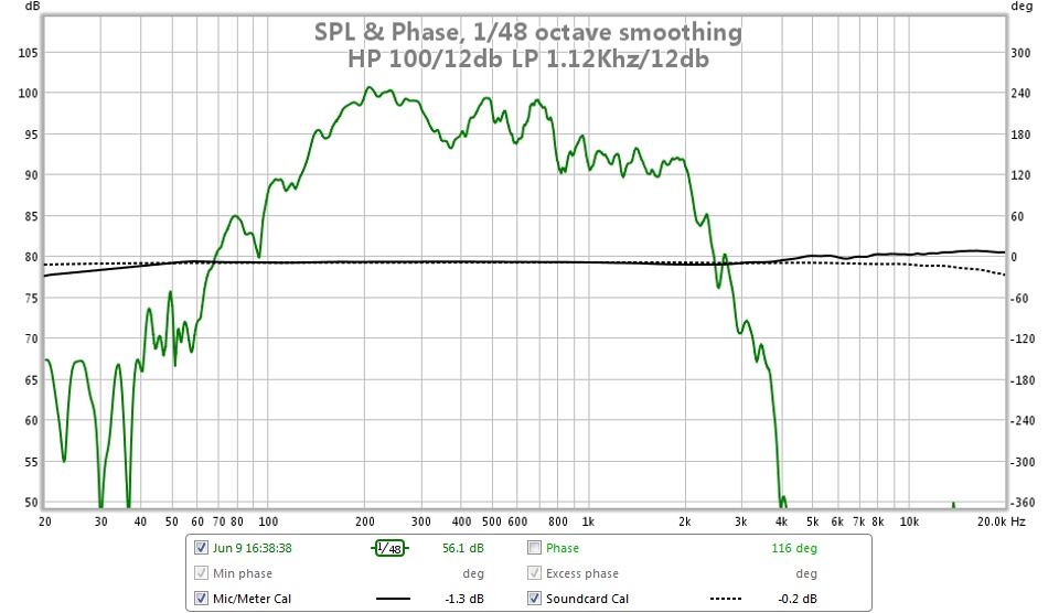

xrk971,
Correction: The LowMid XO is 12db both flanks and not 24db HP.
Thank you for comments and info.

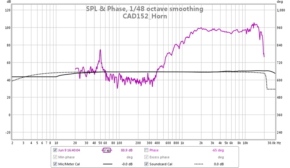

I have the separate measurements for LowMid and Horn:
LowMid: (HP100hz/12db and LP 1.12Khz/12 db)
Horn: (HP 1.4Khz/24db -7db)
Old measurement of TH-18 Sub:
Can't seem to find the HD tab as you mention. I am using REW ver.5 buil 2142.
/ Andy

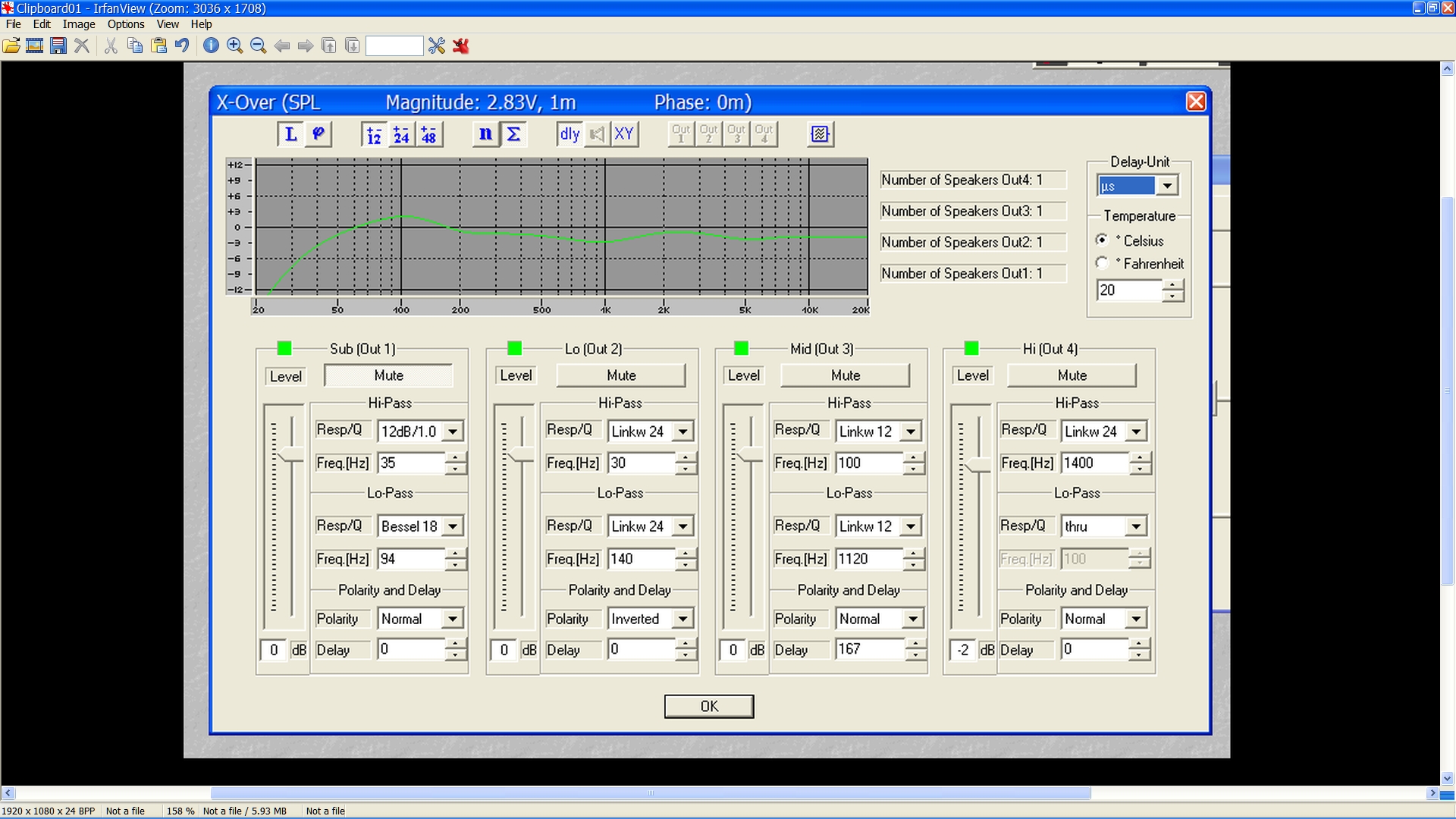

That's the HP filter. I was asking about the LP filter. I'm assuming that he's not running it full range above that 30 Hz HP filter.
FWIW that dip around 125hz is phase related. Your woofer should 180* from both the mid and tweeter. The response could be better if you didn't mix/match the LR2/4 filters. When you get the drivers in phase a-5db dip happens around 1khz. It's gradual from 125hz. Then you get a 3db peak @2.5khz ramped from 1khz.
Have you got any other xo filter type options?

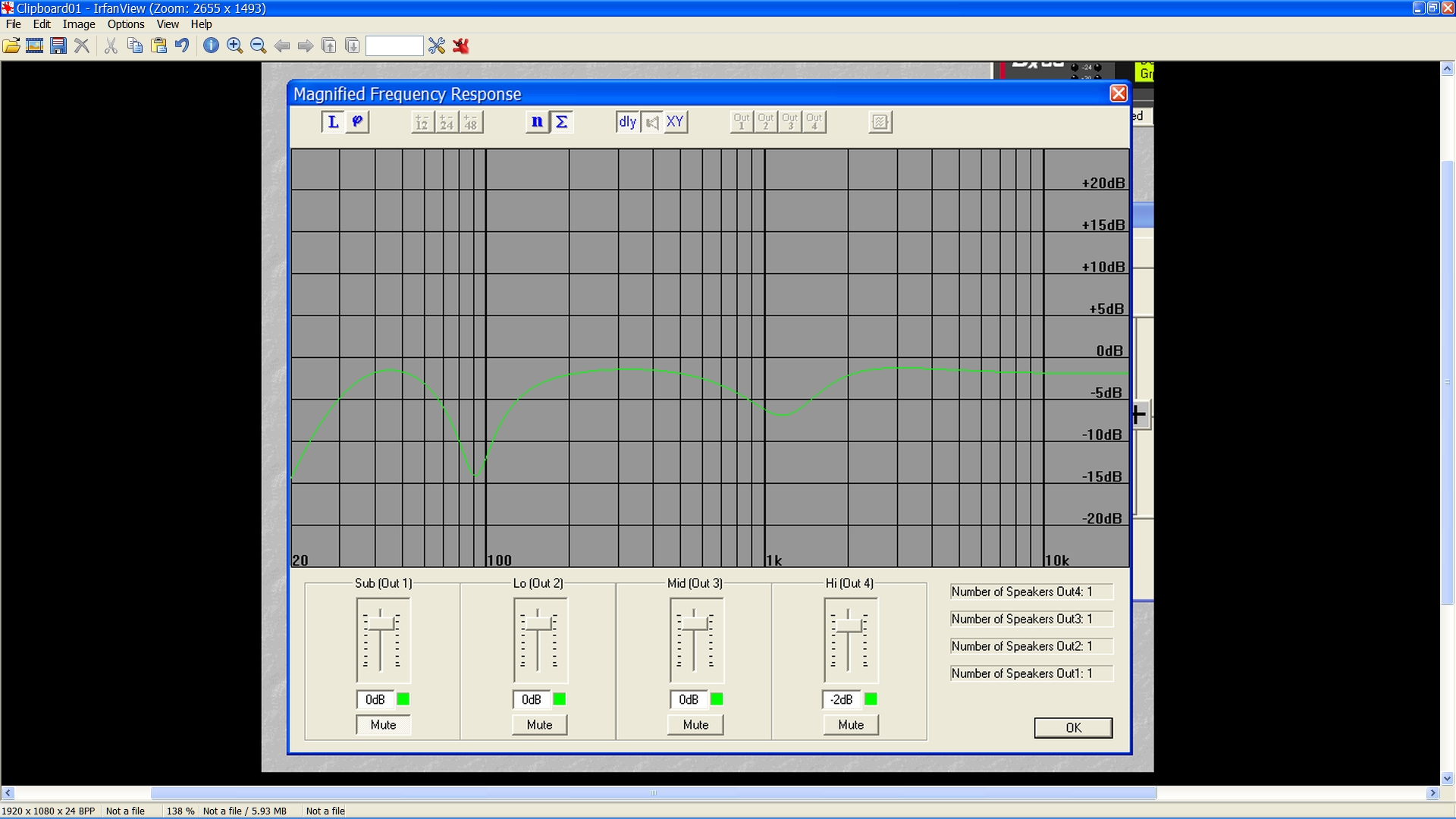

The second image is an approximation of the response using the settings you posted. No EQ., no delay, no frequency/xo optimization. ... pretty ugly.
Unless the drivers are compensation for the holes in response this has to be tough to listen to.
Thank you all for your inputs,
I was having a good time yesterday playing around with measurements and making adjustments on the DSP.
Chrapladm:

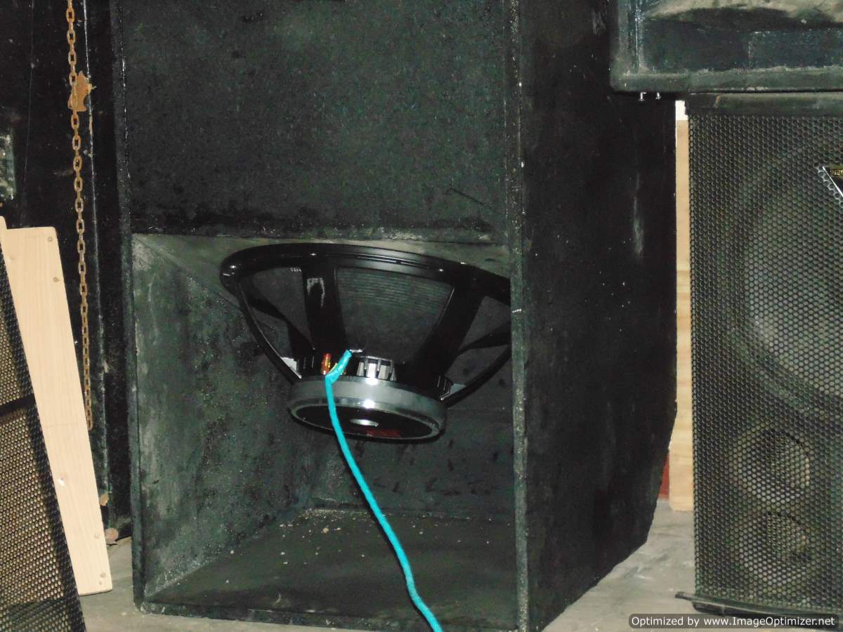

Yes I am using b&c18sw100 driver in the subs. The one I was doing the measurments on is the latest of four built and is the version one of Xoc's design with cone correction from Djim. I think the low end will be better after some time, - that is my experience with the others that I built.
Puppet:
I ended up using 24db on both flanks where the LowMid and Horn(tweeter) meets: LowMid: LP 1.33Khz/24db LR and Horn: HP 1.4kzh/24db LR.
Thank your for your input.
What is the prg. that you are using to predict crossovers?
Going from 12 to 24db on the LowMid:
wg_ski:
Thank you for your sugestion on adding delays. This turned out to be quite a learning experience.
Delaying the sub:
I found that the 6.2ms that I dialed in wasn't correct, so I changed that to 8.98ms, which had a very nice impact on the measurments on the 70-150hz area.
I see now that this delay should always be considered every time you change the positioning the subs ie. at the venues.
Before/after delay on Sub:
Delaying LowMid to match the Horn(tweeter):
The horn(tweeter) is 20cm deep, so according to my calculation that comes to around 0,589ms delay at the mouth as a starting point. The LowMid being a conventional cone I thought it would take a bit less delay, but I ended up with the best results with 0,65ms delay on the LowMid.
I put the wiring of the Horn(tweeter) from reversed leads back to 0 degrees phasing.
After dialing in all the delays:

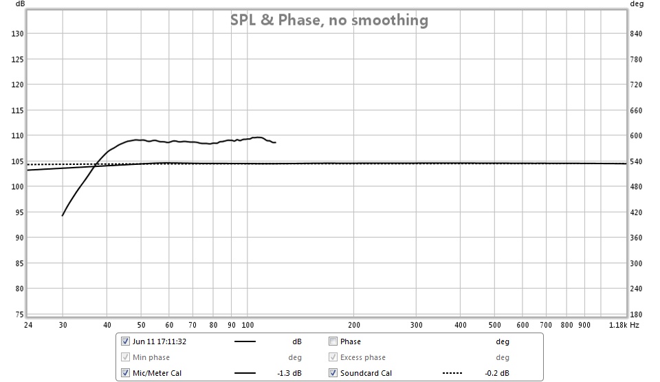

Can someone tell be how you measure the -3db point on the Sub?
The last picture is an attempt to measure SPL with 2.83 volts 1m.
It is done with a SPL calibrated(John Reek mehod) DBX RTA mic, so not a validated response.
The sub only has not been played at high volumes, so that could be the reason for the early drop in the low end? I used that Sub because I wanted to test if my grills with 47% airflow was having a impact on the sound,- which it didn't at low volumes.
SPL on Sub - with HP 30hz/24db:
Thank you all again for your kind inputs
/ Andy

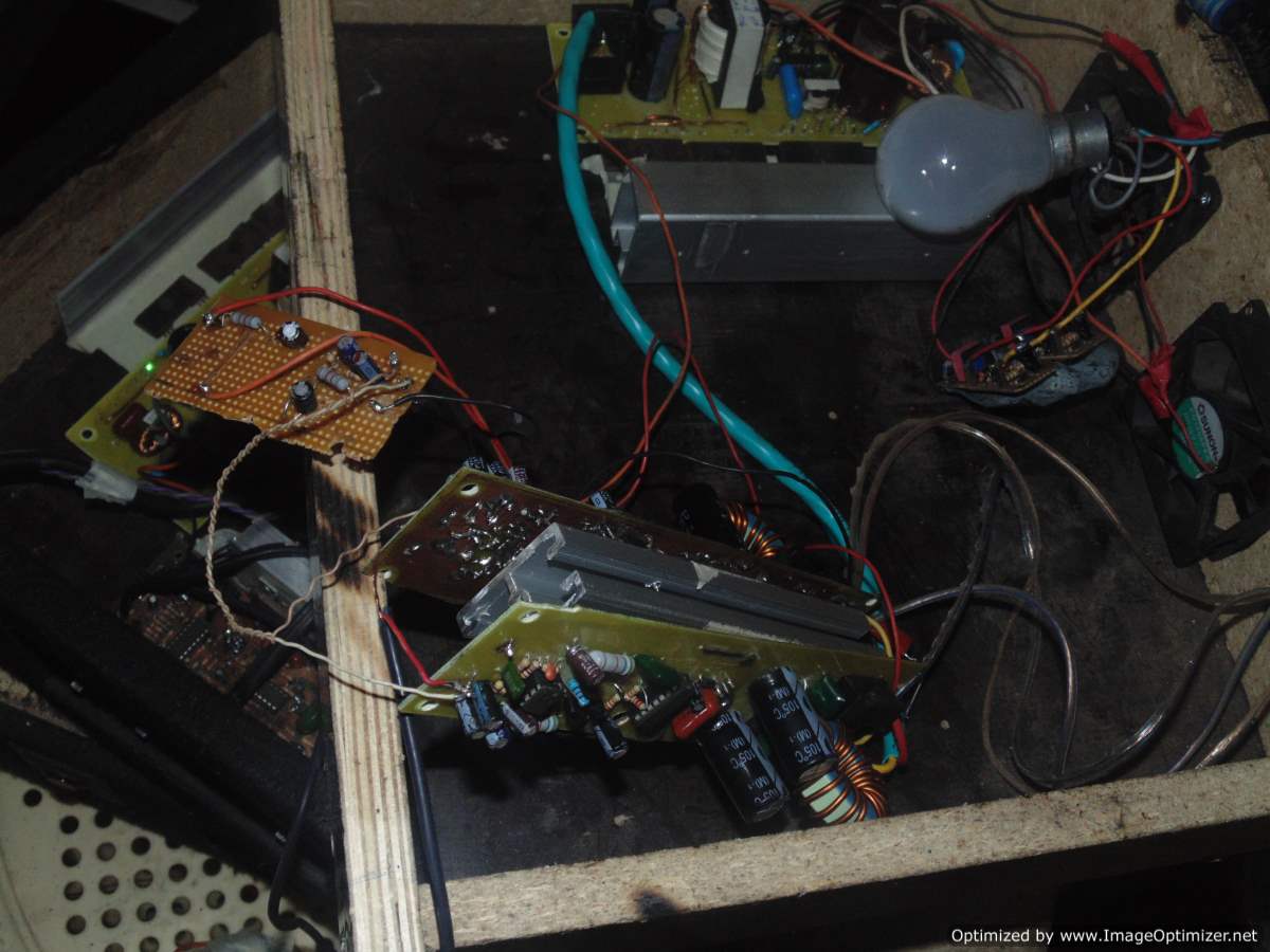

my latest project with ucd class d amp in bridge mode . xoc1 your cabinet rocs
