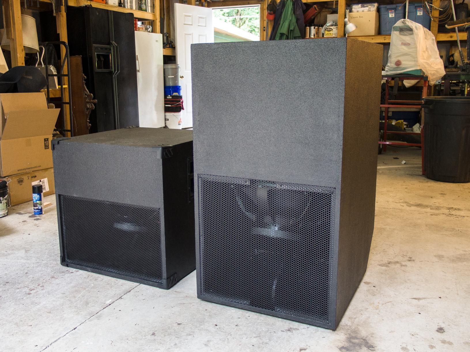

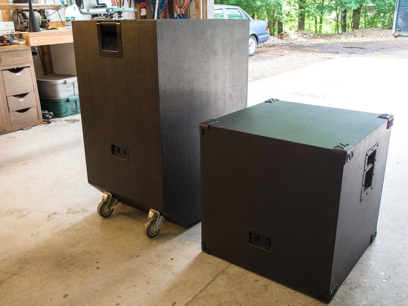

Finished my builds over the weekend (the smaller box is a Cubo 15). 😀
This was actually my first substantial woodworking project (I had some coaching from my dad-in-law), and I learned a ton. Using a Wixey digital protractor for the weird angled cuts was a lifesaver -- all of the pieces ended up fitting together amazingly well.

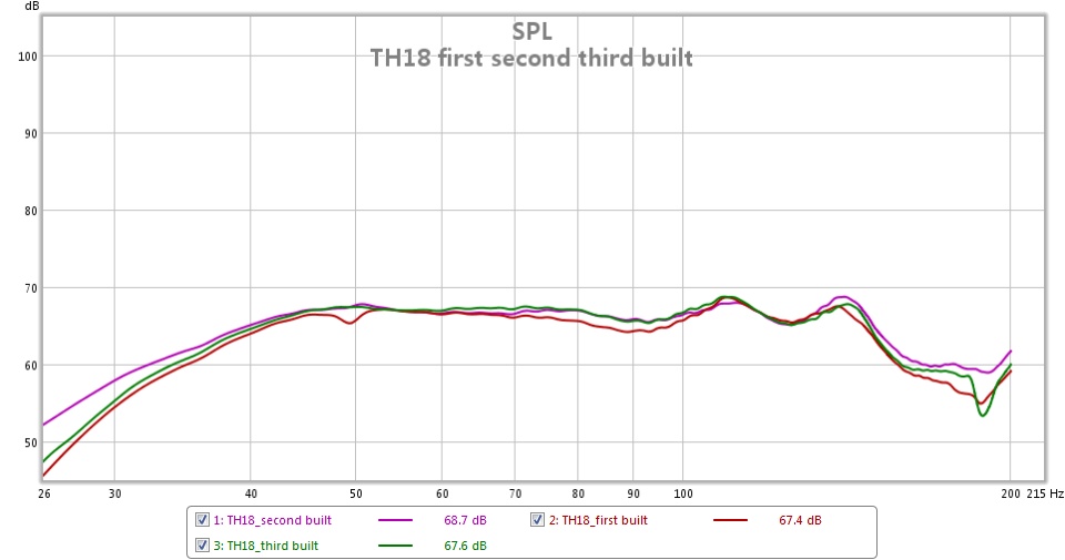

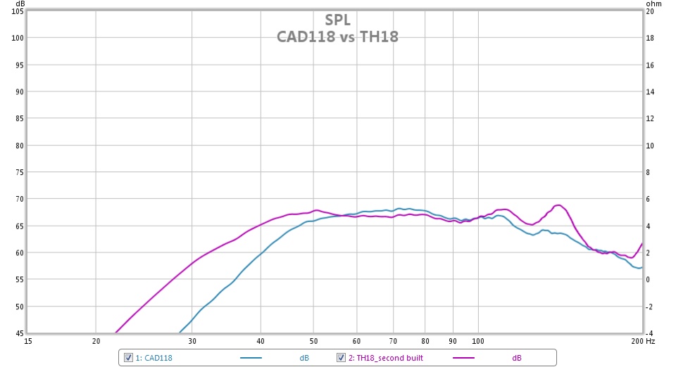

My first REW measurements
I finally managed to get some initial measurements done, but be aware that the results comes with a solid disclaimer since I am a true novice with REW and measurements in general.
Having said that, I hope you will comment on these initial results.
My setup:
Measurements takent of my first three built TH-18. The first built got a little of, which maybe explains the difference in the output.
Mike is a DBXRTA with a calibration file I found via google and running thru a calibrated external soundcard. Output from the soundcard feeded into a mixer and via DBX PA into the amps:

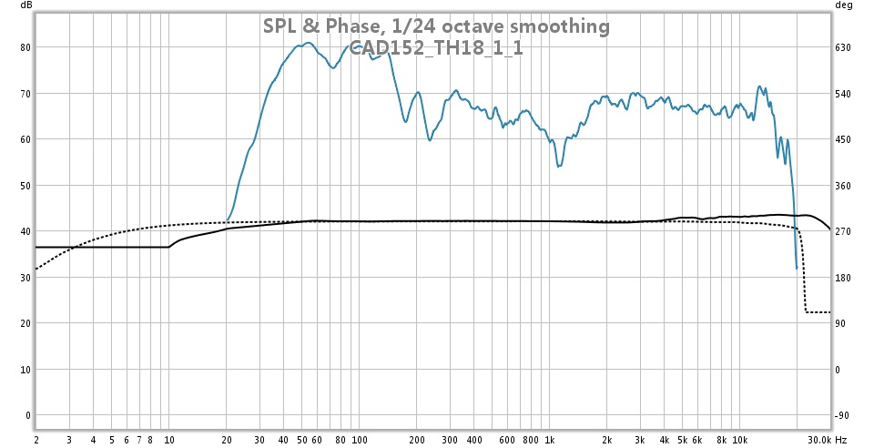

I measured my old CAD118 18" subs and compared with the TH18 here:
I wonder why the output is not higher on the TH18 compared to the old ported subs, but maybe the type of measurement will not show that?
And the TH18 is with cone correction from Djim 🙂
I still need to make some comparing with different conecorrection and Xmax.
My setup:

Hi Andy
How are you measuring the input voltage to the speaker and the actual output volume?
Also you mic looks very comfortable on its plush red cushion but I have no idea what this does to its response compared to using a mic stand!🙂
Regards Martin (Xoc1)
Hi Martin,
Haha.. I didn't think it would make a difference with those frequencies.
I have not yet found a suitable SPL meter to go with REW and therefore the measurements I did was purely for frequency. I was hoping to get phase, but it didn't come out right.
If anyone can recommend a SPL meter for REW, here in Europe please come forward.

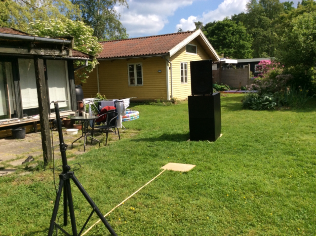

I made another set of measurements with a top (15+2) 4 meters and the mic on a stand appr. 1.5 m above ground. The sub is too loud and I am working hard to find out why I have a dip in 1khz.
The scenery :0)
The setup is Low= Highpass 30hz/24db Lowpass 100hz/12db. Mid=Highpass 100hz/12db Lowpass 1.4kz/24db. High = Highpass 1.4kz/24db. No EQ.
The REW graph:
Regards, Andy
The scenery :0)

Try repeating measurements with each channel on independently and show plot with all three and total. If dip at 1.1khz goes away when tweeter is off it may be destructive interference between mid and high?
Haven't followed the thread, but when I see a dip like this at a common XO frequency, my first thought is the tweeter's leads need to be reversed, so is this an XO point?
GM
GM
Or maybe the delay isn't dialed in correctly - or could even be ground bounce. Does it go away if you lay some fibergalss batts on the ground between the mic and speaker?
Ground bounce is in the 100 to 250 Hz range so I think 1.1kHz is caused by something else. The dip at 240 Hz may be ground bounce. We won't know until each channel is swept independently.
