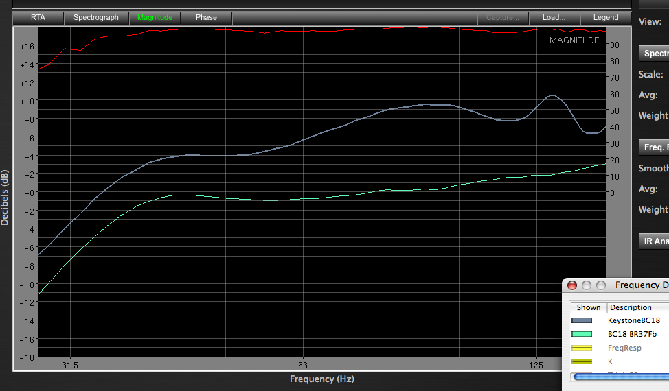

In my comparison of a BR cabinet loaded with a B&C 18SW115-4 using a large port, (7.25 x7.25 x 9.75 deep with a 13.25 diameter inside circle) which matched the Keystone TH’s LF corner pretty closely, I found that the BR lost LF relative to HF in the high power (77.5 volt) sine wave tests compared to the pink noise Magnitude Response tests done at several watts, probably due to port compression.
At 40 Hz, the Keystone is +9 over the BR using sine wave, but only 5 dB difference at lower power pink noise, a 4 dB loss due to port compression.
Conversely, at 100 Hz, the sine wave test has the BR only 3.4 dB less than the Keystone, while the low power pink noise is +8.5 dB, the Keystone “flattens out” in the upper range by 5.1 dB at high power.
It could be argued that the BR port compression allows the cabinet to sound more punchy at full tilt boogie, as our ears need less bass at loud volumes to perceive it as equal in level compared to at low level.
One certainty in TH usage is that there is far more stress on the cone when reaching Xmax compared to a BR, lighter cones such as the Eminence 4015Lf (or even lighter 3015LF) that work fine in a BR tend to fold up, distort, and put out less than predicted when loaded in a TH at power levels capable of reaching Xmax.
