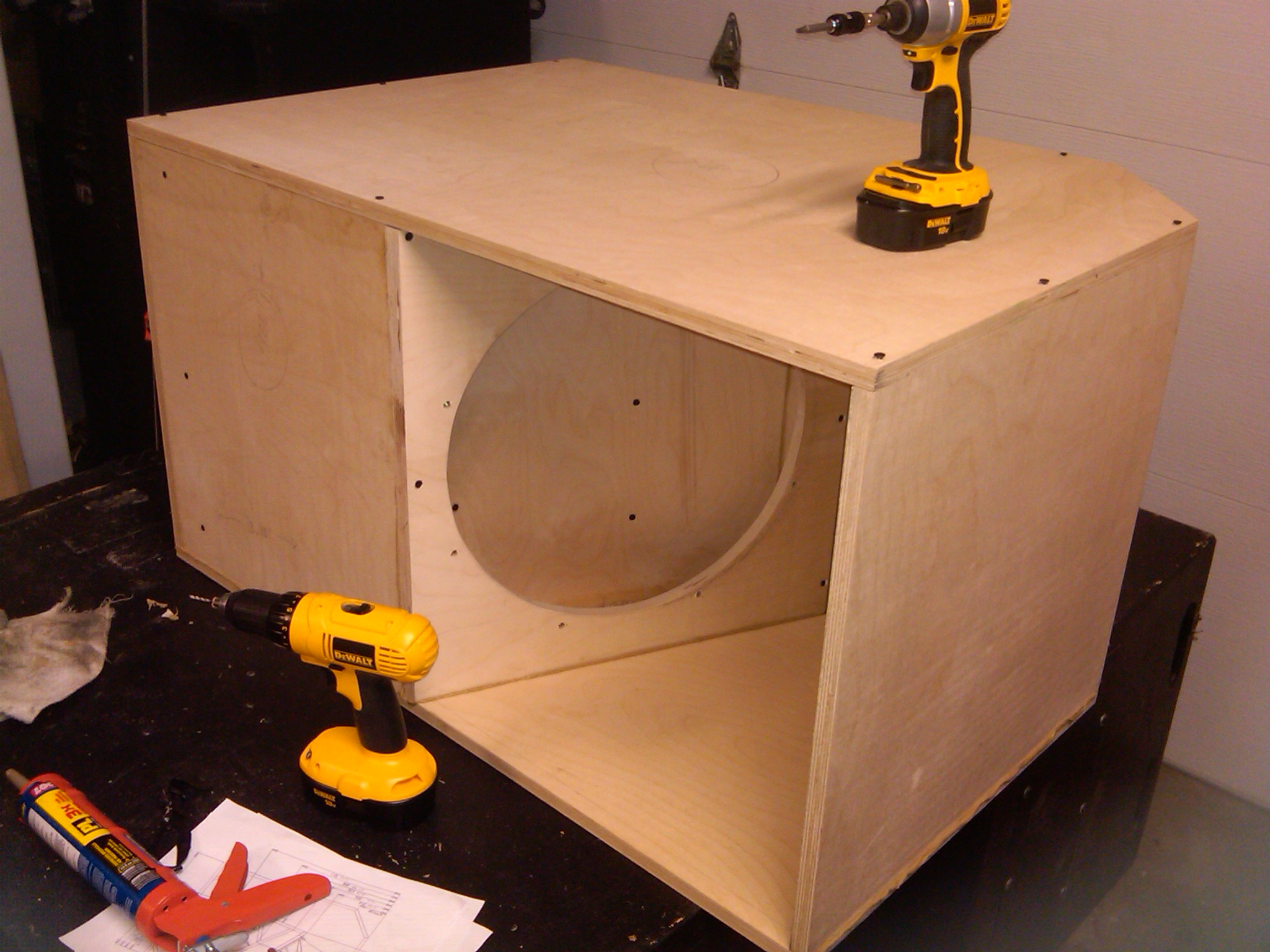

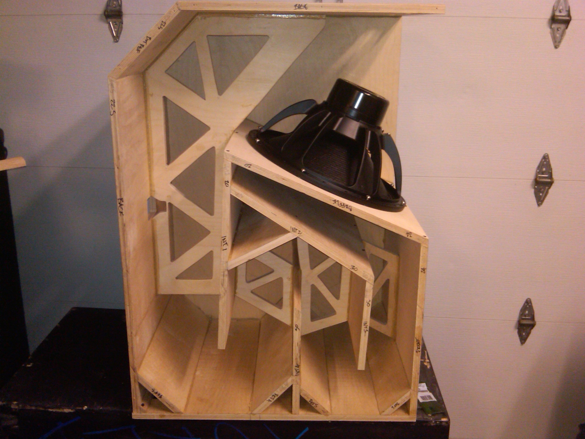

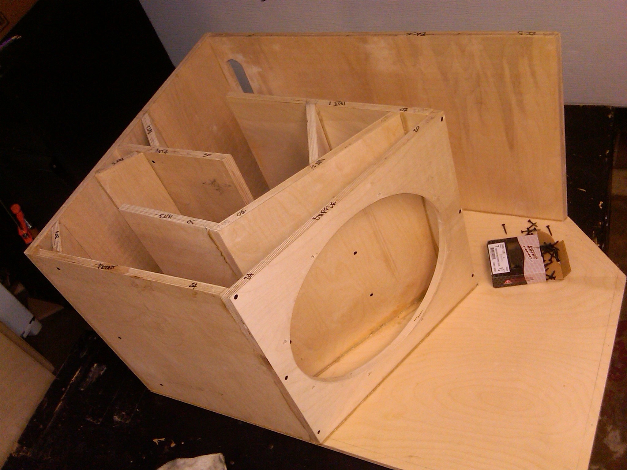

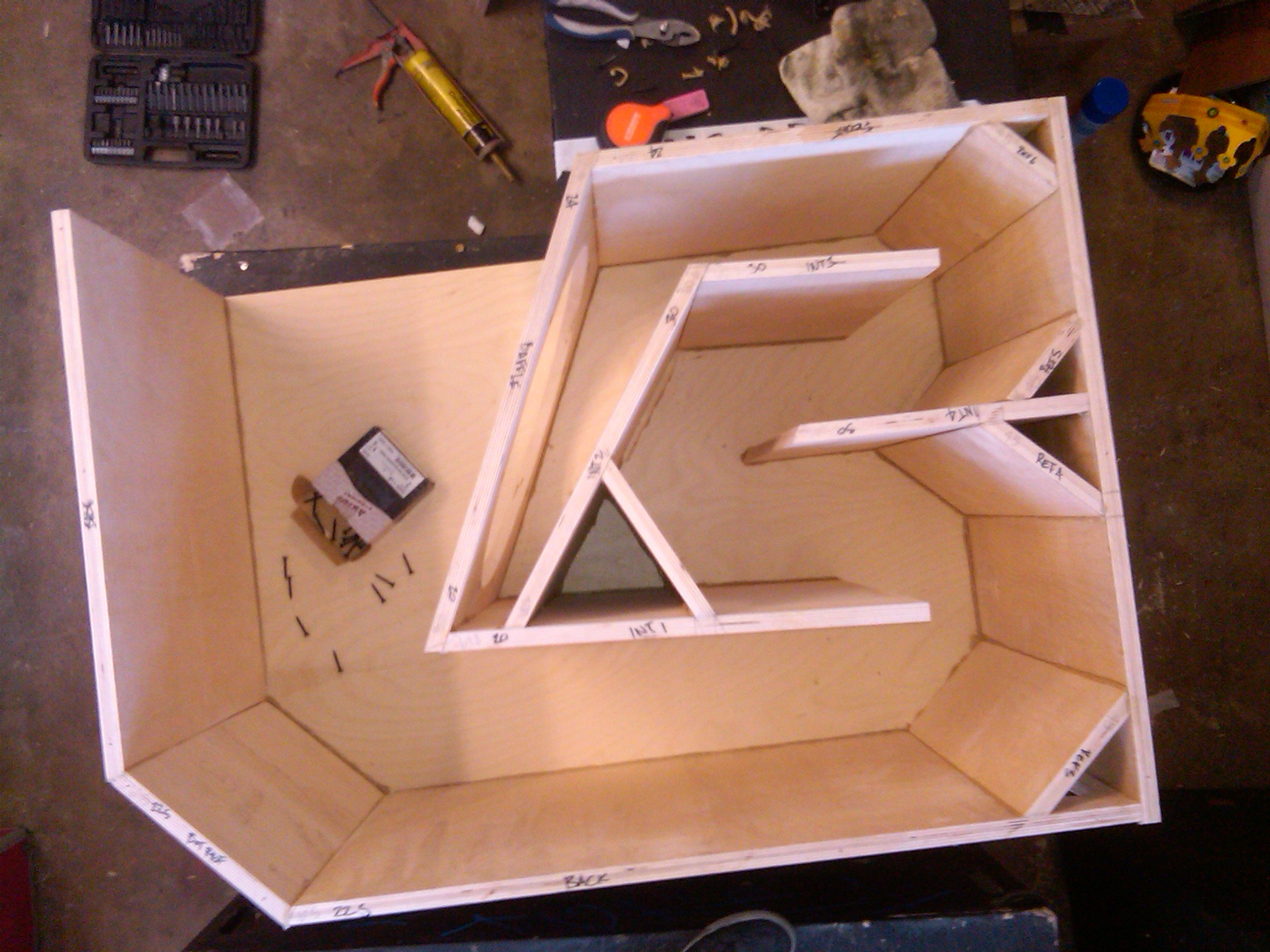

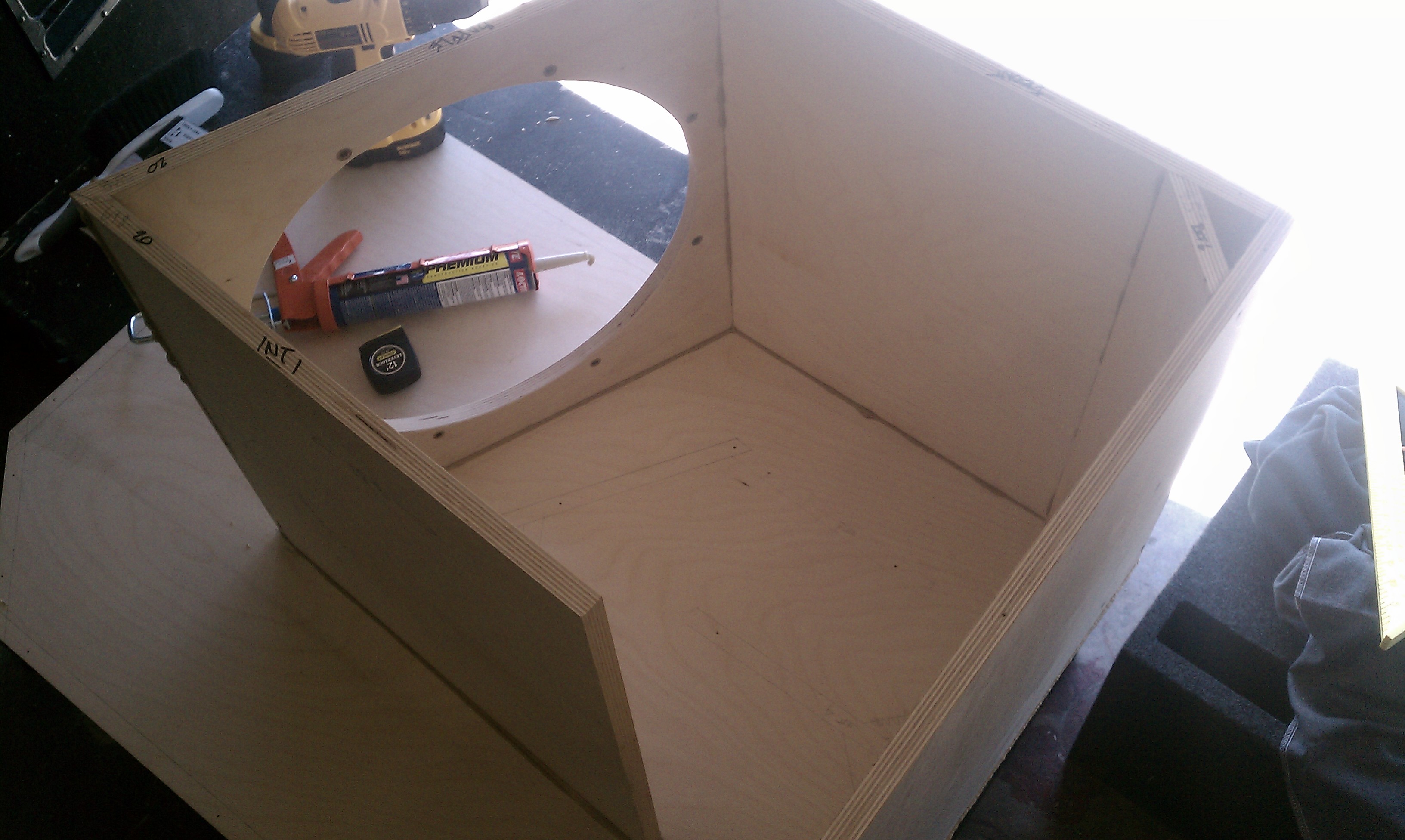

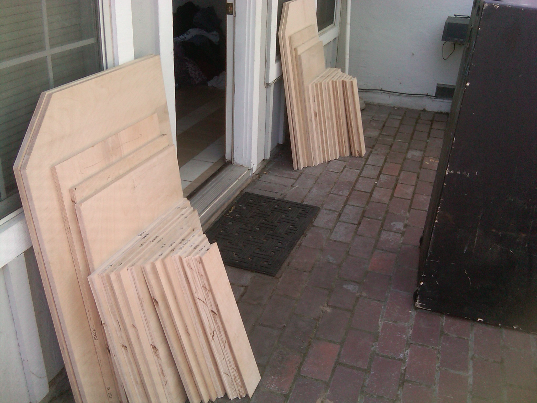

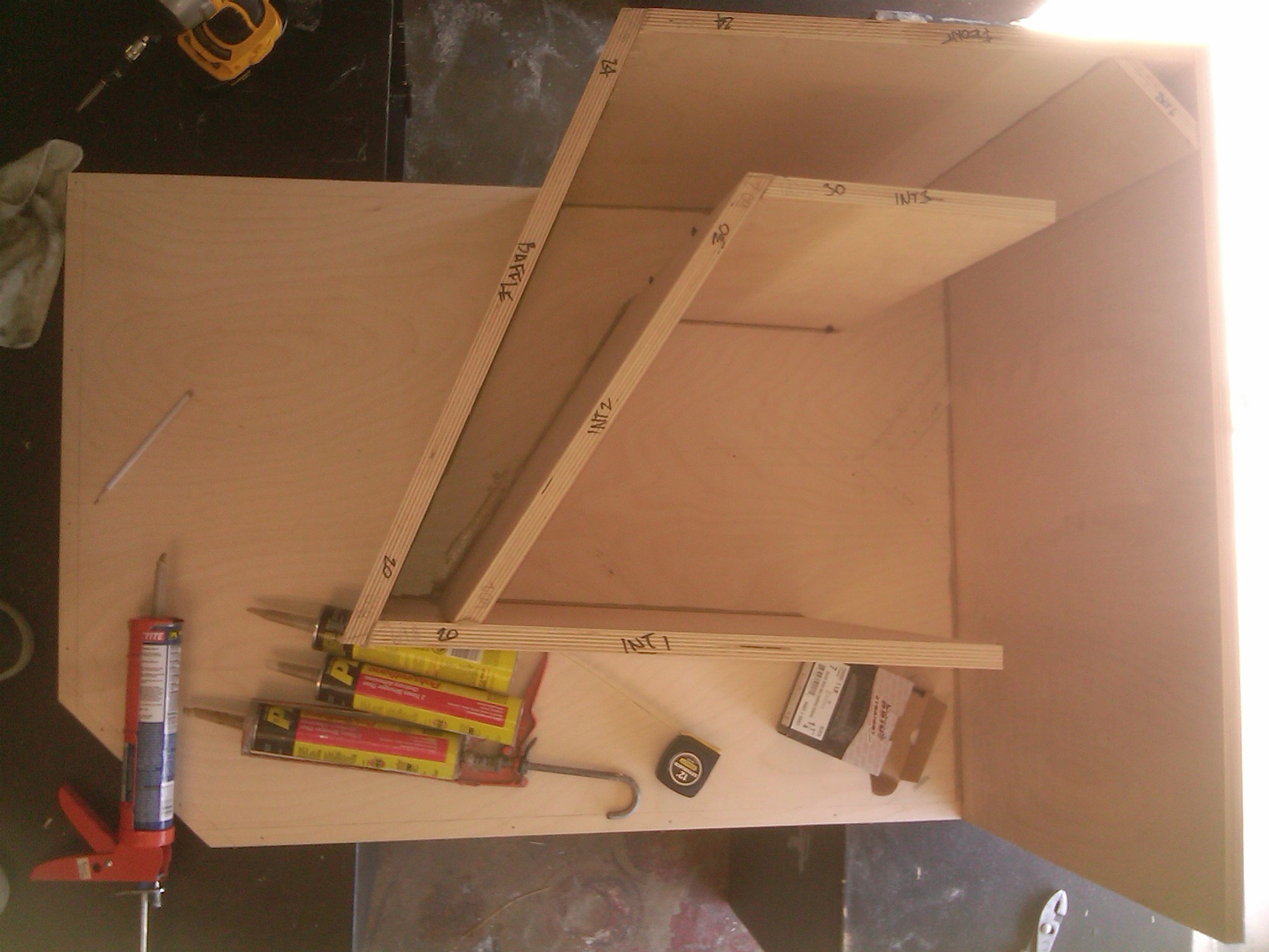

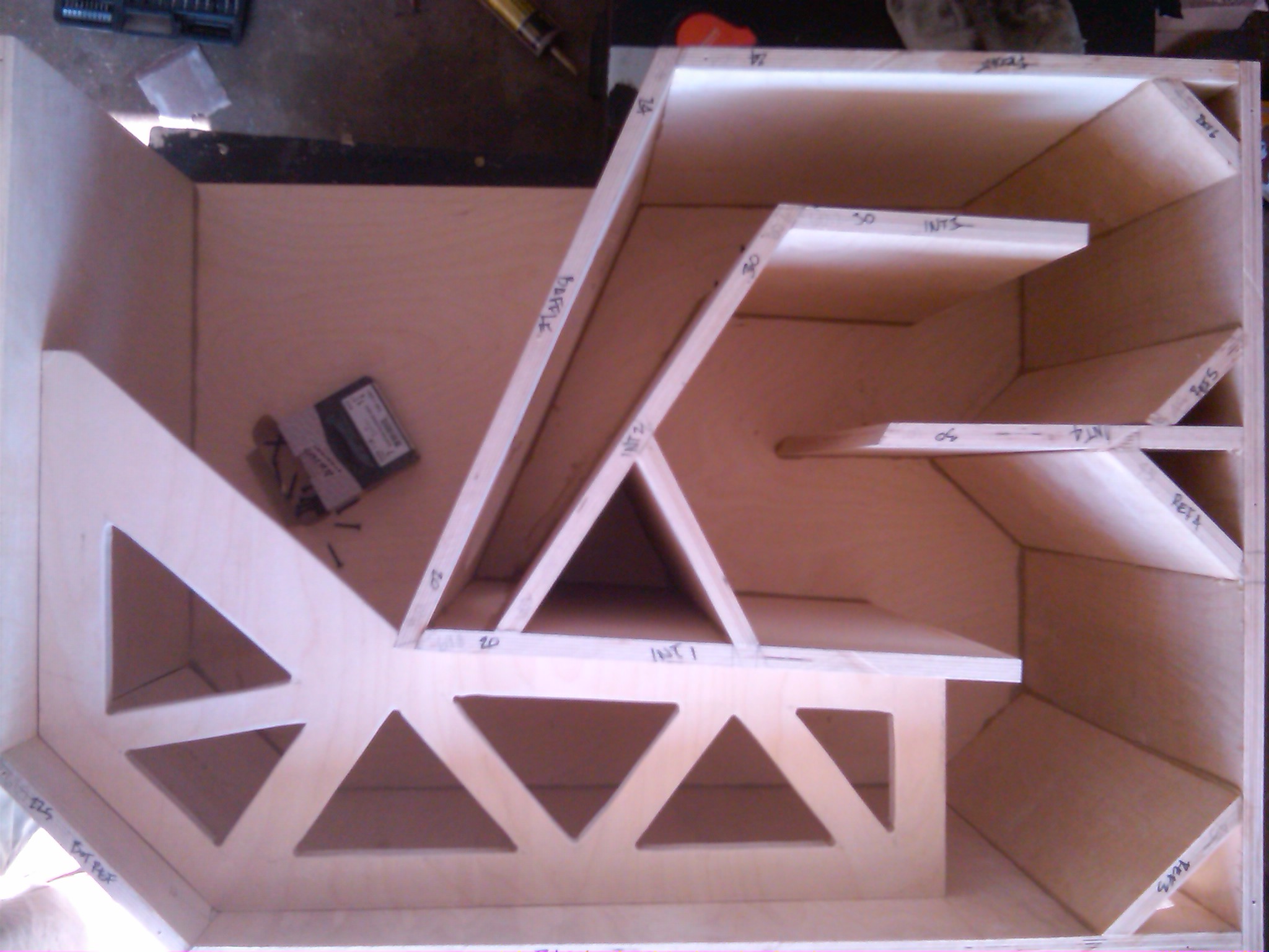

Realized I haven't posted pictures of my TH-18s I've been using for a few months now. I went with the B&C 18SW100 (neo version of the 18TBW100). I used 3/4" baltic birch. My sound partner helped me up through the 3rd picture (1st cab) and I completed the remaining duties, including the 2nd cab. I also added cone make-up/correction (I'll post measurement comparisons later) and a decent sized broomstick brace with circular attachments. They are now finished with one coat of Duratex and are awaiting a few more coats. I also mounted some very nice (and affordable) casters with precision bearings and they ride very solidly and quietly. I cut handles and the back corner and bottom front. A pair of Speakon connectors are mounted on the back in the center. The driver is mounted with stainless bolts & washers and held snug in place with knife-thread inserts (thanks Don) mounted from the inside of the speaker baffle. Last, before mounting the last side, I filled the empty triangle with insulation (in the can) - this stuff is stickier than PL!
Special thanks go out to Xoc1, Djim, epa, jbell and plenty of others who have helped me throughout this journey. After building a couple folded horns and a couple SS15s, I can finally say I'm happy with the performance of my subs - the TH-18s. Since one TH-18 outperforms a pair of either of the other two and take up less space doing it, the SS15s will be for backup and folded horns will be up for sale.
On to the photos:
On to the photos:

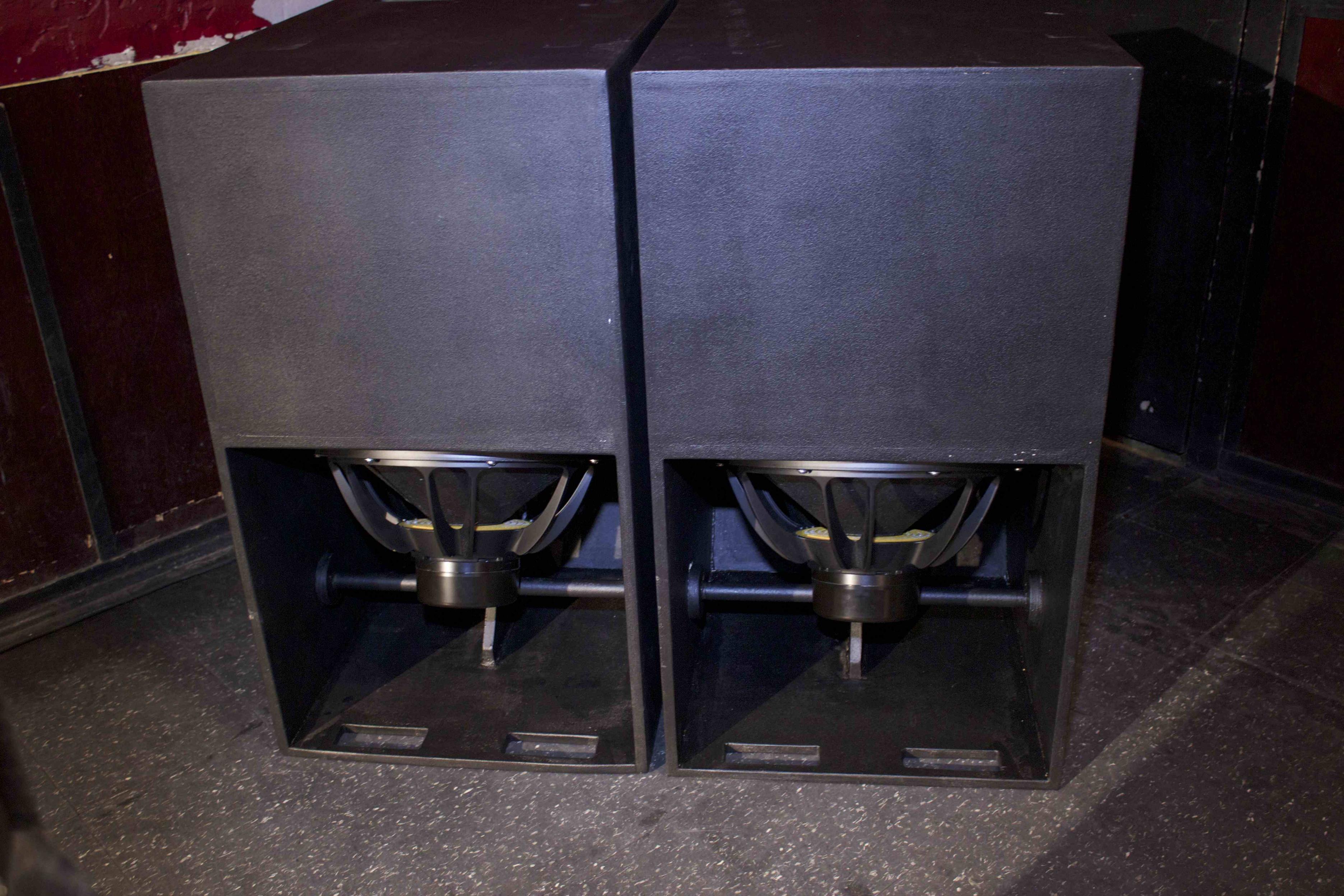

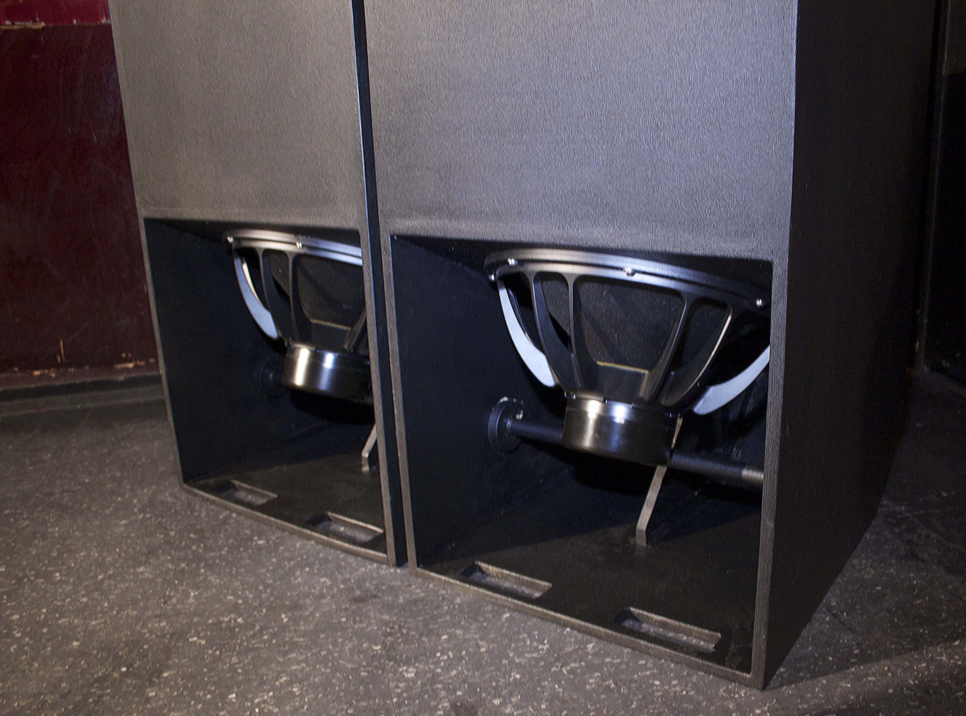

Thanks gents! I really did put actual blood, a lot of sweat & some tears into these cabs. Many many hours and it was all worth it.

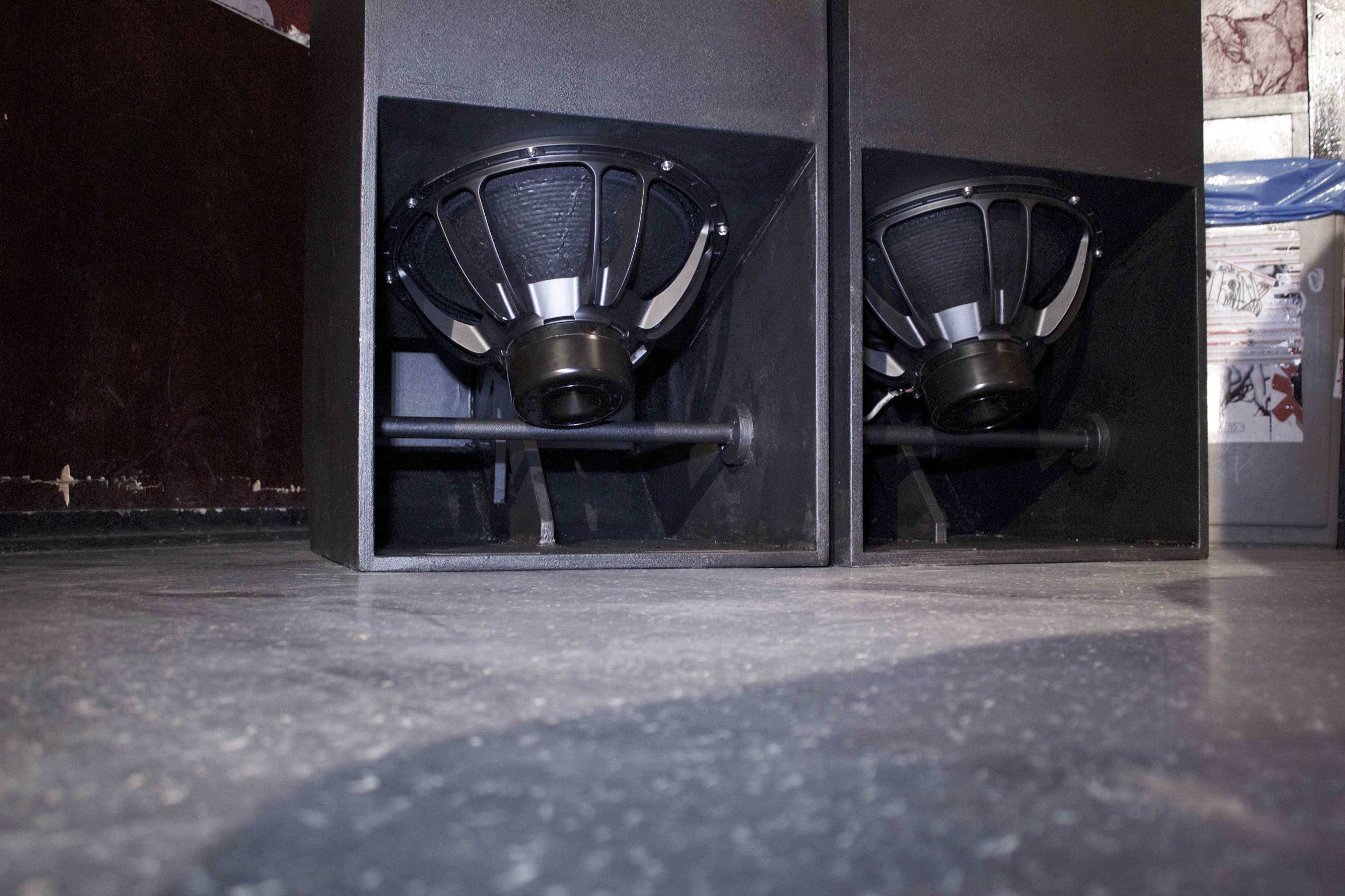

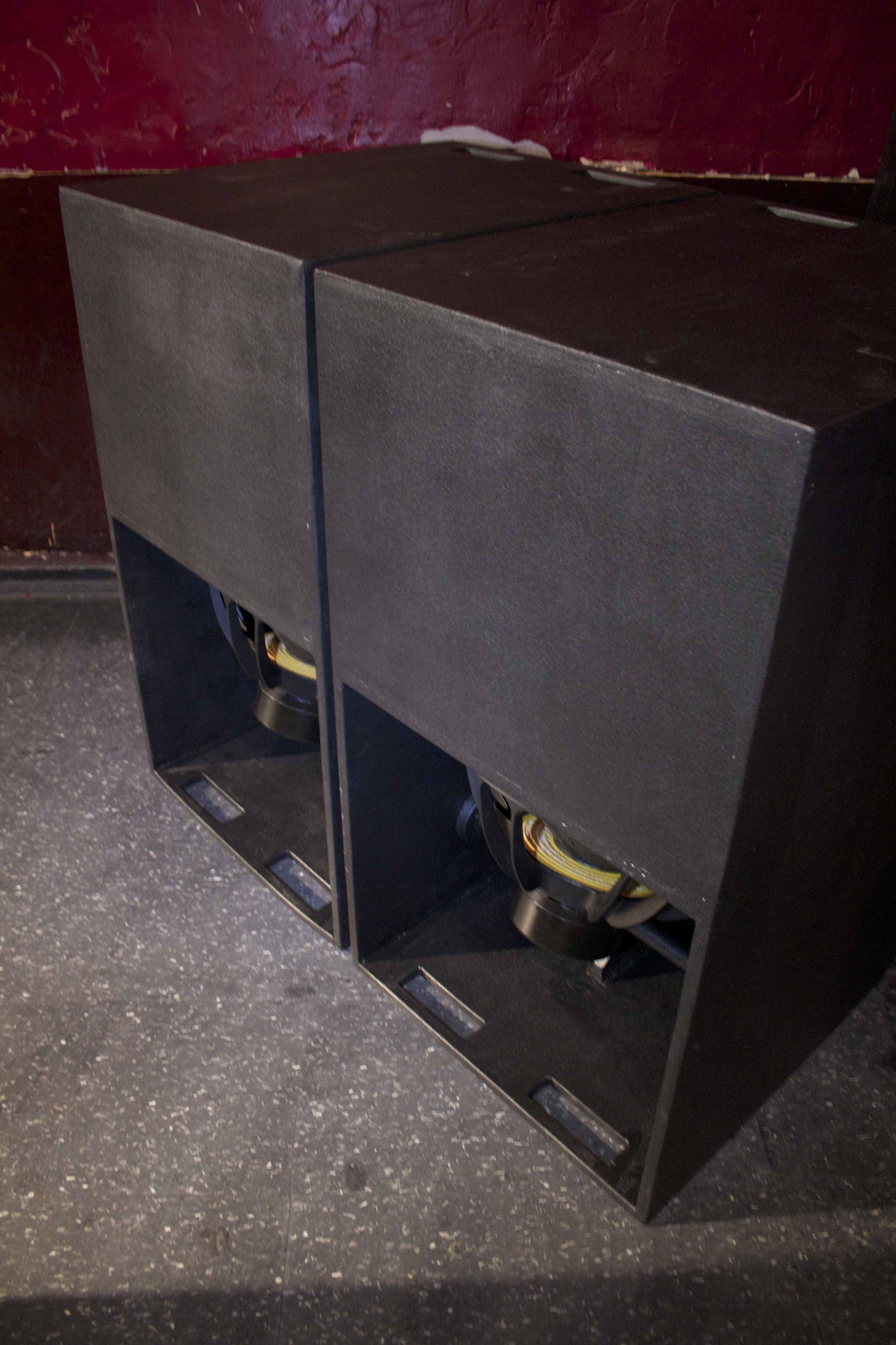

Here are some pictures of textured (one coat so far), loaded and broomstick-braced cabs. They now have Dayton square hole grills.
Looking good man.
When are you dragging these out to do some REW measurements?

Very nice build!!
