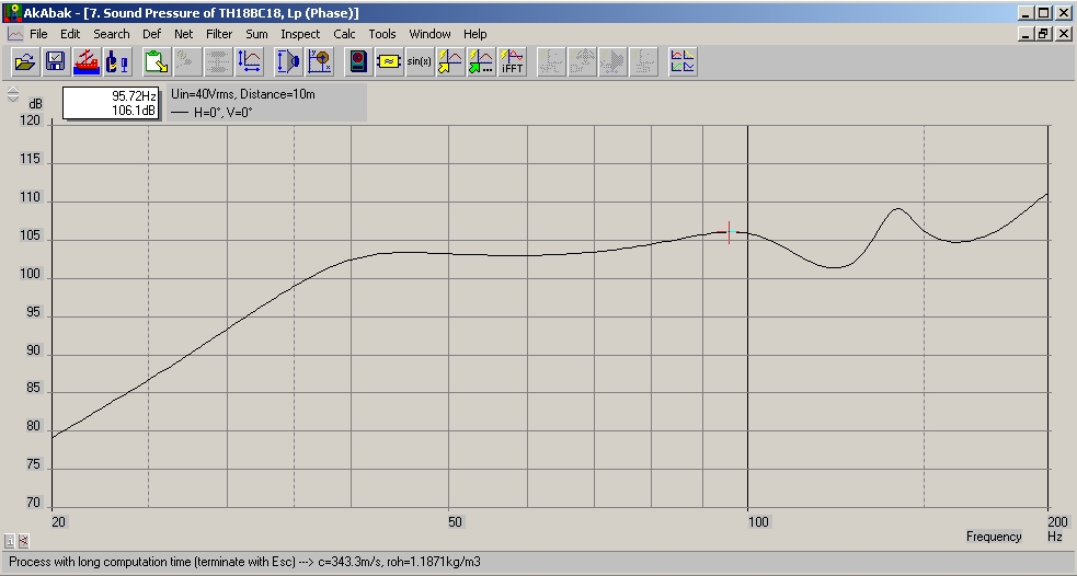

One would have to measure the two subs side by side to get an accurate comparison.how would one compare this th 18 to the danley th-118 in output
Since internally and externally the Xoc1’s TH-18 is very similar to the DSL TH-118 (which presently uses the BC18SW115-4, previously the 18 Sound NLW9600-4) using the same speaker they should be very close in level, but Danley’s sensitivity graphs seem to be higher than Hornresp predicts.
There are a some comparative measurements in sub shootouts and Josh Ricci’s Data Bass website that also seem to indicate the DSL sub measurements may be high.
I have had discussions with Ivan Beaver and Tom Danley of DSL regarding the disparities, but short of some side by side measurements (which Ivan has been too busy to do) of DSL subs compared to other manufacturer’s subs that have published charts, the issue remains unresolved.
Art Welter
The Danley TH118 SPL chart is for 28.3 V @ 10Metres with a 4 Ohm Driver. The equivalent measurement would be 40V @ 10 metres for a 8 Ohm TH18.
Even so the TH18 equivalent sim seems way off Danleys published TH118 - figures being between 3 to 5 dB lower.
Of course the only build that we have so far is mRgSr's, and no real measurement data to go on yet
Thanks for the positive comments, but I will feel a bit easier about them, when we have some real world data to base them on!

(Sim is Xoc1 TH18 - B&C 18SW115 8 ohm 40V @ 10Metres)
Danley's 'sensitivity' specs come from a peak at 90Hz and at 138Hz (higher than my crossover frequency). But, yes, from 20-100Hz, the Danley TH-118 provides more output......and costs 4-5 times as much
As far as my eyes can see:
.......... 30Hz.... 35Hz.... 40Hz.... 45Hz.... 50Hz..... .60Hz.... 70Hz..... .80Hz..... .90Hz.... 100Hz
Danley 101dB .. 104dB .. 105dB .. 106dB .. 107.5dB.. 108dB ..108.5dB .. 108.5dB .. 109dB .. 107.5dB
Xoc1 ...93.5dB . 99dB .. 102.5dB. 103.5dB .103.5dB ..103dB ..103.5dB .. 104.5dB .. 106dB .. 106dB
Yes, my Danley # at 90Hz reads 109dB - not 108dB like on his spec sheet. Again, this is what my eyes see on his response chart. His plot, 114dB @ 138Hz, looks it - so, I feel that what I see is accurate enough (within 1dB).
Hope this helps a little - no more toggling between tabs/pages/jpegs
