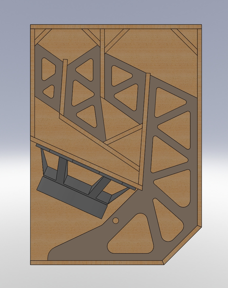

As outlined above the horn fold is set out and then adjusted in the CAD model to optimise it. In fact I have almost given up on modelling up a speaker from scratch in Hornresp. Instead I now prefer to lay out a basic sketch model of the horn, and unfolded speaker and adjust it to shape. The unfolded sketch is used to create a Hornresp Sim. The horn wizard is then utilised to see which way the shape of the horn can be modified to improve the performance. The modified sim can then be used to help reshape the fold.
The CAD model can be easily copied and modified, so once a folding scheme is set out the work can be reused for another speaker design.
The original design omitted 3 of the internal reflectors.
These were added at Djims suggestion. The addition of the 3 reflectors shortened the path length slightly. The reflector lengths are optimised, but the overall folding was left as the original. The largest error in the horn taper widths introduced by the extra reflectors was 0.8mm, so I left the fold as it was.
At this point it might be good to mention that I made an error in my previous drawings the exit mouth internal dimension is 508 not 526. (Adjust S4 from 2814.1 to 2717.8)
Fortunately the effect on the sim is very minimal.

Did you add any bracing or reflectors not shown in your CAD model?

Extra bracing which Djim suggested...
QUOTE]
I had a bit of a play around with the bracing scheme today and this is the result
Regards
Martin
