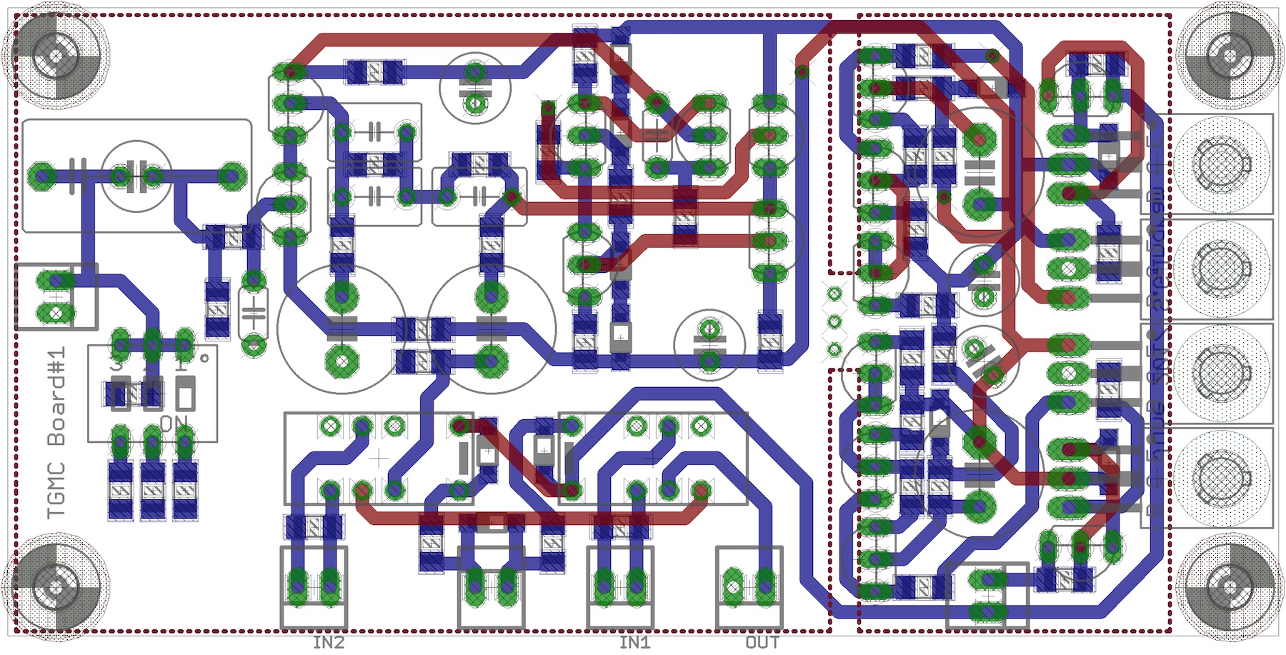

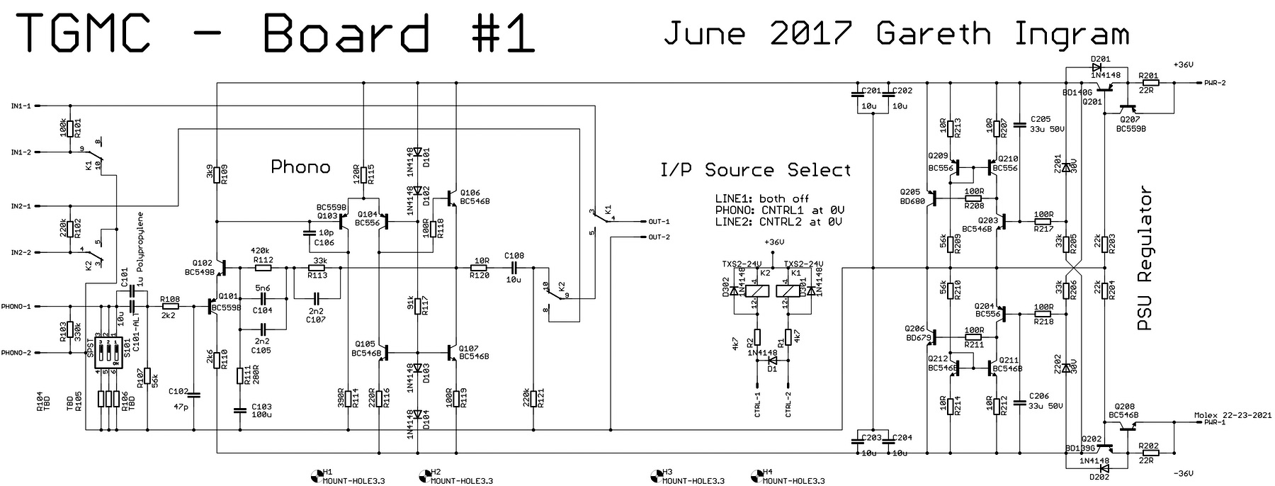

As far as local supply rail decoupling is concerned I see only one on the RIAA stage C3 at 100n and none at all on the buffer board.
If you want to short some supply line rubbish away from sensitive circuit input points - you would install them where there is a short distance between such and the decoupling capacitor. You can use a modern electrolytic for this - said Guido Tent an EMC engineer at Phillips 20 years ago.
From post 255 - you should have researched this at the time in which case you would not be raising so many probing questions about the detail now.
I went back to your post255 and the preceding post from Bigun said this:
especially this sentence:Maybe my simulations are flawed somewhere but I'm not seeing any issue with PSRR for the shunt+phono combination. No need to add complexity. However, my criteria, admittedly a quick-think suggestion, isn't about channel separation.
It's about keeping voltage drop from signal currents off the power rails and keeping them inside the amplifier.
Stability does require care and simple capacitance on the rails addresses it easily but of course output impedance increases with frequency but not to an extent that it's no longer attractive.

Aluminum electrolytics have a self-resonant frequency, like all other caps, but resonance looks more like a big, broad, non-resonant trough in its Z vs. F curve. IIRC, some 470µF 35V caps with cans around 7 x 15mm have self resonant frequencies around 400kHz - 600kHz, and caps with smaller cans will have SRFs around 1MHz or 2 - it's usually more of a function of the physical size of the cap, and less related to the capacitance value or voltage rating.
Thanks Monte - have used a pair of smaller sized caps per rail.
Has anyone used this? I am told it works better than Easy PC and Eagle.

I now see R114 connects to earth which corrects an error in an earlier .asc file.
I missed seeing this before others may have too.

I chose Eagle initially because I use an iMac at home and Eagle has a freeware version. After becoming familiar with Eagle I'm lazy to change - and most choices would mean using a PC. I have a PC laptop somewhere but it's old. So I prefer to stick with Eagle simply because it works and is free. It's not the easiest to use if you need to customize parts. And the free version is limited in functionality which adds a couple of annoyances.
