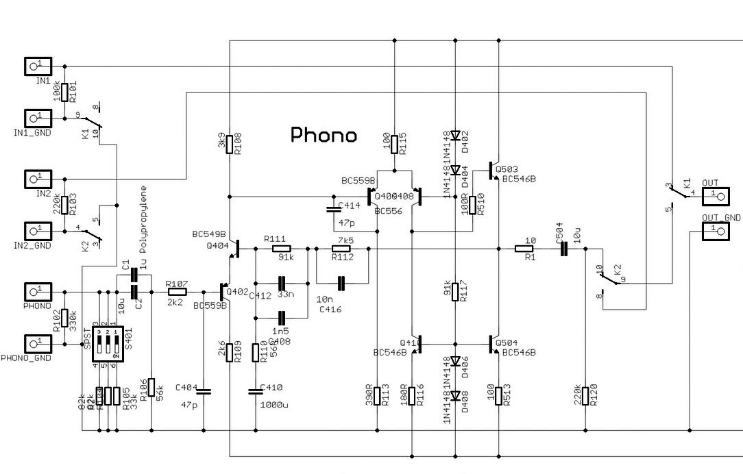

... slew rate limiting ... will manifest itself in the VBE of the output emitter follower Q503 ...
Duh, now I realize that in this topology, it will be a LOT easier just to monitor the emitter currents of the output stage pullup and pulldown, Q503 and Q504. If Q503's current ever falls below 10% of Q504's current, the circuit is obviously and unarguably slew rate limiting, HARD. Simple to plot and easy to judge by eyeball. Run it at 50 kHz with carefully chosen max-amplitude, per Bob Cordell.
At 50kHz with +/- 1.4V at the output we 'pass' this test. I can see that it would look less favourable at much higher swings. Is it a simple case of increasing the idle current through the output ?

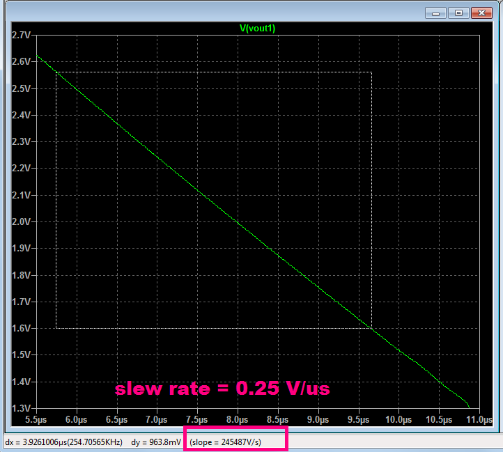

Slew rate = 0.25 volts per microsecond (!)
I think you've still got quite a ways to go yet.
For reference, the uA741 opamp chip's slew rate was 0.5 V/usec.
Part of your problem is the unfortunate choice of a ridiculously low bandwidth opamp in the inverse RIAA network. I recommend replacing it with either a 50 MHz opamp or a source follower running at healthy bias current.

For a simple analysis we don't need to include the inverse RIAA network at all. I can try that. But the basic phono amp - if the slew rate is traditionally limited by Cdom then we can calculate it using i/Cd. With, say, 300uA flowing through the input pair the max drive current into Cdom can be 300uA which gives a slew-rate of over 6V/us. I think I showed 47p in my diagrams, the original NAD actually used only 10p so I've made things worse with this part labeling and it's more like 30V/us.

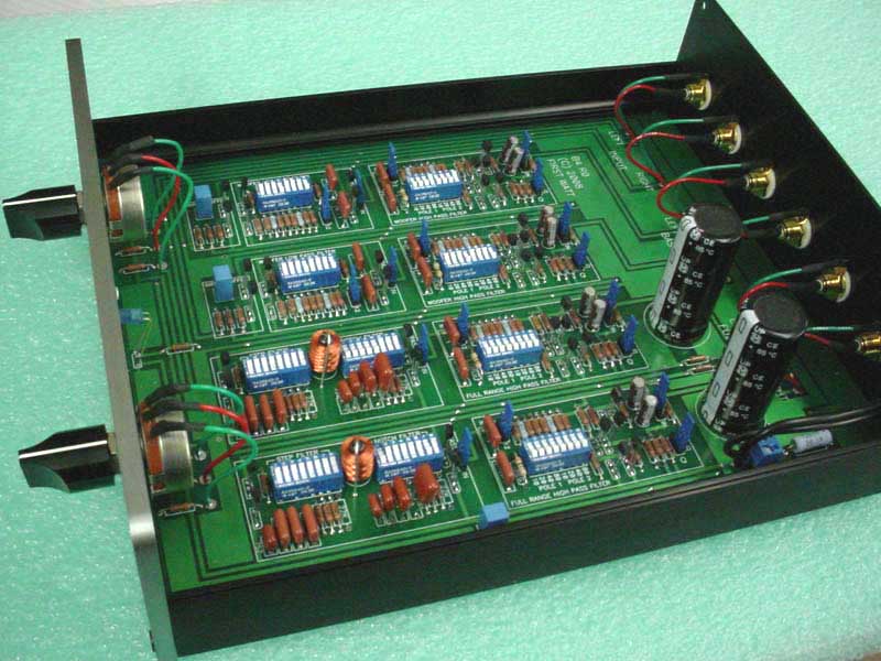

Board#3
Board#3 is the last board, after that I'm out of space in the chassis. For this board I'm considering a cross-over so that I can make some use of the various amplifiers I have to bi-amp my speakers. The original idea I had was to make a pair of FAST speakers (this acronym escapes me, but it's a full range driver with supporting woofer) where the XO will be around 300Hz. With some flexibility I would be interested to try bi-amping my current floor-standing speakers which are the more traditional mid-woof and tweeter with a 2kHz XO. Nelson Pass 'B4' active XO is a potential role-model for this idea. Passive switch-selectable filters with simple buffers.
So at the end of it the box will have input & phono (#1), tone & line-out (#2), line-level cross-over (#3).

I think you'll find that the base and emitter of output pullup Q503, move in phase with each other. They either both rise or they both fall.
During the worst-case, ugliest slew event, they both fall. The collectors of both current sink transistors (Q410 & Q504) both fall. Thus the collector-base capacitances of Q410+Q504, tug down the base node when the collectors fall. And boy howdy is this just what you DO NOT WANT! Exactly when you want the current sinks to really sink some current, their VBE is reduced by capacitive coupling. In one simulation I ran, the "constant current source" transistors' collector current, fell by a factor of 3X during slewing. Ouch!
Douglas Self's APAD6 discusses this in Chapter 15, under the heading "Slewing Limitations In Real Life". Regrettably, Self's suggested fixup requires a change to your PCB layout. Self shows his repair method in Fig 15.7, but it is rather invasive surgery, replacing (2 diodes) with (1 BJT + 1 resistor + 1 capacitor). Other fixes may require less radical surgery. You can try out various ideas in LTSPICE as they pop into your head, to determine which is the least horrifying to your own personal sensibilities.
Jim Solomon's equation "SlewRate = dV/dt = Ibias/Cdom" is completely inapplicable here, because the Rush Cascode does not have a constant tail current you can call "Ibias". During slewing, the current available to charge or discharge the "compensation capacitor" is wildly non-constant. Furthermore, because there is no current mirror, slew rate is different for the rising edge than for the falling edge.

Slewing happens when a transistor turns completely off.
In the Solomon / conventional LTP circuit, one of the two transistors in the LTP turns completely off, and 100% of the LTP tail current is steered (via the current mirror) into the compensation capacitor. When a constant current charges a fixed capacitor, the slew rate dV/dt is equal to (Itail/C) -- the Solomon slew rate equation.
In this Rush Cascode circuit, the common base PNP transistor Q408 turns completely off during worst case slewing (downward), because its base is fixed at (2 diodes below +Rail) but its emitter gets sharply yanked downward by Q406. Result: Emitter-to-Base voltage is reduced and Q408 turns completely off. The collector of Q408 falls like a rock, which immediately cuts off the output pullup Q503. Two of the seven transistors in the circuit, are completely cut off. Ouch! Not a prescription for distortion free amplification.

Q408 (NAD) is equivalent to your Q13.

It sounds like you now have a version which exhibits no slew rate anomalies at all. Congratulations!
I gently suggest you simulate it with input driven by a tall enough, fast enough sinewave to put the amplifier into obvious slewing, and then measure the slew rate itself: dV/dt. Who knows, you might have accidentally created a circuit that slews at 25 V/usec or even faster. Which would satisfy and delight even the ultra-feedback-nosebleeders like me, who insist upon no-slew, full power bandwidth > 200 kHz.
When sinewaves go in and triangle waves come out, yer slewing. Easy. Once you've got the thing to slew, go digging internally and you'll find at least one transistor is cut off. Honest.
