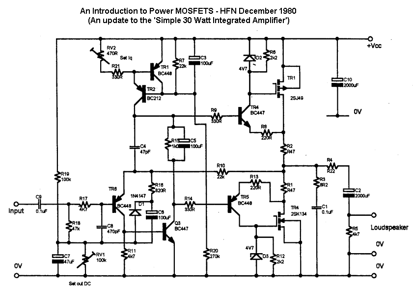

When powering the amp the necessary current to charge C3 has to be supplied by the input transistor, that s why on some old designs of this kind a resistance in serial with Q1 collector is added, it wont change the caracteristics at all and will protect this transistor, i had this transistor failing on such a Motorola design that was popular 40 years ago, 1k-2k should be high enough to limit said charging current to safe values.
When powering the amp the necessary current to charge C3 has to be supplied by the input transistor.
According to a power start-up simulation the majority of the current to charge the feedback shunt capacitor comes from the output of the amplifier through the series feedback resistor and a smaller amount from the input transistor.
I thought this was an interesting circuit, it reminds me of the TGM8. We have a Singleton input stage and a CFP output.

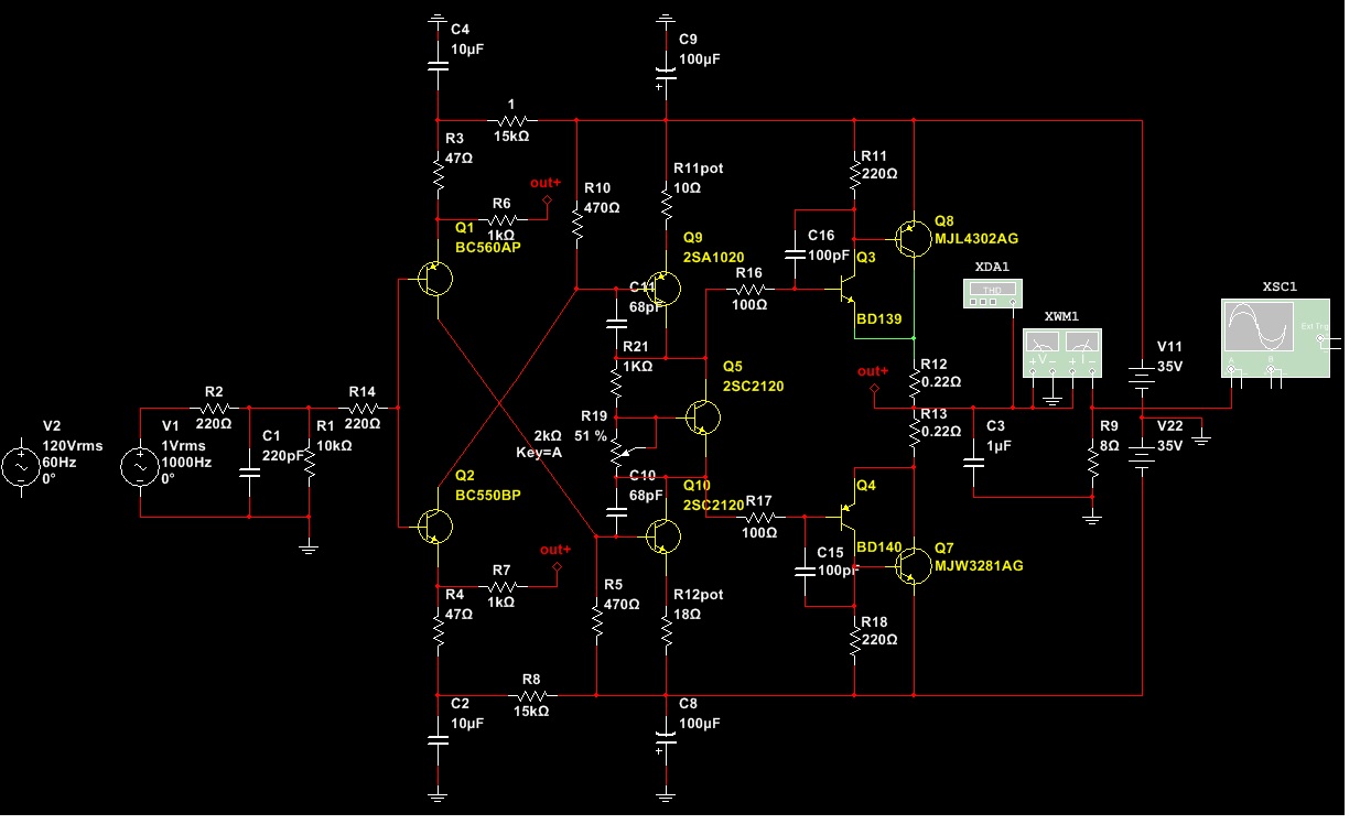

Hi everyone, Bigun, very interesting your circuit, I am in need of an amp DIY good quality, first I would do the P3A, but you came up with this variant, and soon after I saw the vssa, so I decided to do vssa, but it is so difficult to find Mosfets, so I started to move in tgm8 in SPICE, I wanted to make them a "symmetrical" (without bootstrip) when I finished I had a new variant or rather a fusion: P3A + tgm8 + vssa? I could put the scheme here, for you to tell me if it works correctly what do you think?
