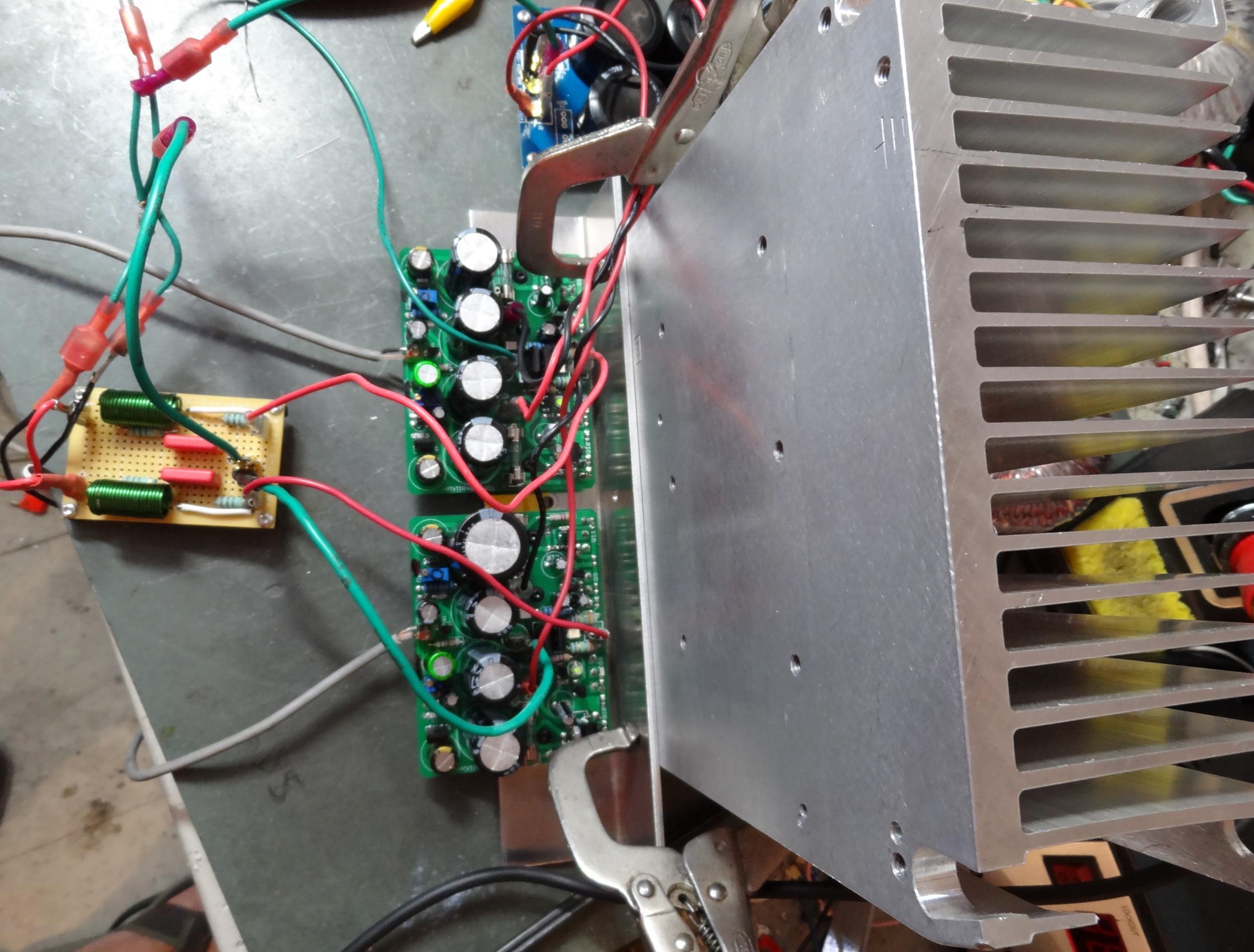

Hi Guys,
I finally got the boards populated. To my amazement, the first board fired up without issue. I was able to set the offset to zero and the bias control works properly. However, I haven't been able to find where it says what the bias should be set to. I have it set to 60mA per rail presently. If one of you could help with that I would appreciate it. The second channel fired up too but on that channel I have -1.2V offset so I have some searching to do. The offset pot has very little affect. Hopefully I will be able to track down the issue using the other channel as reference. Both channels will play sine and square waves. The sine waves look fine but the square waves have a little squiggle on the leading edge. Is that normal for this amp?
Thanks, Terry

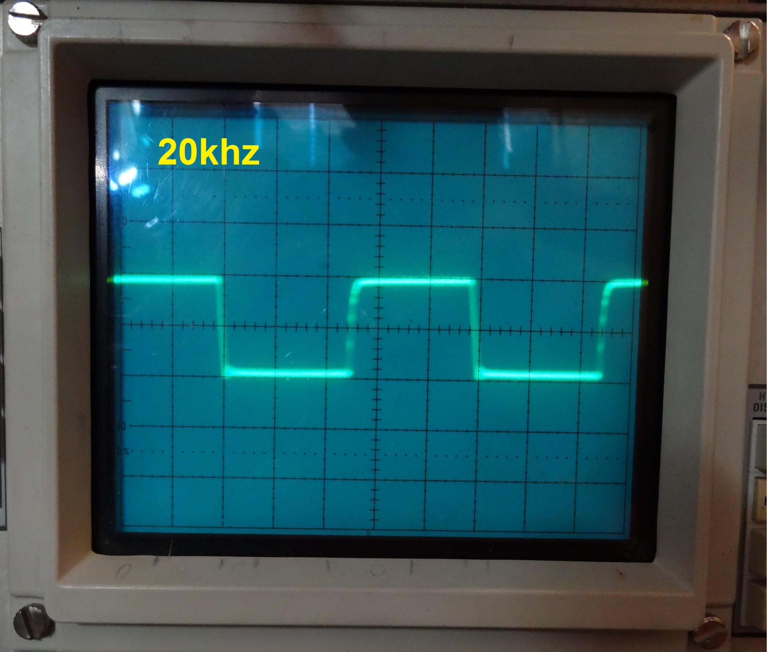

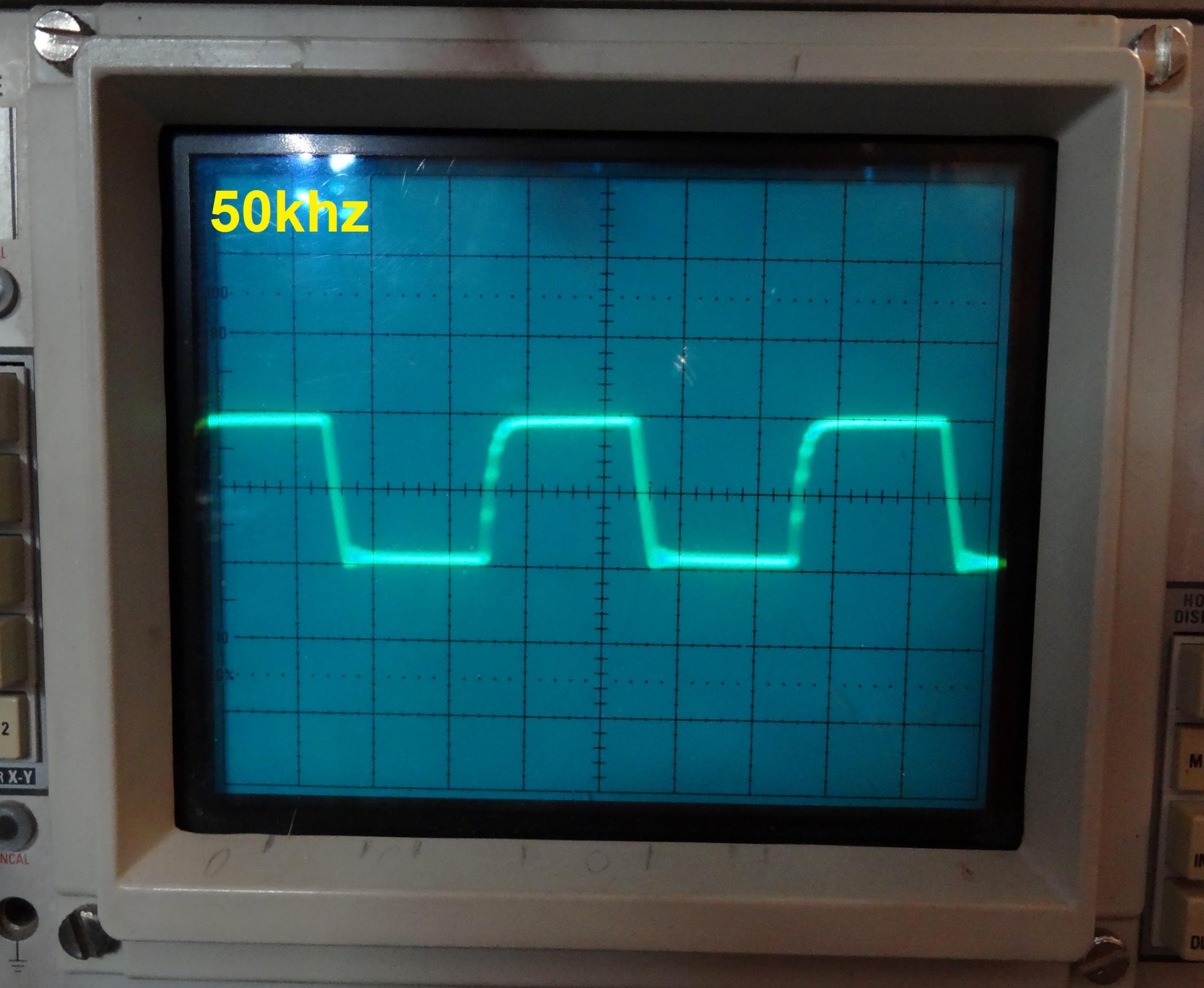

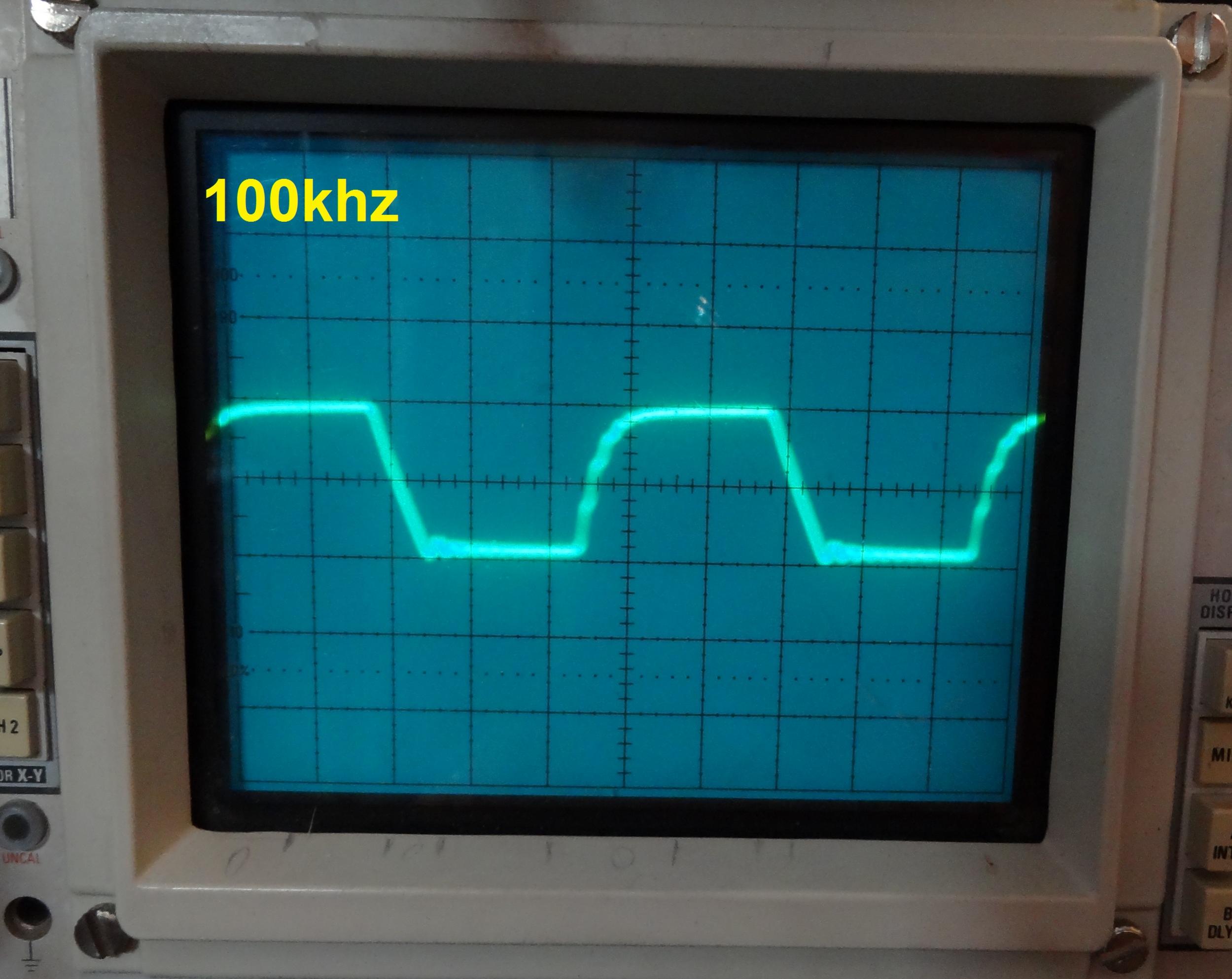

I will have to check my notes, but generally I don't use square waves at such high frequencies and haven't noted any 'squigles'. You do have a load connected ? Interesting that they are not the same shape at the bottom and top of each transition i.e. the behaviour is asymmetric. Perhaps the compensation I'm using is a little light. Have you played any music yet ?
I would point out that the CFP output stage is susceptible to cross-conduction because the minority charge carries are not easily swept out of the bases of the power devices. If you read back a few pages you'll find I did some investigations and increased current through the drivers. In simulations there should be less cross-conduction than would be normal for the original P3a but up above the audio range there will be some. Be careful not to let the outputs get too hot when running square waves at 100kHz if you have a load.
Hi Gareth,
Thanks for the info. The reason I have gotten into the habit of looking at square waves is they give a little more detail than sine waves. Almost every amp I have has normal looking sine waves. Almost all of them look a little different from one another when amplifying square waves. I learned my lesson about playing them at high volume. I normally set the output at 10Vac at 1k and leave it there. I haven't burned a zobel since I started that practice. That ripple is there even at 10K but just shows up as dashes. If you didn't play square waves through yours I guess you can't tell me if this is normal for this design of if I have something wrong.

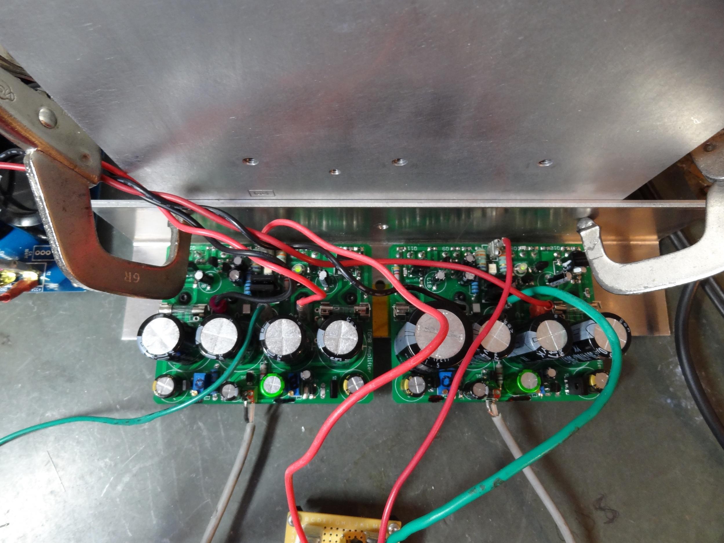

I found the issue with the offset on the other channel. I had D1 in backward. Unfortunately, when removing it I lost the little cap I had soldered in parallel. So, that channel still has issues. It plays distorted and though I can zero the offset, when playing the offset fluctuates a lot. I've got some more searching to do. The good channel sounds fine.

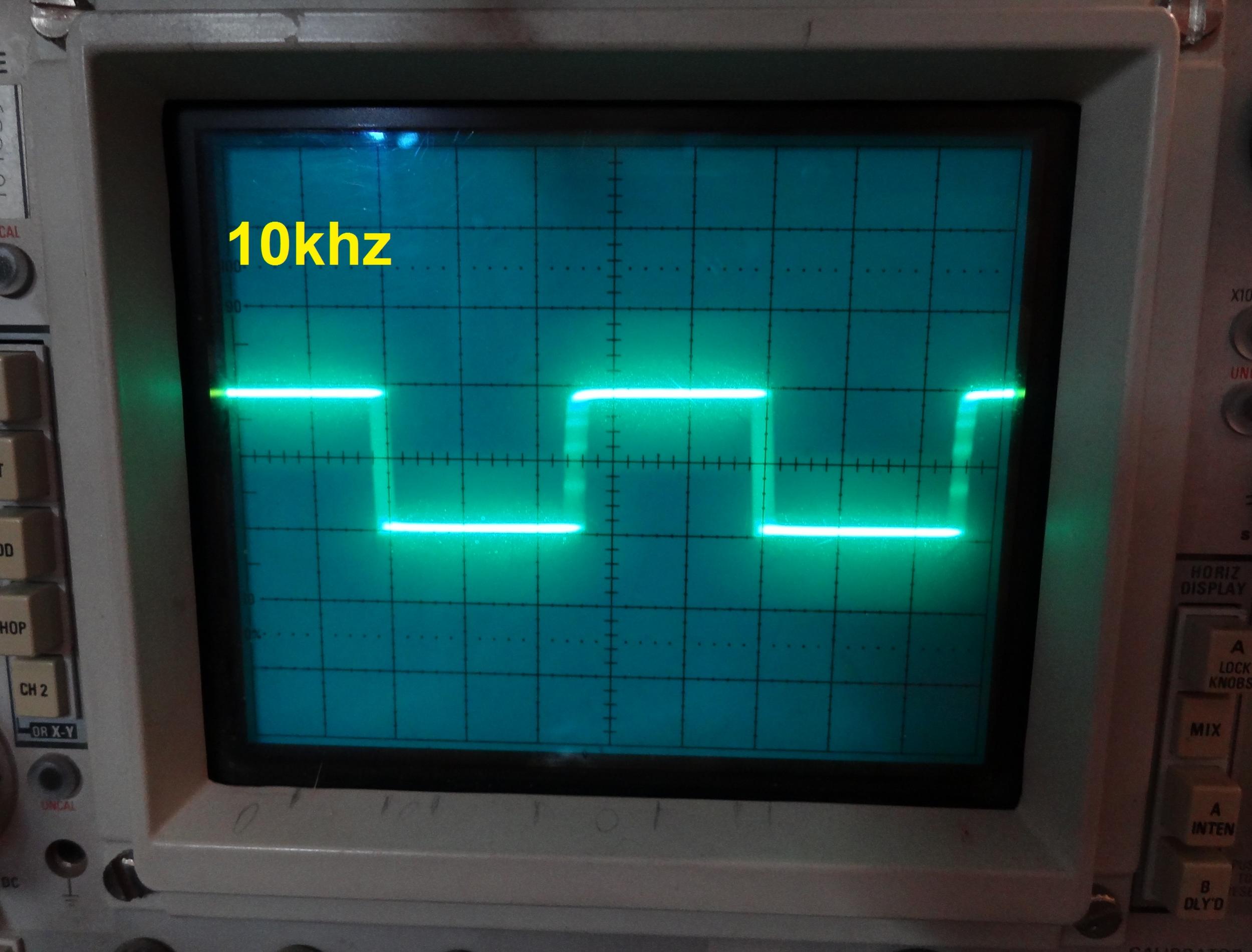

It's entirely possible that the square waves at high frequency have their foibles, the amplifier has some unusual compensation, it has high OLG, it has a hybrid BJT-FET CFP output and the FETs operate in Class C and probably don't turn on at exactly the same points in the waveform. But it does sound nice to my ears.
I did find my notes. I also used a rail current of 60mA when setting the bias.
I tested mostly with sine waves, all the way up to 2MHz as it happens. For square waves I used the probe test output on the front of my O'scope. It's limited to 1kHz but it's a super clean looking square wave, much better than anything out of my signal generator. The transition is very fast and very clean. Any how my notes say:
"No - load, 1kHz sq. wave from scope with +/- 0.25V, O/P aprpox +/- 7.5V, gain approx 30 sharp transitions.
Sq. wave into 8R load. Quick test - see about 1/2A per rail. Expected current = 7.5/8 x duty cycle 50% is approx 1/2A - O.K.
Scope trace looks clean, slight rounding on corners, no ripple."
You have a nice chunky heatsink on your set up. I'm amazed at how many amplifiers you build.
Do I see one of the amplifier boards with one of the power rail caps being different than all the others ?
Edit: IF I remember correctly, the cap across D1 can be left out and it still works, so something else is bugging it.

The one channel has issues. The voltages around Q4 are off. Now I am worried that I may D2 in wrong as well. I tried hard but I am still not a fan of SMD. Bad thing is D2 is buried below one of the outputs
The bad thing was that I didn't discover the components drawing until after I had already installed all the parts and the screen print was very hard to read. I'm going to have to go over the boards very closely now and see if I have anything else reversed.

No one has made comment on the oscillation of Stil's square waves.
pics 2 & 3 of post621 show it after the negative slope.
Does it get worse when the load is slightly reactive?
Post623 shows a very broad vertical. Is this an indication of instability?
i.e. lots of superimposed 10kHz starting at slightly different times.

Like I said, I really did try to be very careful when installing everything. I built both boards together so if one was wrong they both should have been. I was hating life while doing the initial install because I hadn't found the printout of the top of the board and the screen print was so faint I could barely read it. I was having to trace the foil circuits and compare them to the schematic to figure out which part was which. I didn't think about all the parts that would be buried behind the outputs. I'll be digging into that board this morning to see if I can find my error. I'll sit down with the schematic and write down all the voltages and go from there. Always something to learn. I always have a better understanding of a circuit after I have had to troubleshoot it.
That is why I posted the pics. I haven't seen these shapes before so I hoped someone would recognize what was going on. I included all of the parts. It may be that I was supposed to make some decisions along the way and didn't. Both boards show that spotted up slope. The sine waves look good except they are a little thicker than usual.

The blips on the rising slope have been commented on earlier. Maybe in a different Thread.
They are a small oscillation superimposed on the fast slope.
I chose to ignore them in my amp re-build.
It's the oscillation/ringing at the end of the falling slope that I see and wonder if it means much, or little.
I know that my knowledge of AC behaviour and compensation tuning is very lacking.
I hope some one with much more knowledge will come in a tell us to ignore or "do this" to solve.
But adding some capacitance across the dummy load might be more revealing of what is trying to show it's character.

Success! I found the issue with the second channel. I did indeed have D2 reversed. I swapped it around but that didn't solve the problem. I still had rail voltage on the gate of Q8. Q8 measured fine with the amp powered down but Q6 didn't. I evidently stressed it when I bolted it to Q5 because the base pin just fell out of it when I removed it from the board. A new Q6 and it is playing perfectly. I have it on my A/B setup along with my favorite VSSA and they are like twins aside from the TMG8 having slightly more gain. You done good Gareth! I can see why you were so satisfied. I've got some Gerry Mulligan playing through it right now and it is beautiful. Thanks for sharing this with me.
