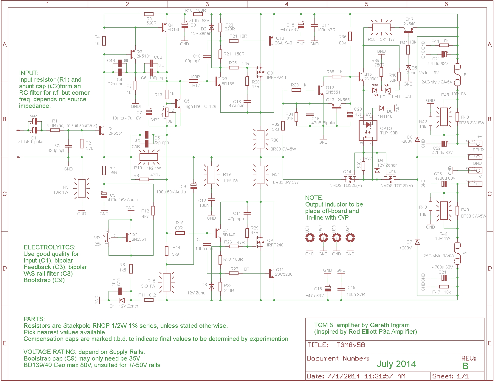

TGM8 (B)

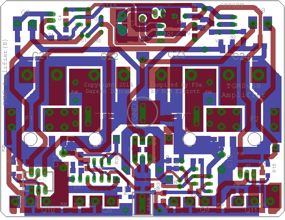

I might have a couple of boards left. However, it might also be of interest to have a revised layout, which incorporates the following:
i) Added C25, a 10uF 25V SMD 1210 part in parallel with the zener diode D1 as per post 297
ii) Inserted D8, a small signal diode 1N4148 SOD-123 part between the opto-coupler pin 3 and ground, as per post 314 (with R39 changed to 750R)
iii) Resized the main filter cap pad drill size to 2mm to better match the snap-in caps specified
iv) Fixed silk screen error ('bias' and 'offset' descriptions were transposed)
v) Updated the copyright for 2014 version B
I recommend you buy the boards from here, prices are excellent (there's a sale on right now!), service has been very good and I've been pleased with the quality: ITEAD Studio 2Layer Green PCB 5cm x 10cm Max
I ended up using the cheap green boards, but maybe Ranchu has found the coloured boards to sound better 😀

Hi RC - your amp is coming along nicely. However, you didn't feel brave enough to use the full version of my input stage i.e. 3 BJTs total 🙂

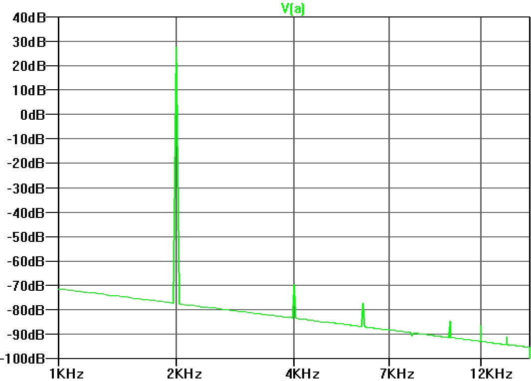

As an fyi, this is what my simulation file spits out for TGM8 based on +/-35V into an 8R load at 2kHz (just like your speaker 😉 ) for the FFT profile - note the Hiraga-like fall off, which is somewhat irrelevant when you consider this is a theoretical simulation and it shows all harmonics at around -100dB or lower which likely bears no resemblance to reality 🙂

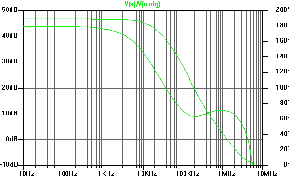

And the 2nd plot comes from placing a signal source in the feedback loop to examine the fall off in OLG (upper trace) and corresponding phase shift (lower trace). Not sure if this is a valid way of doing it - I think it shows a 60 degree phase margin.

THD - that extra BJT bootstraps the input device - much improved linearity, higher OLG (feedback does wonders when used well) and then add two pole compensation - the icing on the cake as far as the simulated results are concerned. But this is only simulations and likely not easily realized - and likely not the right thing to be worried about - the key is that my ears like the results 😀
It's beyond the scope of my brain to explain fully two-pole-compensation but there are lots of references out there (on the web). The way I see it - as frequency goes up there is more and more phase shift through the amplifier (from inductance/capacitance/resistance) and eventually you get to a frequency where the phase shift is too much (180 degrees) and you -ve fdbk is +ve. So you add low-pass filter to roll-off the gain at high frequencies so that the signal is no longer amplified once the phase shift is too large. Making this low pass filter with a single capacitor at the VAS makes the high frequencies roll-off at a certain rate. In order to have a stable amp it has to start rolling-off pretty early so you get less feedback at audio frequencies where you need it and so distortion is higher. But by using a two capacitor network you can create a low pass filter at the VAS with two different rates of high frequency roll-off so that you can keep high gain & feedback at high audio frequencies but still roll-off the gain quickly (more steeply) once phase shift gets excessive. You reduce distortion in the treble but still keep the amplifier stable.
I hope I said that right.
