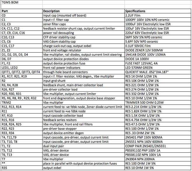

Here's the BOM for the schematic of post 87.
By the way, yes I did use a huge amount of VAS degeneration. I borrowed this gem from Bryston. They use such a design approach in the integrated amp I own. It allows use of a higher collector load for the input devices which improves their gain - you don't lose quite as much gain as you might think because of the high VAS degeneration. But I'm not looking for really high OLG - some other people might like more OLG and hence higher negative feedback factors. I wanted to avoid that. The simulated FFT shows about equal H2 and H3 at relatively low levels and then the harmonics after that are down in the basement 😀

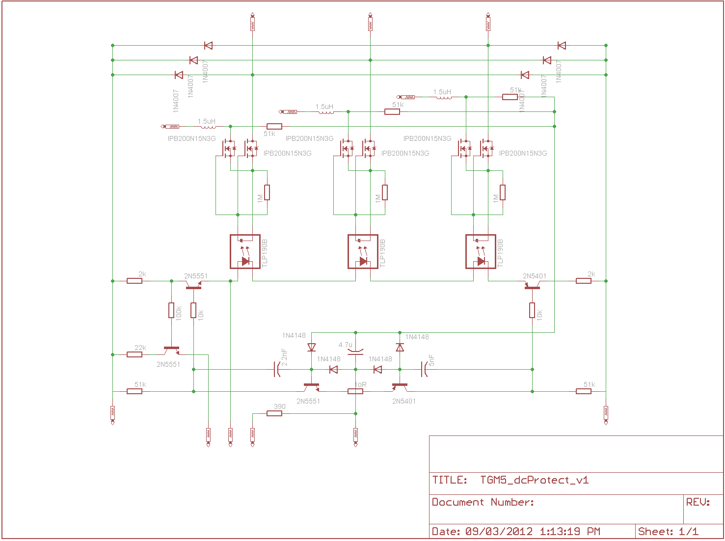

Next up... I want to finish this project with a simple speaker dc-protection circuit. I've attached an LTSpice model of what I have in mind. I plan to use solid state relays and they are indicated in the spice model by three LEDs in series since this is how the SS relays work.
I'm planning to use SS relays because I have not seen mechanical relays with adequate ratings to be readily available. I will make my own SS relays.
I use both paralleled in my universal advanced protection circuit.I'm planning to use SS relays because I have not seen mechanical relays with adequate ratings to be readily available.

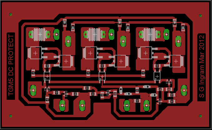

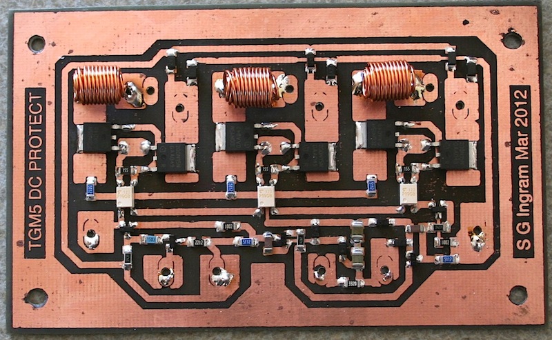

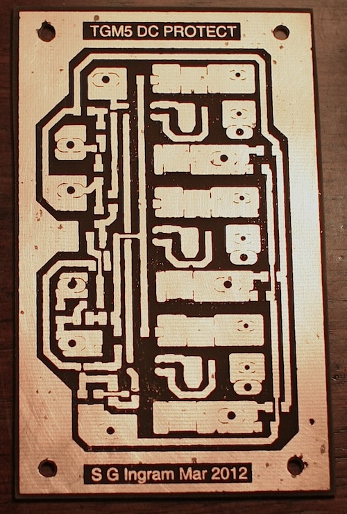

Well I've populated the board - took about an hour. Photo attached. I am getting to like this surface mount stuff, it can be pretty quick and it uses hardly any solder (so less fumes and less flux to clean up afterwards). The dual-LED status indicator is mounted off-board on the front panel. I used one of those LEDs with '3 legs' that glows red or green depending on how you feed it. If it's green, all is good, if it's red then the dc protect has been activated.
I bench tested the unit - worked first time 😀
I have installed it into the amplifier chasis and connected it up. As far as I can tell so far, it has no impact on the sound quality - good news.

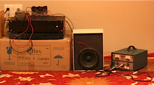

I also tested it with a speaker attached and playing music. I used a somewhat expendable speaker and monitored the voltage across it with a DVM. I built the amp with dual RCA inputs per channel, one dc-coupled and one ac-coupled. I fed music into the ac-coupled RCA and then hooked up a bench supply via a resistor to apply dc to the dc-coupled RCA. This allowed me to apply varying levels of dc to the input of the amp and measure the output.
In the rather blurry attached photos you see one image of the set up where the amp has a green light, no dc applied. I applied dc and watched the cone move further outwards. With enough dc applied the protection was triggered and the output cut-off. The LED changed to red. 😎
