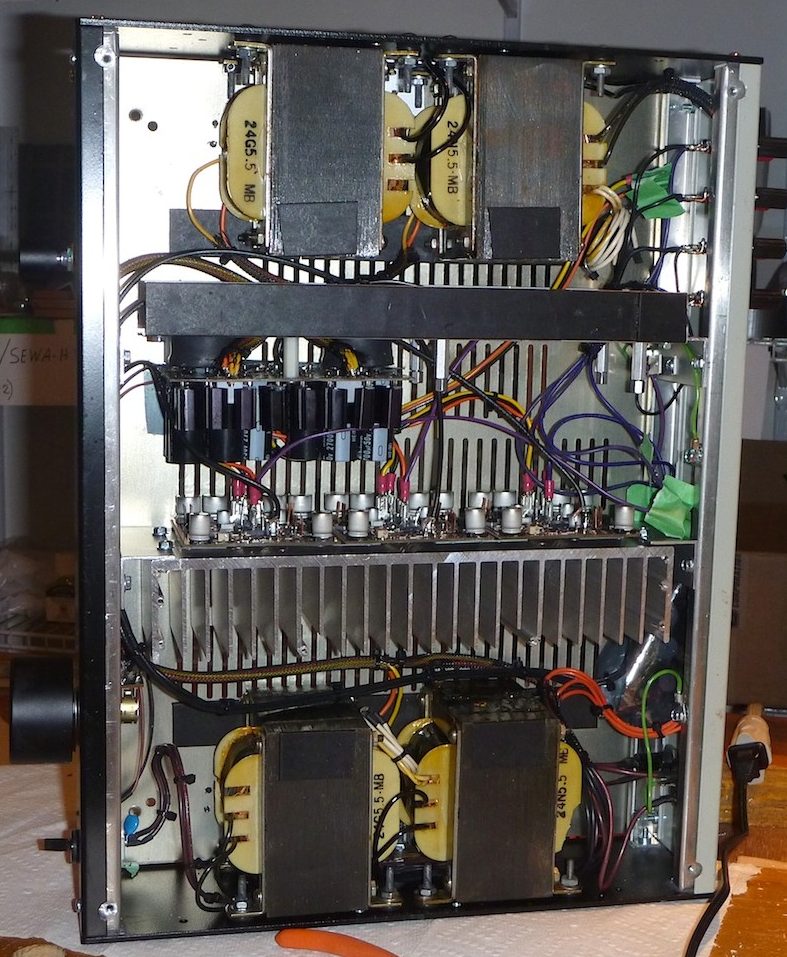

Well, I finished wiring all the channels up - it's all finished except for the speaker protection. I decided to use some big electrolytics as temporary dc protection - only they didn't sound too good, in fact I felt like poking my ears with a sharp stick so I decided to take them back out and risk it for awhile.
I hooked up my YBA CD player as a source and connected up my floor standing PMCs.
The sound was not as good as yesterday. The 'tube' sound that was so enthralling with the small full-range speaker did not translate to the big floorstanders. I replaced the feedback resistors and returned it to a fully symmetrical design. This cleaned it back up. Now, on my PMCs it sounds really darn good. I'm not sure bass is as strong as the Bryston, but it's very close and overall I find it more musical. Where it seems to shine in particular (at least right now) is on the lower treble - where most of the harmonics appear for strings and female voice. Here the sound is simply gorgeous.
I also switched over my my B&W floorstanders. Sound is good, but after listening to the PMCs the B&W's just don't really cut it.
I'm still surprised how turn-on and turn-off is a non-event. You can cycle the power, turning it back on before the power supply caps are drained - not a sound, not a tick, you'd think it was simply on mute. I've never experienced such quiet with a DIY amp before.
The dc-offset appears to be rock steady too, which I'm still scratching my head over.
Well that's as much exposure as I want to give my PMCs without dc protection but I've heard enough to know this is a keeper. It's almost a waste to use it for my home theatre, but the enormous weight of the EI power transformers suggests that it stays where it is (and those darn things do have a noticeable hum to them).

My early impression of the less components 50W Latfet one I discussed in the main SSA thread as put together by a friend too, is that is a homogenous big sound, extra quick and smooth. Treble is really never solid state harsh, and overall detail level is very high but naturally spread. Bass full, elastic, pacey. I compared to my KT88 trioded 20W push-pull and although its power drive was naturally tamer for the doubled up 6x9 oval bass drivers of my 3 way than the SSA, it reminded me that this is an early amp, still need to see about things like more tonal differentiation on instruments, a bit more depth perspective, removal of some second harmonic or counteract what strikes me as some Mosfet mist-lack of tonal brilliance. Have to see about best bias for most suitable harmonics profile, squarewave best shape regarding subjective impact on overall tone. Then if not content, I will have to see about Dale resistors, other than Toshiba input stage BJTs, maybe a BJT output stage. I compared in my own system with vinyl as source. To put it in a nutshell my impression is this is maybe the best solid state diy platform to tamper with. Shows big potential, but its not a finished project yet. Smashing success on main lines, needs to build some finer musical character yet. Being class AB, it stands high between class A bias special amps on first strike.

now, I need to sort out the wire dressing, still have a bit of hum…

It's not that there was anything 'wrong' with the high treble, in fact for the most part the treble is some of the best I've heard, especially the lower treble - just amazing. On the other hand, I have noticed that in the past I have preferred the sound of high treble from the few tube amps I've listened to when compared with SS amps, perhaps because in those examples the tube amps were a little more rolled-off. One tube amp however was not rolled-off and the output transformer not the best one could buy - the treble in that case was not good. I'm particularly sensitive to fatigue from treble, once I even experienced 'treble overload' at a live symphony (real instruments are darn loud!).
I have noticed that listening in the late evening the quality of the treble in all of my amps is better and I attribute this to the quality of the power. I haven't got any hf filtering in the power cable and this would be interesting to try when I have time - I am thinking of a simple common-mode choke. But for TGM5 I have used EI transformers which I understand are better at limiting hf ingress from poor power, and I have a CLC filter.
The r.f. signal filtering at the input to TGM5 is a 1k series with 1nF in parallel so it doesn't cut off that quickly.
Still, I think initial listening tests remain very positive and I will do more listening. I have to resolve some residual hum first and I want to get some dc speaker protection in place.

I am glad that TGM5 will be a good HT amplifier as it was intended to be. It is as you've said even overkill for that purpose, I agree. It was designed for that purpose so I didn't want to interfere too much. 🙄
What I would do in a amp for a stereo system would be VAS cascodes, T5&T6 super beta BJT's, 100ohm/100pF input low pass filter and larger uF filtering caps from Mundorf or Panasonic.

Yes, building TGM5 was really an interesting project, the HT was really just an excuse to do it 😀 On the other hand, I think people underestimate the benefit of hi-quality sound for HT as there are not only some movies that are really made for good sound (e.g. Master and Commander) but also some blu-ray mutli-channel music discs. When you have good sound for music, it's intolerable to have bad sound for movies.
I agree, the next step is to cascode the VAS, taking the heat of the VAS allows higher performance parts to be selected, more linearity to be achieved. Not sure about super-beta devices. Maybe try FETs as Hugh and others like PMA have suggested.
With gobs of nfb the main rail caps are less concerning to me than the filters on the front end of the amp - and the royal way might be to use a shunt regulator there ?
