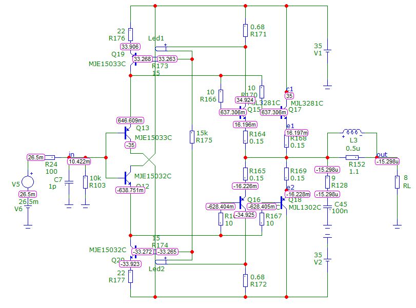

TGM11 - no GNFB - inspired by Steven Dunlap 'KRILL'
I didn't understand it well enough, nor could I get a satisfactory simulation running and didn't want to bench test it. So I didn't adopt it. I did include the basic buffer - you can see it somewhere earlier in this thread if you scroll back up.
DC conditions from the simulation, it all looks fine and operating well with Cordell`s models.
Modulating ccs trick has a little effect on the distortion in the simulation.

YES!
The circuit works well.
But I was never happy about THD. It is higher than industry standards although it sounded wonderful.[....]

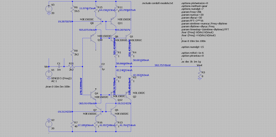

Hugh, I assume the output stage was open loop? If citing industry standard, do you count in also closed loop output stages, or compare to the few open loop designs like Ayre, or some Pass designs who run the OP open loop?
Did you build it exactly like from the scan from this post? TGM11 - no GNFB - inspired by Steven Dunlap 'KRILL'
Pawel,
I think so, but it was a long time ago, more than 7 years ago and a brain injury! For a couple of years 2012-2014 much of my memory is hazy.....
Sottomano,
Yes, it was open loop. There was no closed loop back to the VAS, but there was heavy feedback from first to second stage. The Zout was pretty low, about DF of 40 actually, it drove a 87dB/watt/metre speaker well in a large auditorium with 110 people in attendance. I measured H2 at around 63dB down, THD around 0.1% at +20dB, followed with higher orders decreasing linearly at about 5dB each. What was really surprising was the sound quality; quite beautiful.
I moved on and my latest product, the Maya II, uses a simple source follower with very high gm mosfets. I do have global fb but keep it to about 30dB, most of the OLG is absorbed in nested fb.
On reflection I think there is a product here, but it is quite difficult to finesse it across the wide operating points we need for high end. And setting up a stable quiescent is tricky, the CCS is tetchy.
HD

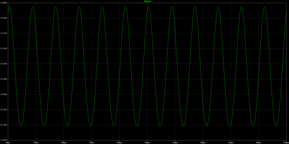

Dear Hugh!
with the value similar to proposed by you the circuit works as follow (it has the gain!!!),
what needs to be regulated?
There is no gain but there is current manipulation. All voltage processing is a simple input base to emitter and second stage base to output emitter.
The distortion is created by differential Vbe steps arising from increasing output device Vbe and reducing Vbe at the drivers. To reduce these differentials we should arrange driver current increasing faster than the output base current demand. These currents are not linear because beta drops as output peaks.
The outcome is a spray of low order artefacts, H2 to H12. The profile is not identical to the profile driven from cross over. What surprised me was the good sound quality.
Pawel your Spice file sets only 20V rail. All my experiments used a 56V rail and things hot up at high power.
