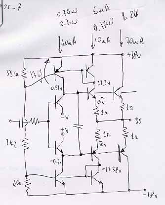

TGM11 - no GNFB - inspired by Steven Dunlap 'KRILL'
This picture explains better my approach for the bias string and thermal compensation of the OPS based on LTspice simulations. Convenient for construction too.
Damir
I suggested at the time doing a sim with a real speaker load i.e. change the angle of current to voltage. The fortuitous cancellation tends to go away. I will not participate in another Krill thread.
I've not tried simulating real speakers - would be willing to try if anybody has a favourite equivalent circuit. Anyhow, I'm planning to bias this up to around 26mV across the Re resistors, just like every other Class AB I've built before - it's just a Diamond Buffer output stage afterall. Maybe that was missed previously.
Where I am more concerned about 'fortuitous cancellation' is in the voltage gain stage. Simulations into resistive loads suggest this error take off approach from Mr. Kulish should be cleaner than a simple Darlington.

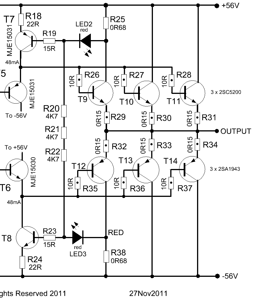

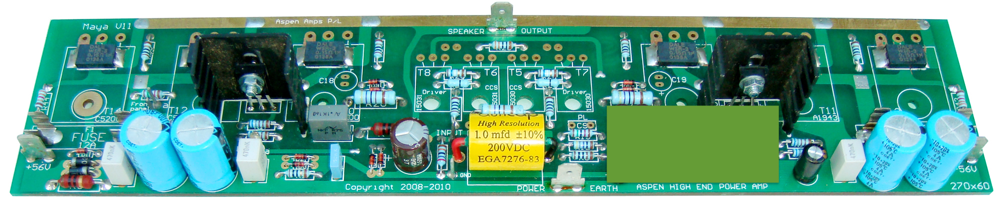

However, Hugh has kindly offered to make some information about his amplifier available so you have a solid place to start from. You are seeing it here for the first time !
Here, I've attached a drawing of the output stage (copyright Aspen Amplifiers, all rights reserved) and a picture of a finished amplifier to drool over !
For the front end voltage amplifier feel free to use one of your favourites. For my TGM11 I'm using a simple two-transistor voltage amp.

Sensing resistors R25/38 are for modulating ops bias, but there is a positive feedbac if I see well? Raising current trough ops bjts is raising reference voltage for the ccs, so ccs is delivering current peaks on demand?
Clever idea to avoid a high biasing of T5 / T6, yet enabling them to deliver the necessary drive current for the output transistors. It also allows to dispense with a triple output stage and it's stability issues.
(Btw I thought Hugh is avoiding CCS's for acoustic reasons?)
