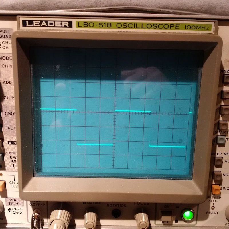

Fixed It !
The error was fixed. Now the LTP is more balanced, input leg at 533uA through R5 and feedback leg at 499uA through R6. The difference is 34uA and most of that will be the base current for the VAS device. I was able to easily set the dc-offset to less than 1mV; of course it drifts around a little but keeping it to a few mV is a breeze.
I re-measured base current to the input devices at 85uA to 90uA which implies an Hfe of 587 and 590 for the two devices. Of course my measurement error is at least 1%.

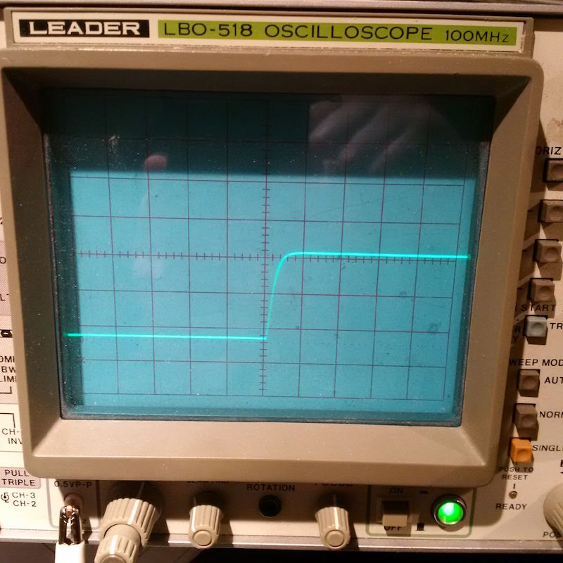

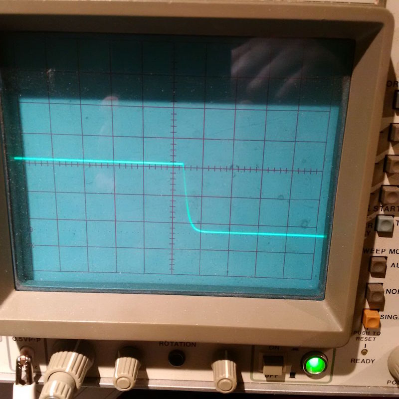

I re-measured the square wave into 7R5 load. Still nice and clean with rounded corners.
To test the speaker disconnect I turned off the +ve rail power supply only, and watched the dc-offset at the output climb slowly as the capacitors discharged. The green LED cut off the output at well under a volt. Same result when turning off the -Ve rail first.
