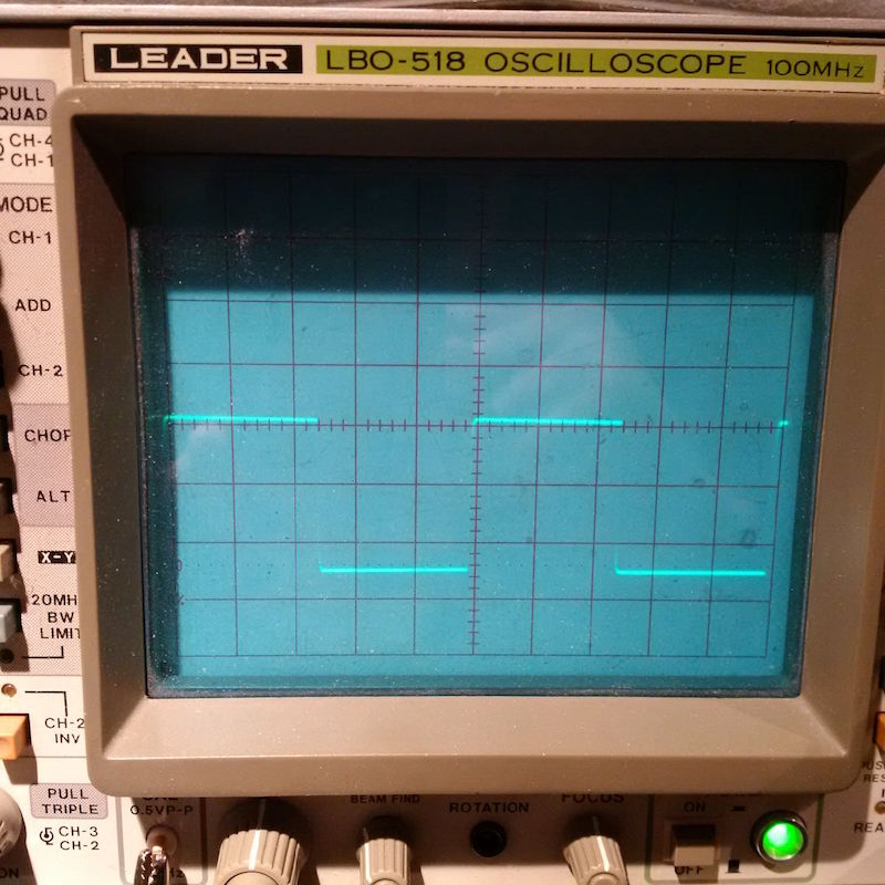

I re-wired my bench set up. I can't remember exactly what I was doing but I suspect I was making inappropriate use of the signal ground connection and had the output wires and input wires poorly separated.

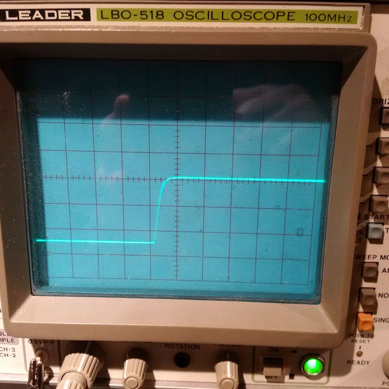

Well, whatever I did seems to have cleaned up the square wave. Attached shows the 1kHz square wave into the same resistive load as yesterday with no changes to the amplifier. The 2nd attachment is what it looks like when you pull out the x10 timebase control.

That's a nice looking 1kHz test wave. Nicely rounded corner indicating good HF response and passively rolled off somewhere.I re-wired my bench set up. I can't remember exactly what I was doing but I suspect I was making inappropriate use of the signal ground connection and had the output wires and input wires poorly separated.

No over shoot indicating good compensation that suits your specific test load.
There is no need to test at 50kHz. The 1kHz sqw tells you all you need to know for an audio amplifier.
What did you do to the input filters to pass this test sqw?

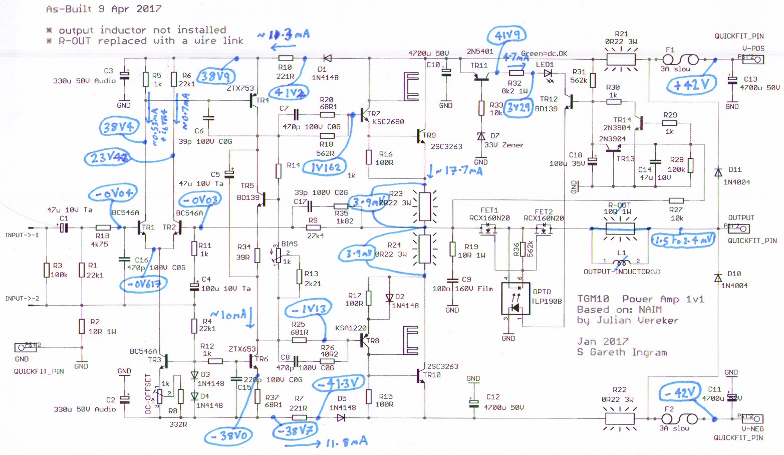

There's something odd with the voltages measured on the bases of the input pair.Attached - a few sample voltages.
I'm not yet convinced about the treble but overall sound is very nice. I need to try something other than my DIY full range speaker on this amp.
The base current into the input transistors has to pass from the audio ground/signal return through the 22k1 R1 and 4k75 R1B
if base current of TR1 bc546a is 1uA then the voltage at the base lead will be ~ 0.02685V
Your bc546a would need an hFE of ~356 to get to your measured 0.04V of input offset.
What is the base current of TR1?
Could you have measured using the bottom of R2 as your DMM reference? The top of R2 should be your reference for measuring input voltages.
What is the voltage across R2?

Very useful data. I keep thinking the beauty of this Naim design is we have very few choices. As far as I can see one remains.
VAS transistor gain and Cobo seems favourite. Self rightly says better the capacitance is external as it is higher grade. What he means is you are getting something like the worse ceramics ( not COG/NPO ) inside the device.
Would you mind explaining this again?Self rightly says better the capacitance is external as it is higher grade. What he means is you are getting something like the worse ceramics ( not COG/NPO ) inside the device.
Primarily the phase-lead compensation.That's a nice looking 1kHz test wave. Nicely rounded corner indicating good HF response and passively rolled off somewhere.

I think it looks marvelous. First turn on and everything okay. That means you pay a lot of attention to what you do. I do not see any problem with voltages. Turn it up and listen.

confession time 😱Looks good. the dc offset is excellent. You might tweak the LTP CCS to get their Ics even closer.
I didn't match the LTP devices, just didn't want to to wait to find out if the darn thing was going to work or not. I had several new transistors on a strip of cut-tape so I cut two off and installed them. I do expect that they are fairly close - in a previous project where I had borrowed an Hfe meter I found that parts from the same batch were very closely matched already - there was one 'rogue' part in the batch. I don't have access to that Hfe meter anymore.
What I could do next is to build up the 2nd channel and match the devices. Then see if I can discern a difference, measured and subjective listening-wise. But I do note that a mis-balance is something we believe JV was aiming for in order to achieve a desirable harmonic profile. Mis-balance will be primarily a 2nd order harmonic and this is believed to be one of JV's intended goals.
The input filter on the amplifier is per the schematic. The only real change was to re-wire the external-to-pcb wires on the bench top to something a lot more sensible. In particular, I had some poor grounding choices, including using the signal-gnd input as the scope probe ground despite having installed a ground lift resistor on the pcb.What did you do to the input filters to pass this test sqw?
these were quick and dirty measurements and I should review them again. It's quite possible of course that I have a rogue device in the LTP. The datasheet for the VAS device I have shows Hfe is expected to be around 200 which would imply 0.05mA of base current which means that leg of the LTP will be running at round 0.58mA and the other leg at 0.7mA, about 20% mis-balance whereas the difference in base resistors is only 3% (if the resistor values are correct). I'll check it again.There's something odd with the voltages measured on the bases of the input pair.

It's interesting to see your 1kHz square waves. To be honest a little better than I imagined. Then I remembered. It was the standard test in the 1970's. You bet the correction networks were tuned to get that done. If the amplifier rolls at 38 kHz one would expect to see trouble at 2 kHz if the old Open University course I followed was right. Thus 3 kHz is about where I would think it starts to really show. Real music worst case is a 1 kHz squarewave. A CD player just about can do 1.16 kHz to the Open University mathamatical teaching ( F +1/3f3 + 1/5f5+ 1/7f7..........+ 1/19f19 to a good approximation). Triangle waves are a squared number version F+1/9f3+1/25f5.... . Nice to see how a simple filter and a squarewave can do that.
