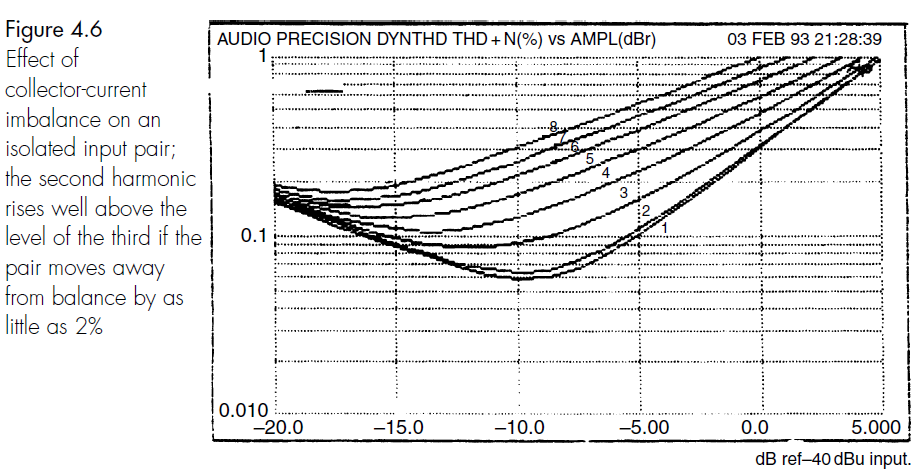

The attention Self gives to distortion harmonic content varies from one edition of his handbook to another but this snip from the 4th edition -2006, discussing the LTP in isolation, might show what imbalance does without becoming a copyright problem here.
I might be reading too much into my interpretation of that pic (for educational purposes) but the lowest curve (1) for a very closely balanced LTP shows a steeply rising curve once we are beyond noise effects. He is stating this is predominantly 3rd harmonic.
We can see that the top most curve (8) where unbalance has reached 10%, that the slope is much lower. I think he states in another part of his book that the slope indicates which harmonic is dominant.
Here he states that 2nd becomes dominant and that seems to fit with the change in slope.

... this snip from the 4th edition -2006, discussing the LTP in isolation, might show what imbalance does...
In case you find the graph confusing as I did, a later edition has a key to the various % current imbalance curves as follows:
1 = 0%
2 - 0.5%
3 - 2.2%
4 - 3.6%
5 - 5.4%
6 - 6.9%
7- 8.5%
8- 10%

Regarding LTP distortion.
I simulated a pair of BC547C with 1mA tail current, no emitter resistors, fed on the inverting input from a 10mV amplitude sinewave at 10kHz. +/-40V rails.
With perfect Ic balance and 1k in each emitter, H2=-100dB, H3=-50dB.
With 22k in the inverting emitter, H2=-77dB, H3=-52dB.
Offsetting the Ic by 2% (ie: inverting transistor Ic=490uA):
With 22k in the inverting emitter, H2=-57dB, H3=-52dB.
My measurement error is about +/-2dB.

The transconductance of the two transistors is what needs to be matched. BTW this is temperature dependent.
Because the two transistors have different Vce their temperatures will be different. The Vce of the inverting is lower than that of the non-inverting, or about 30V vs 40V. With an Ic of 500uA this is a power difference of 10*500uA=5mW (non-inverting 20mW, inverting 15mW). I found a Siemens data sheet that claims the thermal resistance from junction to ambient for the BC series TO-92 is 250K/W: so a 5mW difference will cause a 1.25K junction temperature difference. The ambient is going to be around 25C (say) or 298K so a 1.25K difference is less than half a percent.
If I've got my sums right, in the Naim circuit the transconductance of the inverting transistor will be a little under 0.5% lower than the non-inverting when their Ic's are identical due to temperature difference.
I don't think a 0.5% difference matters much for Bigun's circuit let alone being that easy to adjust to. Just get their Ic's as close as you can and try for an output dc offset within +/-10mV by select-on-test. 🙂

My model is unrealistic because I have one base grounded and the other fed from an ideal voltage source. Real base impedances will affect the results. But it gives a reliable indication that adding the collector resistor will increase H2 as will unbalancing the Ic's, but by far the largest affect is unbalancing the currents. In either case the H3 is largely unaffected.
