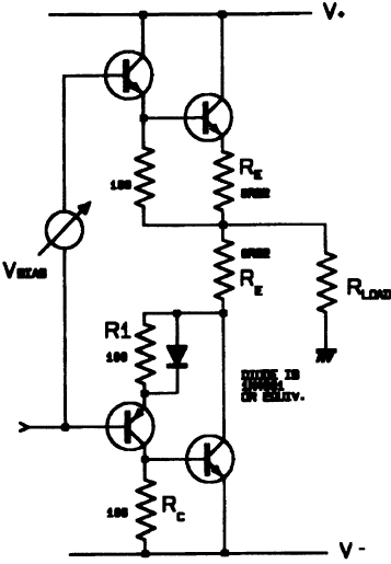

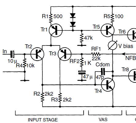

The Naim amplifiers were basically a copy of the 1972 75W design published by John Linsley-hood in Hi-Fi News, upgraded by the replacement of the boostrap by a current source. The A&R A60 was the same, as were many Japanese products. The pcb was laid out (Bishop Graphics, no CAD in those days) by his then girlfriend (Dianne from memory) who was a lovely lady. Got pregnant later and Julian ditched her ...he was a total prick.
JV forgot to read the last bit of J.L-H's article noting the likelihood of instability when loaded with small C such as you get from the figure-of-eight zip cable commonly used as speaker conns. The inclusion of a small choke cured that but JV omitted it
. After a series of meltdowns he specified that his amps must be partnered with his special (and grossly overpriced) cable. The 2 r/c networks in the driver bases could be tuned to allow for slow drivers. With newer devices these would probably not be necessary. The only thing which made the Naim amps outperform their similar opposition was a hefty power supply, fully regulated in the case of the 70W version.
I don't think it helps much to repeat the rumour and speculation on the lineage of the design, already seen in the copious off-topic of the Ebay clone thread. As I see it, the design is entirely generic of its time and borrows more from successful IC opamps and hybrids as suggested earlier. It's even the same topology as Douglas Self's generic model amplifier - albeit with quasi-complementary output stage. Being well known topology now, there are analyses of operation and performance in other publications too. Self's Blameless model of course, is all about the refinements applied to that basic design such as a current mirror, beta enhanced VAS, decoupling caps, speed-up capacitance etc. with the sole purpose of reducing its distortion.
Conversely, had JV not tinkered with coaxing nice harmonic distortion from the generic design instead, Naim would never have had a domestic product worth more that any competent 1970s amplifier - probably leaving him with only the pro. sound and lighting business. That much is an amusing dichotomy and an insight to what UK Hifi industry figures of the day, such Ivor Tiefenbrun, looked for in sound quality 😉

I think the fact most people reject is all of these amplifiers are versions of op amps. When the LM1875 we have an op amp that can do anything. I only realised recently that these op amps if driving a high resistance load are almost perfect devices as long as not used for RIAA ( with a Shure M44-7 we might ). From this I might build a preamp that can drive speakers if I choose. It will be a Naim like device with a big PSU out of need. The ECC83 or 33 valve was an early op amp or helped when building one. From about 1935 op amps were known. Harold Leak made to my ears the first transistor amplifier that sound just like the valve versions he made before. With modern speakers perhaps the valve ones were better. Leak pointed out that getting rid of the output tranformers and shipping weight made it possible to say better value. Even so only 10% was saved. Leak eventually went to an op amp long tail pair version about the time of the HK Citation 12, alas Mr Leak no longer owned the company then ( testing was reduced to 1 in 10 units , Source Alan Tisdale now dead, He told me how Mr Leak cried when Rank bought him out ). The first thing Julian told me was he had the identical test everything and every finished thing routine as Leak. He jumped into the vacuum Rank made.
If anyone wants to know about bootsrapped CCS just ask. I suspect 70% to 90% is ideal for the positive feedback ( that's all there is to know really, above 92% add a series resistor to avoid nasties ). The capacitor can be smaller than you might think allowing a film type. As transistors became cheaper a transistor CCS became realistic. The op amp input also became cheaper. Some amplifers were more stable when they did not have a long tail pair input. This has been over played by some people and forgets many VAS devices were high capaitance before the modern devices ( About 1967 ). The same ones who say the inverting input sounds best. With my LM1875 pre amp it might.

What the long tail pair versions of amps allowed was the feedback and input signal to arrive at opposite sides of the pair. As we have an emmiter follower driving a common base stage the disadvantages are small in adding an extra transistor. The harder to drive common base working with the doesn't give a damn follower. They swap functions as one can see in a differential pair, I choose to freeze time in my snap shot.
If we feed the input signal to the inverting side of the long tail pair we minic the older style amps as the feedback signal and input sinal sum at the transistor base. The advantage of this is we retain the 0V DC reference point with virtually no second thought as to how. Critics don't like this idea and will agrue one input transistor is best . JLH even showed that the DC point can be stable if no long tail pair used. A Naim amplifer could be converted to single transistor. I suspect it might be even better if it was as the 12K 1K trick would not be needed. The JLH DC point idea would be useful if so.

He converted his output stage from quasi complementary to full complementary symmetry. He used a colloquialism apparently exclusively English.
Yes, I supposed that a transition from quasi to true complementary has been meant. But I stumbled on the question if the 2N2955 really was true complementary to the 2N3055? In the 1970ies we were told, especially by ELEKTOR, that it isn't. They strongly recommended to use the Motorola pair 2N3055/MJ2955 in their EQUA amplifier, e.g. Some time later, the Texas Instruments TIP2955/3055 pair was allowed also.
Contemporary tables listed BDX18 as the 2N3055's complementary.
Best regards!
Julian Vereker is quoted as saying " Complementary transistors are as alike as men and women of the same height and weight ". I was told Julian argued for years that the NPN transistor would effectively become a PNP device if 100 % local negative feedback was used via the collector output ( as said H C Lin circa 1957 although it was PNP germanium then ). This is not absoluty true as the voltage gain of this device is about 0.97 and the emitter follower about 0.92. Stablity also could be less good. Looking back Julian came up against something we get at DIY audio. Some will argue a point because they can. More like a court of law and no respect for someone trying to say something important and needing help. I respect Julian for forcing the correct arguement to now be considered as fact. If quasi has a problem it is the need for correct biasing and a way of keeping it at that point. The remarkable Quad 303 is better on this and has a more ideal input distortion curve.
You guys should look at cloning the Crimson Electrik amps. As best I know a Naim Quad 303 hybrid. The Naim input could be added. If they had had the BDY56 transistors of Naim or whatever we like these days they could be best of the Quasi's . Most NPN PNP amps always sounded a bit slower and darker than the Naim to me. The thing I like about the Crimson is the rhythm and zing. Seeing as the output devices are slow the zing is a big surprise. The Crimson is the only amplifer I knew that seem to please all that heard it. The sort of sound the Audio Lab implied, but didn't have. I only say that as their Lentek amp did.
