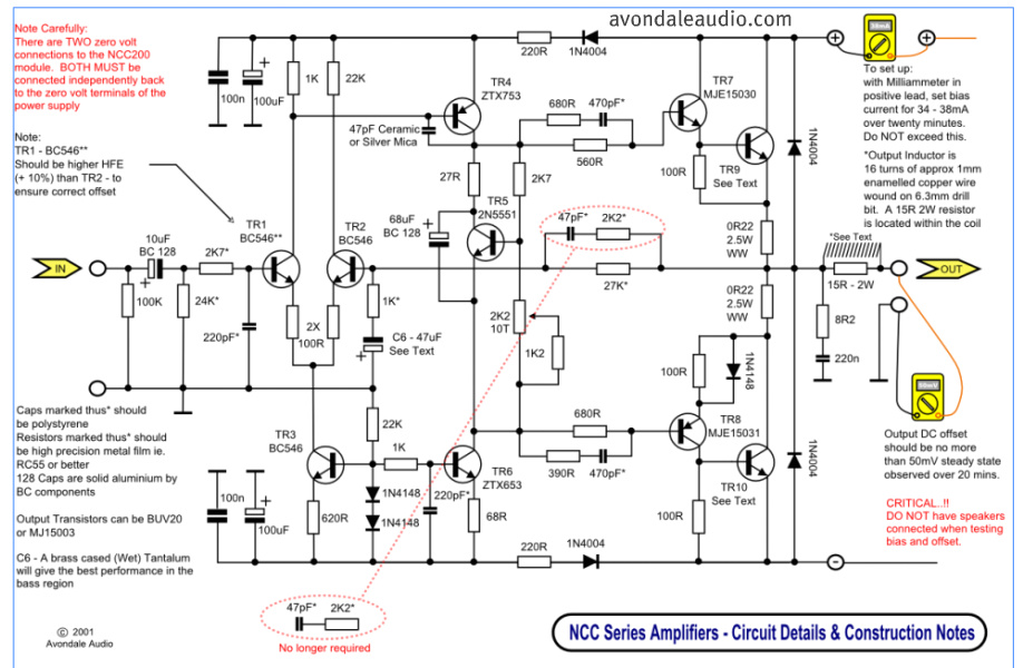

I have enjoyed the NAIM approach for years, and first saw it close up in the Avondale circuit which is commonly available on the net. I applaud and thank Bigun's interest in it here.

Simple amplifier with "sophisticated" compensation
I'm not so far with listening and understanding the different ways of compensation. One designer here has a complex compensation too and I disagree with his choices. Bigun also uses more than simple compensation (I think I will study his TGM1 soon).
[Even when using fast devices I always look for no-compensation possibility]
So what are your goals when you select for certain compensation scheme and value?
Answers to questions like this might answer the untold story about what make a good amplifier beside the already known criteria like THD. If you like high slew rate, you might have your own threshold for this variable (And if you choose too high a number, many will disagree, btw)

That's the first time I have seen an Avondale schematic with the electrolytics the right way around.

My goal is lowest THD at 20kHz as possible but still good harmonic profile (monotonic) and high slew rate. Of course it must have enough gain margin and phase margin.

Thanx Bimo. Is PM/GM the only stability measure/test that you use (and what are the thresholds here)?
I was able make a stable amplifier with PM 60 and GM 9, but I likely have PM 70 and GM 13 minimum because I can use cheap parts for prototype.

Bimo wrote 0.000625%. That's less than 1 ppm. Simplest circuit will be achieved by CFA topology.
0.000625% is 6.25 ppm, not less than 1 ppm.
Oh, I didn't know that. I thought everything is multiplied by 1000. So my amp was not below 1 PPM at 100W but below 10 PPM? Oh, now I see, that's because % is only divided by 100 so now it must be divided by 10000? Ok, thanx.
