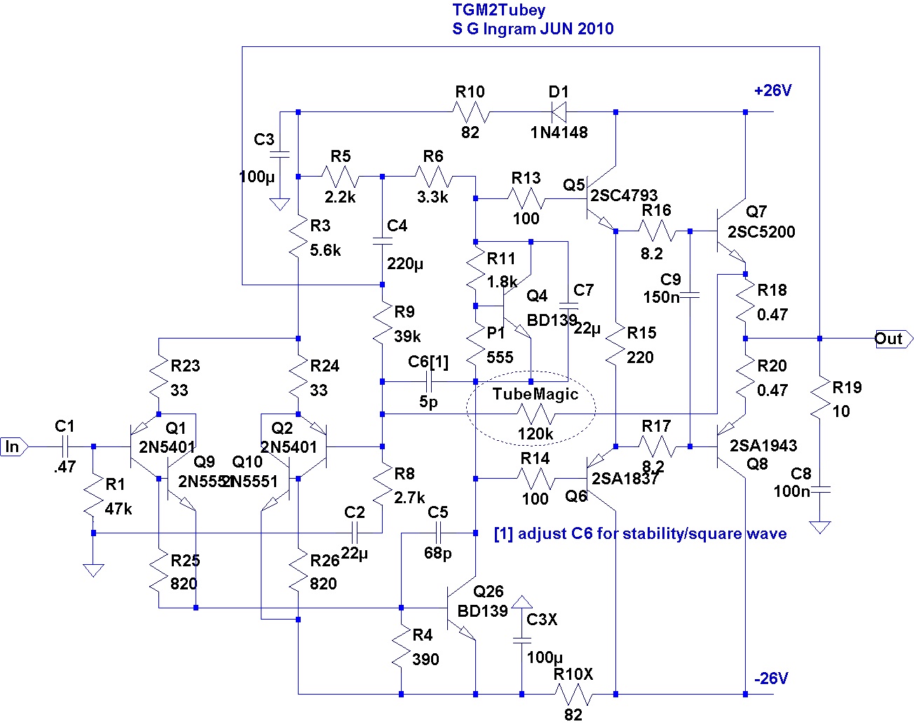

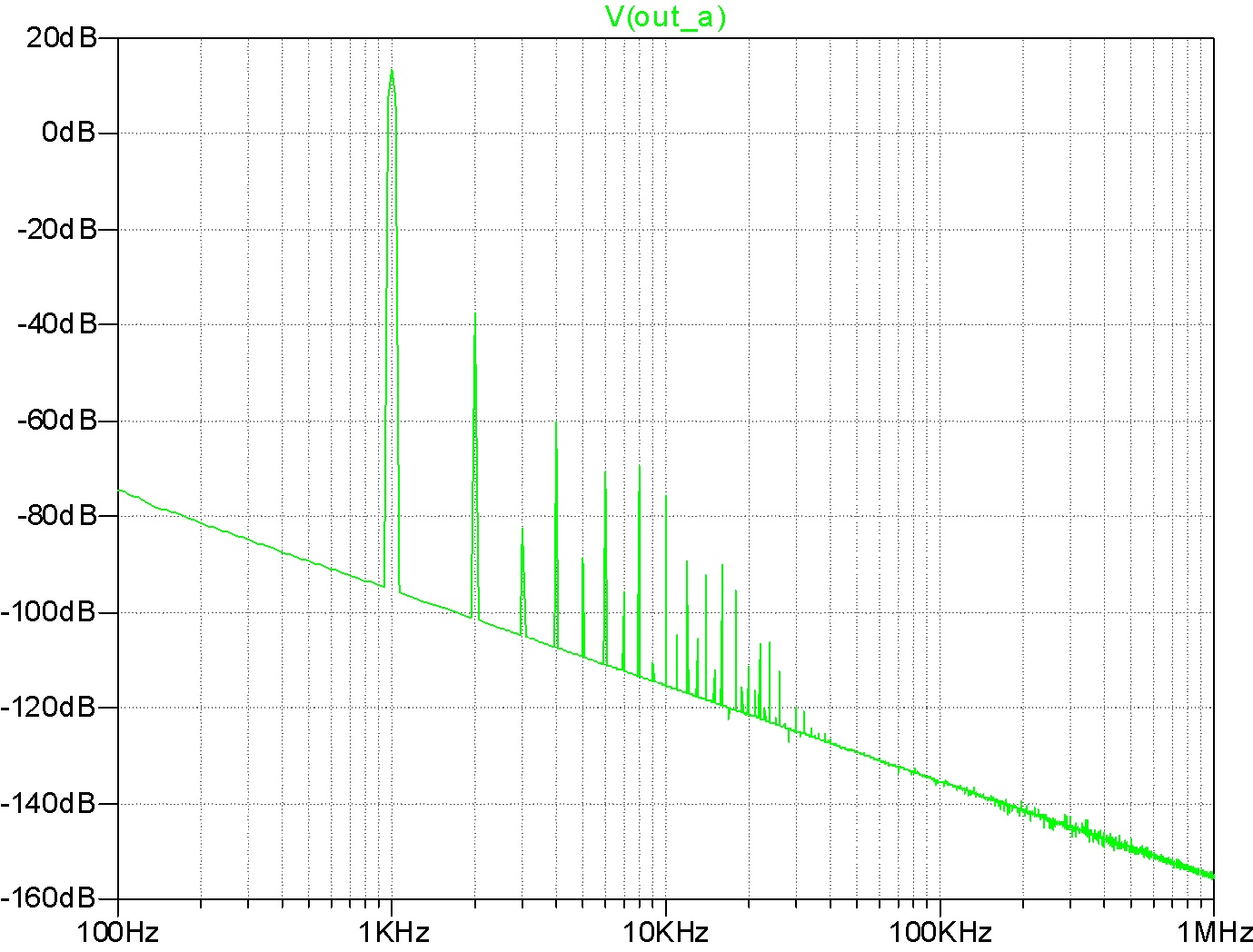

The 'tubey TGM' is not in my HT system doing a good service. I haven't the equipment to measure it but it's such a simple idea I hope somebody with the gear will try it one day and let me know how it works in the real word as a correlation against the improved sound that I hear.
Simulated, it seems to generate low order even harmonics without a detrimental increase in odd harmonics.
Too bad that in reality such circuits tend to sound like a broken radio.
Exactly.
You can simulate some errors, but you can't simulate absence of others.

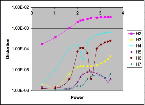

The even-order stuff looks like a bit of full (or half) wave rectified output leaking back to the input. Second harmonic is almost the same % at 16W and 44W.Hey Bigun, I've been interested in Symasym since I joined this forum. Look at this page with spectrum plots:
Symasym V5_2 review
- keantoken
It should be fairly easy to trim most of that out (or dial some in, as Bigun's doing).
