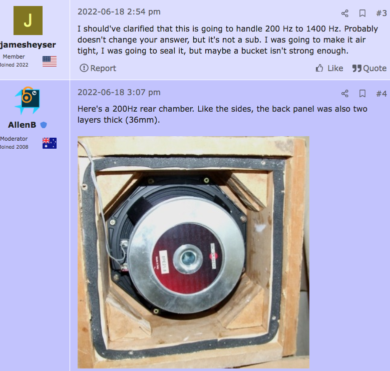

Something around the size of the chamber AllenB used for his 200Hz horn will probably be in the ballpark.

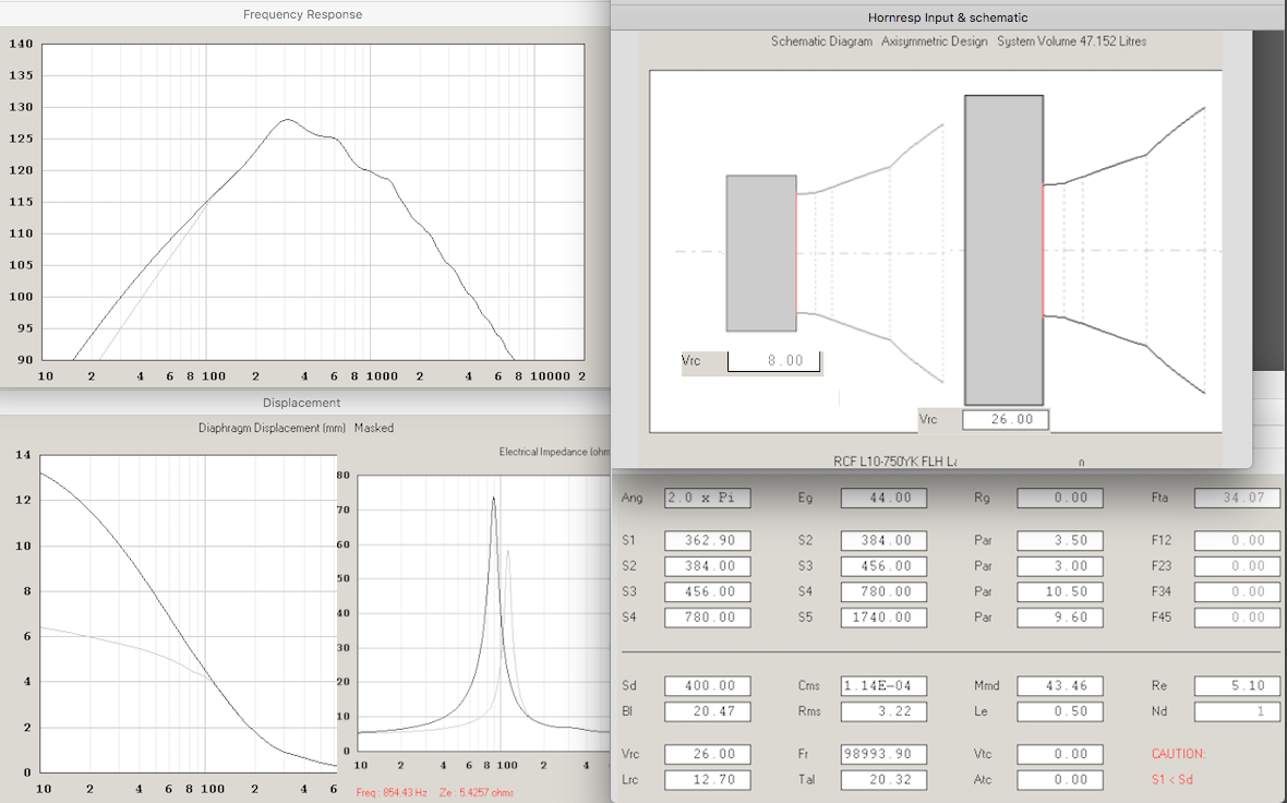

You want the test to be loud enough to be at least 20dB above ambient noise levels, which probably could be achieved with two watts (around 4volts) at 2 meters.
Don't expect you will see much of a change in frequency response (or efficiency) within the pass band.
Here are two Hornresp simulations somewhat similar to your horn and driver, the only change being the Vrc (volume of rear chamber) using an 8liter and 26liter volume.
The light gray traces are the smaller chamber:
No effect on frequency response in the 125Hz and above range, and excursion stays under 3mm at 44volts (around 360 watts at the impedance minima of 5.4 ohms) in either case.
The smaller chamber would heat up more than a larger chamber, which would raise the voice coil temperature, resulting in more "thermal compression".
