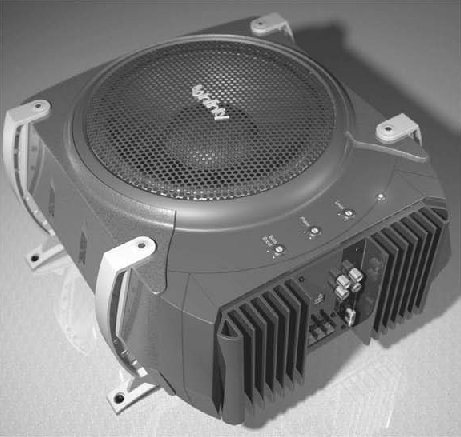

Thanks for everyones help and for the pics. I will try to find some time this weekend to break open the sub/amp and figure out what is going on. This is all new to me so wish me luck. Thanks Again!
Looked into fixing the problem yesterday. I had it taken apart but still hooked up and tried to tap on everything to wee if it would kick on and got nothing at all. There are no signs of anything that is broke or burnt. At this point it is above my level of electronics. I'm not sure where to go from here with this. I took out the amp and the control piece that is connected with a ribbon style cable.
The next step would be to check the voltage at various points on the boards. If you unclamped any transistors from the sink, you need to replace and tighten the clamps before you do anything else.
Post a list of the DC voltages on all 16 pins of the TL494. Look up the datasheet if you don't know how the pins are numbered.
Perry I appreciate all of the help you have given me but I am not a person who knows anything about electronic circuit boards. I thought that maybe there would be something obvious when I took everything apart but there isn't. I am sorry but I don't even know what a transistor looks like and I don't have any data sheet for this. I really wish I had the skills to do this but it is way over my level of knowledge. I know how to hook up the componenets, adjust etc. I'm just not able to test circit boards at this point. Like I said, I wish I knew how to. Thanks for all of your help Perry. I really do appreciate it a lot.

Perry has some great photos to help you recognize the components. The 494 is often the only 16 pin IC near the round toroid transformer and says that number on top of it. The notch in one end signifies the #1 pin end as shown on a datasheet. Also near it will be a group of transistors on the heat sink as the 12v current runs through those transistors and transformer, controlled by the 494 IC. If you want to know more about it, this is the way to find out. Things don't always melt when they blow, good thing too as it is a pain to clean up. It could be real simple, or not hard to say until you check the simple things.

Thank you for the schematic Perry. I need to test the speaker. The guy I work with has found nothing wrong with the amp so far. When you sent me the schematic you said that the speaker is a 3 ohm speaker. I didn't know that there was such a speaker. I thought they were 2 or 4 ohm for cars. What should I read if the speaker is good or bad as far as ohms? If the speaker is bad can I replace it with a regular 4 ohm 10" sub? Maybe this unit is not worth fixing. Any thoughts from anyone would be greatly appreciated. thanks agian!
I'd expect to read between 2.8 and 3 ohms across the voice coil.
A 4 ohm speaker would work but wouldn't get quite as much power from the amplifier (compared to the 3 ohm).
I have found that the speaker is bad. I don't think it will be worth putting in a new speaker though. I think I may just shell out some money for a new amp and sub. Idon't want to take up alot of trunk space though. Does anyone have any suggestions on what to buy. I think I want to go with a sealed enclosure for space savings and also I have been told that a sealed box is a lot cleaner for bass. I don't wan't my whole car to vibrate but it would be nice to feel a little bit of a bass kick. Thanks again for all of the help you gave to me Perry!
