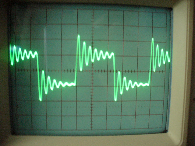

Ok, that can only be slew rate limiting but its odd as this amp is pretty fast and 50 khz square waves should be possible. I think you can ease a little on the value of Cdom cap as well which will increase the slewrate. The design has low openloop gain so little compensation is needed.
If you used say a 5 volt p-p does the effect dissapear ??

Have you tried reducing the value of R32 (between Power Gnd and input/feedback Gnd) from 10 ohms to 0 or 2 ohms to see the effect on the overshoot/ripple...
Also, you can see the phase margin using a scope with channel 1 on input signal and channel 2 on output signal and doing a Sinus frequency sweep from 10KHz to 500 kHz.
you are right, the amp is not as fast, wrong test point. I will post another picture soon. Maxpou

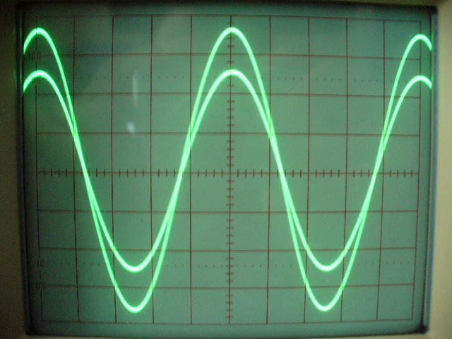

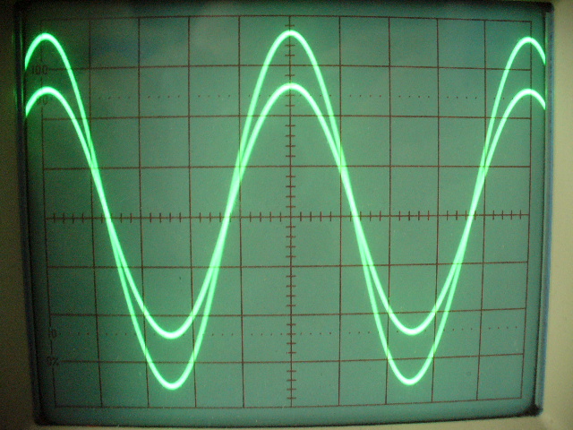

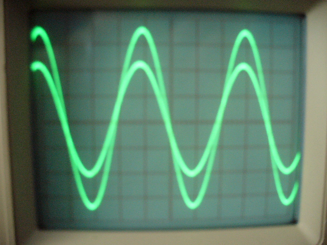

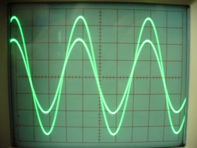

Hi Fab,
some picture of phase margin without output inductor with 6.8Ohms load. Maxpou

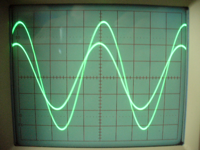

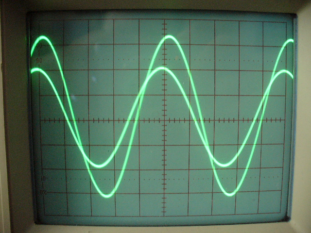

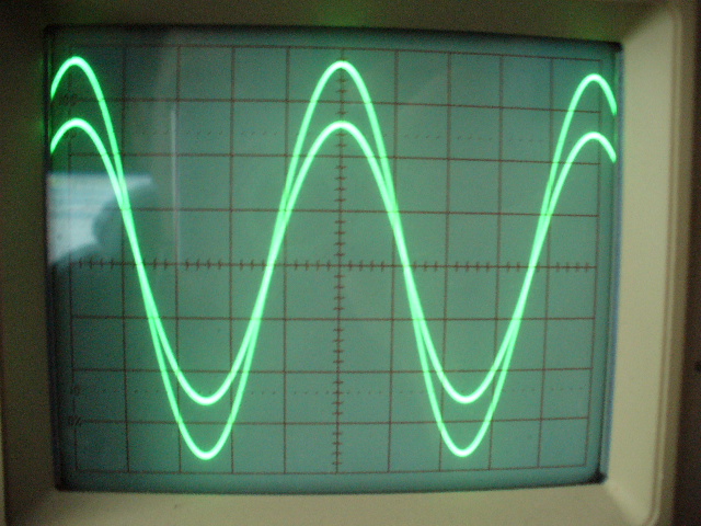

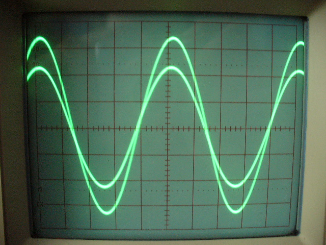

another picture of phase margin with output inductor 2.5uH. Maxpou

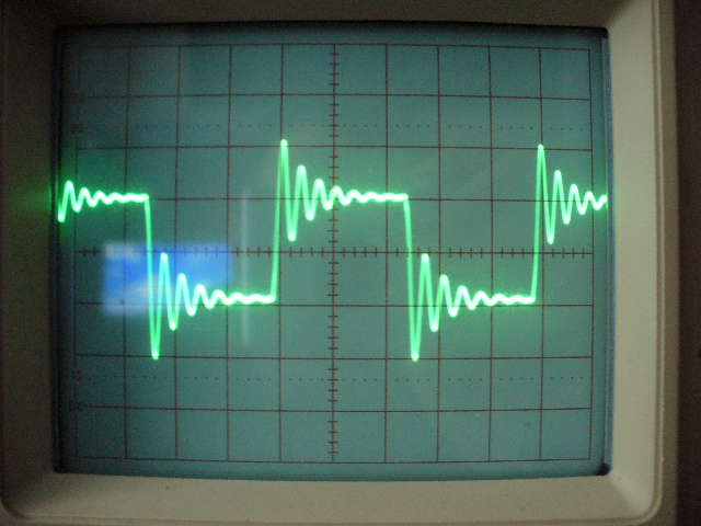

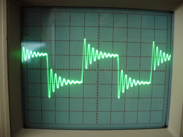

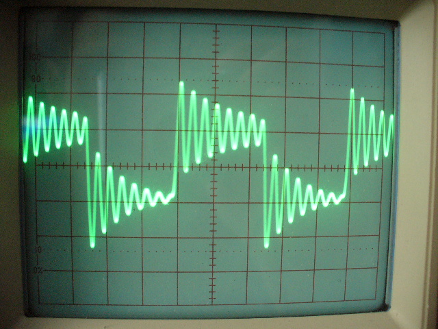

Another picture with 10Khz square wave and 6.8ohms//1uF. I have a good test point. Maxpou

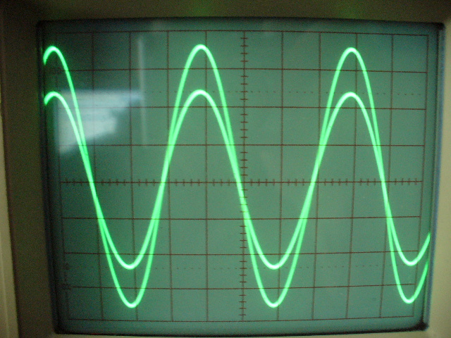

Why the ripple difference between the scope traces if the same test is performed 😕
Also, your sine traces are for which frequency? Show at least -3db corner frequency or higher.
Fab
this is not phase margin...........you can see the phase margin using a scope with channel 1 on input signal and channel 2 on output signal and doing a Sinus frequency sweep from 10KHz to 500 kHz.
The difference in the traces shows the phase shift from input to output.
You can read off the "effective time delay" of the amplifier over the frequency range from 20Hz to 20kHz. Expect 1us to 2us and for that to change smoothly as you change test frequency.
That is correct, it is not the phase margin per say. I should have been more precise on the forum.
In fact, one should inject the frequency at which the output amplitude is the same as input amplitude (gain =1). Then verify the phase shift between input and output . The output amplitude should be less than input before shift is 180 degrees. Of course one must pay attention to quickly turn off the amp in case it reaches oscillation (and use small input amplitude for test)...

I wouldn't worry about ringing with a 1uF load. Stability with small capacitive loads is important - say 1nF to 10nF. No cable or speaker (including electrostatics) is going to behave like a 1uF cap at high frequencies.I took all measures with 6.8ohms//1uF load and 10Khz 10Vp-p.
I also agree but would check as high as 100nf. I have indicated some criterias in the post #2😉 but based on posted pictures from Maxpou other members started to wonder if it could be "improved"...
I remember testing a very good sounding Tube amp and was quite surprised with the ringing (but still stable) upon 1uF/8ohms load🙄
