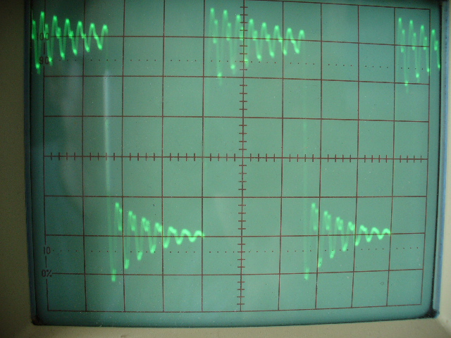

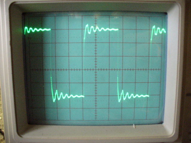

I think that ripple goes on a bit too long. It has little damping indicating that the amp or the output Thiele network is close to oscillating.
I think the 50 to 60kHz ripple should subside to near zero in less than half the period of the 10kHz half wave i.e. in <=25uS.
What's it like with a lower frequency sq wave?
That damps out fairly quickly.
Do you notice the frequency is directly related to the capacitance.
It's ringing in the Thiele network we are seeing, but it still seems to last too long
I wonder if the phase margin is a little low?

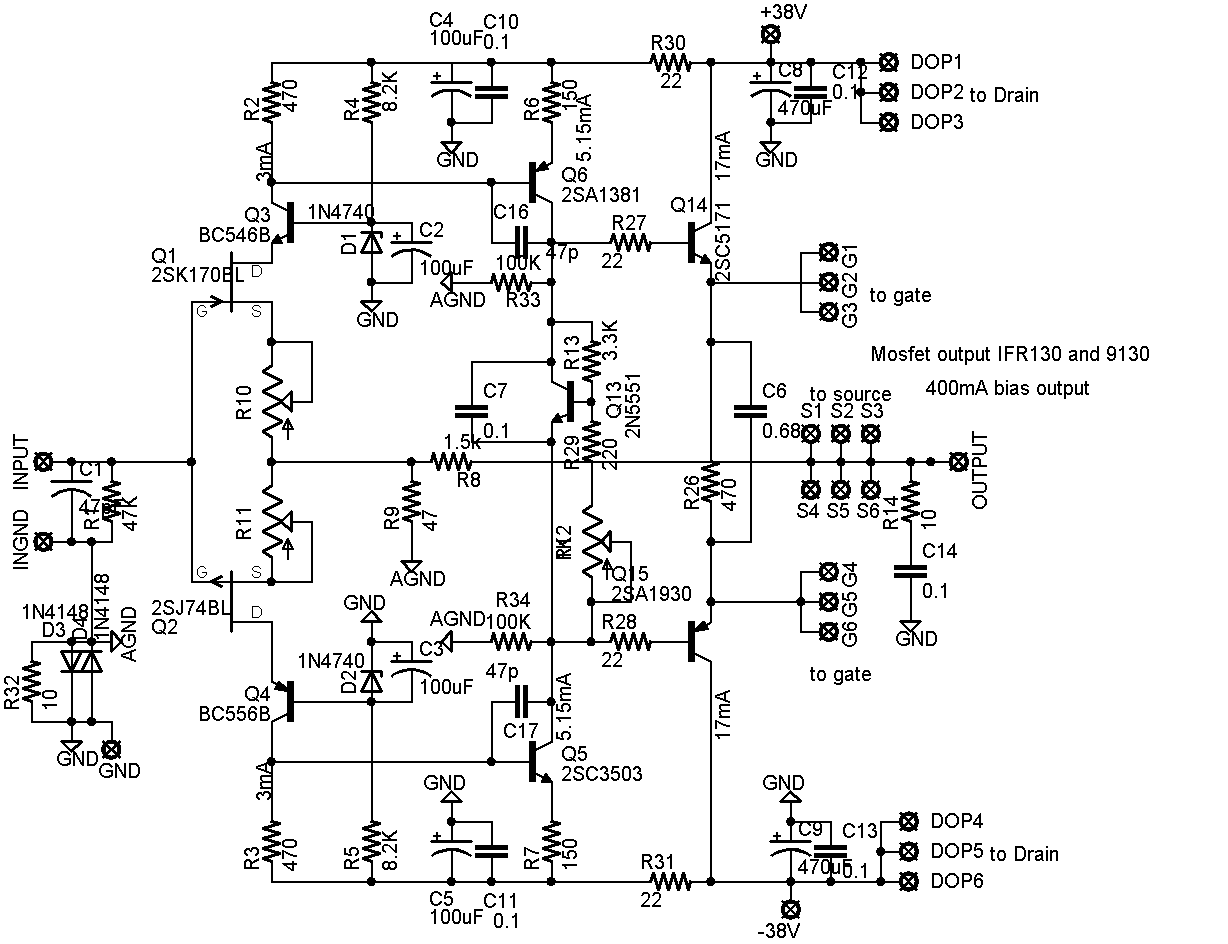

Hi Guys,
I comeback with this old thread because I make some modifications in my power amp and I don't improved the stability. Somebody can help me? In post #1 is my first circuit: http://www.diyaudio.com/forums/solid-state/117011-better-sound-no.html#post1422579
Thank you! Maxpou
p.s.: I have 1 pair of output and R33, R34 is 47K.

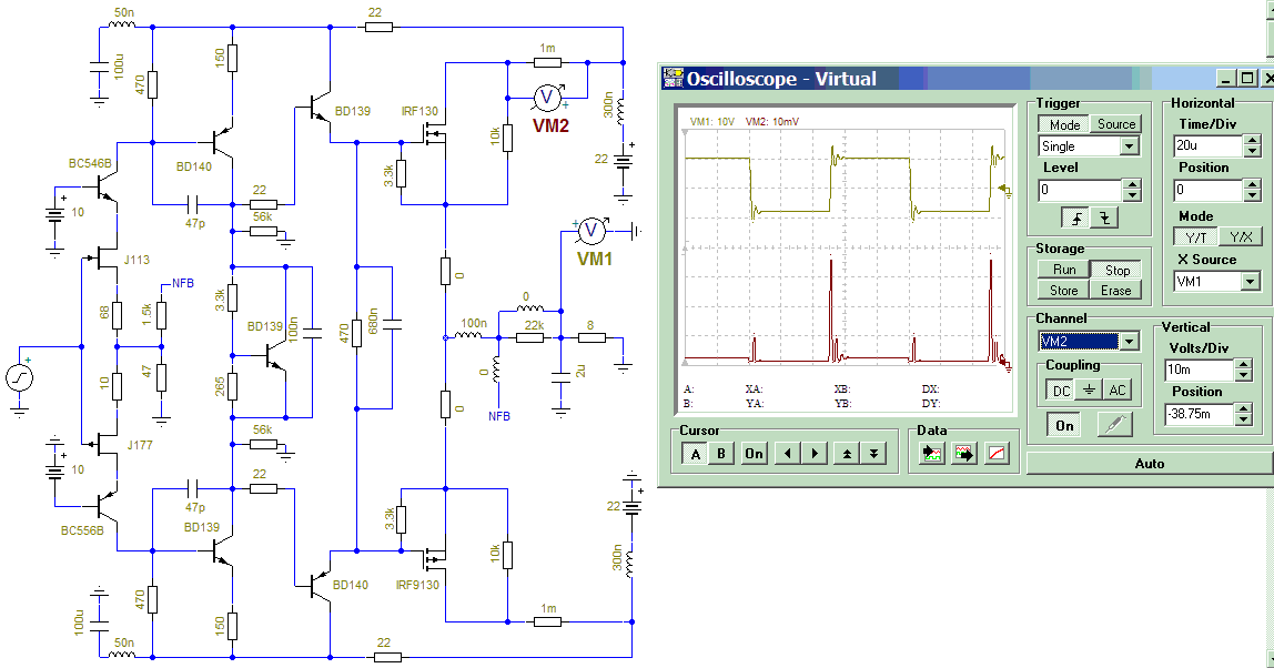

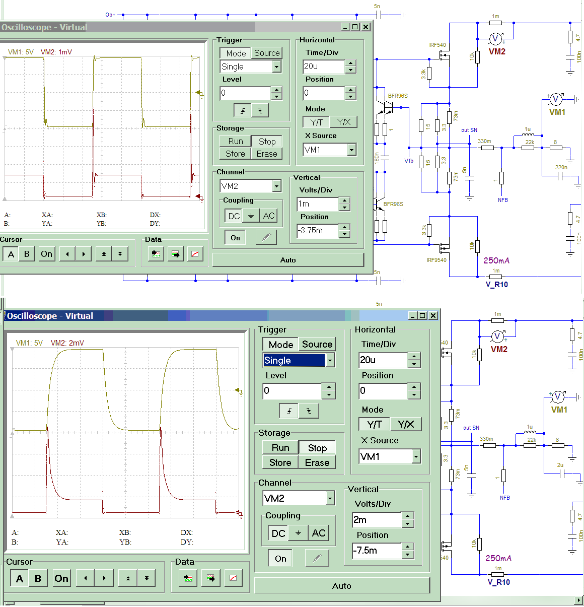

It is looks like ringing is limited for few volts that show it caused by saturated transistors or limited OPS Rds or may be also caused by limited trace capability effect, because if it caused by output inductor, ringing amplitude will also rises. I simulate it with perfect condition it has 40A peak charging output 2uF capacitive load.
The second picture is simulated my N3 buffer. Not draw huge peak current when loaded with capacitive loads is also important for some cases.

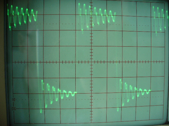

Hi Guys!,

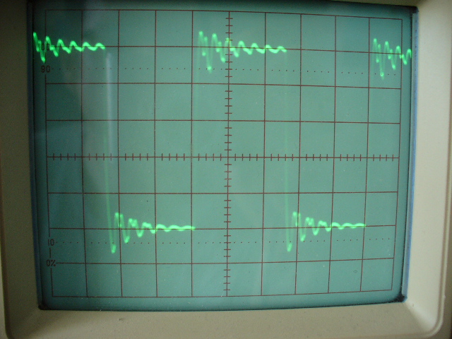

nobody can help me with my stability problem. How can I improve it? I tried a Cdom in VAS, decrease the open loop gain with R33, R34 and a input filter. If I put 3 output pairs I improve my stability or no on capacitive load? I would like to know what is the acceptable ringing square wave? thank you! Maxpou
May be slewrate limiting will help by replacing both 47pf with 220pf. The other way is placing source resistor with value ~0.5ohm and ~330ohm resistor between emitter of driver transistor and output that may help to limit maximum current.
I see this is a sim result and not a true life result, there is a huge difference. I ve built this type amp years ago, its very stable. Also youre probably not going to find a 2uf cap accross a speaker load the way you have it. Show us a real life scope pic of this problem, 10 to 1 is that it doesnt excist. Try use a diffrent transistor for the vas stage, something like 2sa1381 and complement, you can get the device models from bob cordell and see if it doesnt improve.

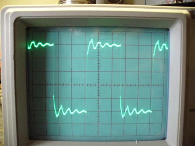

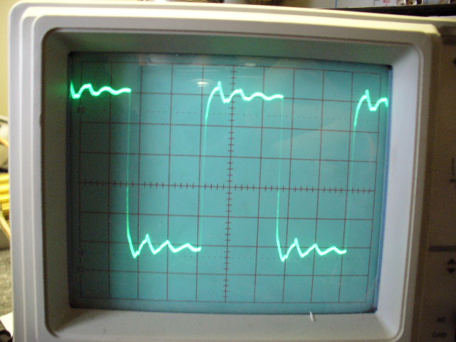

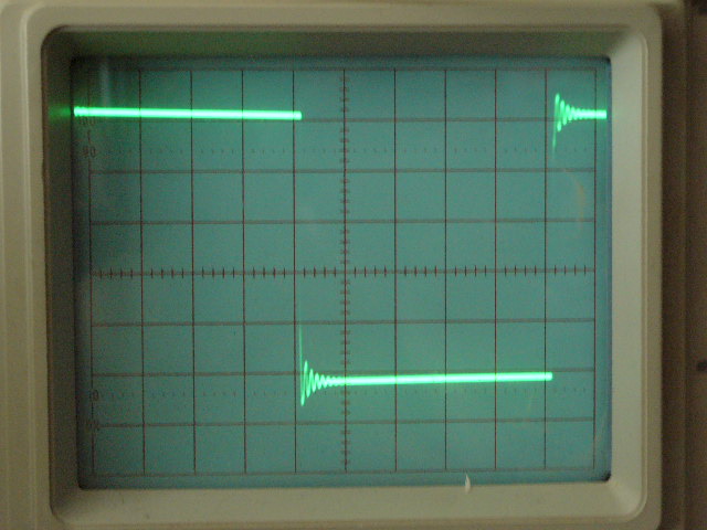

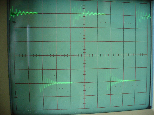

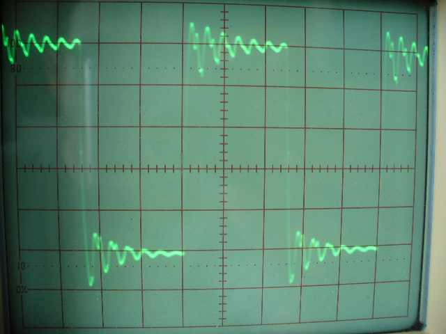

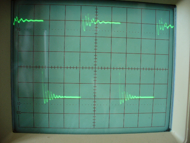

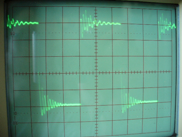

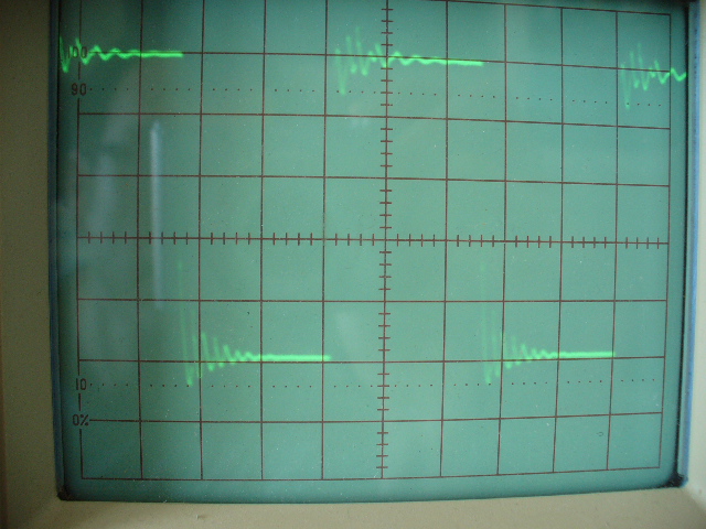

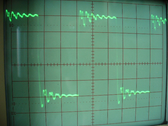

some pictures with and without output inductor. comments. Maxpou

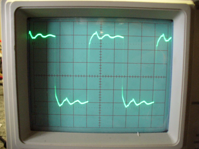

another pictures
