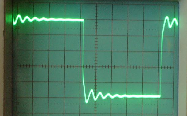

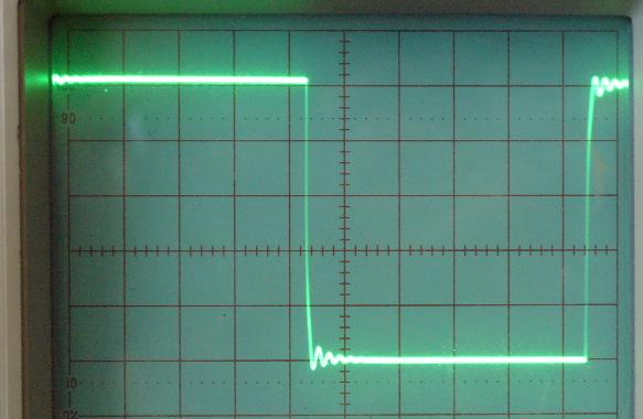

i want test my poweramp with capacitive charge but i would like to know what value of cap and if i have a precaution to take, which? i don't want burn my output ( hexfet ) thank you! Maxpou

Hi Maxpou
I suppose you have a scope otherwise...
Always put a resistor load in parallel with the cap ( 8 ohms is the standard one used and ususally represents the nominal impedance of lots of speakers).
Use an input 10 KHz Square wave and adjust the level to have an ouput of about 4V peak. Do not exceed 10 V otherwise you may have your cap to explode!!
and it smells like HELL ! 😱
1) Try first with no cap in parallel
2) then try with the small value of 1 nF then increase the value with 2.2nf, 4.7nf, 10 nf, 22 nf, 47 nf, 100nf, 220nf, 470 nf, 1uf, 2.2uf.
Normally you should see different output shapes going from a perfect square wave for very low cap values (1 nf, 10nf, 22nf ...).
After that you will reach a point in caps value where sometimes the square shape may start to deteriorate a bit on the edges. It is still OK.
After that possible roughness on the edges, you will start to see overshoot (maybe 220 nF or more) but it should be damped.
Note: If you begin to see oscillation on the square wave for a specific cap value just stop the test at this value since it means your amp is not stable and depending on the oscillation it could eventually damage the amp...
But you can test the other cap values to see the extent of the stability problem if any.
Just send us some pictures if you can (2 uf, 100 nf, 4.7nf for example).
Good luck!🙂

HI Fab,
thank's for your answer. but i don't have 8 ohms ressistance but 6.8 ohms, it's ok? thank you! maxpou🙂
6.8 ohms is OK. Anyway the speaker impedance varies a lot depending of frequency (sometimes from 3 to 18 ohms at specific frequency...). This 6.8 value should give you reliable results even to compare with other amps where the test was done with 8 ohms...

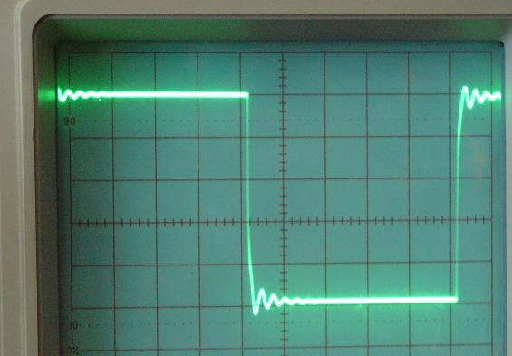

Hi Max,
that looks like a damped 200kHz (220nF) ripple fed from a Thiele network into your R//C load.
Are you using an inductor//R in the series feed to the load?
The overshoot and ripple is looking a bit big for inductor/load interaction.

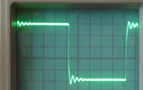

Hi Max,
that is oscillation coming in and getting stronger as capacitance increases.
You need to attend to the stability components to increase the phase margin.
I still wonder why the frequency drops as you increase the capacitance? It looks like an inductance+ increasing capacitance ripple.

Hi Andrew,
I have noticed Max that the corner frequency looked quite high and it seems that Max uses a small 47p at input of amp. Without knowing the series resistance at input, it can be a -3db frequency point over 1 MHz or more...This is not helping to get a safe stability...
I also think that Max should continue the testing with 1uF and 2.2uF to reveal more...and try to filter more the input frequency...
Aligator cables- if used- to connect test load are sometimes a bit inductive and resistive too...

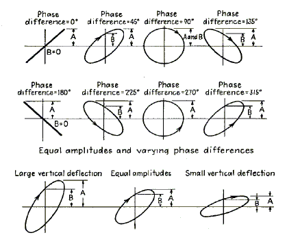

How does one set up the oscilloscope to measure phase angle? What other equipment is needed to achieve reasonable accuracy.jackinnj said:if you have a dual trace scope it is helpful to take the gain measurement out to 150 - 250kHz and measure the phase (easier said than done) -- plot both -- take two aspirins and call me in the morning -- especially if you've done this at full power (this is how to tell whether your amplifier barks or sings)
(it will definitely tell you how to fix the stability problem).
BJTs to 200kHz! 100kHz yes, but further out?
You can do it if you have access to the horizontal and vertical deflection plates -- remember how to do a lissajous figure with a scope ? -- see the attached.
sin(theta) = +/- (b/a)
If you get two high speed comparators you set up a circuit where the diference in trip time feeds an integrator and the resulting voltage is linearly proportional to phase angle -- this is how Hewlett Packard did it with their 3575A meter (and Fluke as well.) (Somewhere on my site I linked an Intersil article which described a phase-meter acurate to a fraction of a degree at 10 Megahertz -- I built the circuit but regrettably Intersil stopped making the dual long-tail pair which I used as a comparator.)
If you know phase and gain you can derive a stable compensation scheme which doesn't over damp the amplifier.
