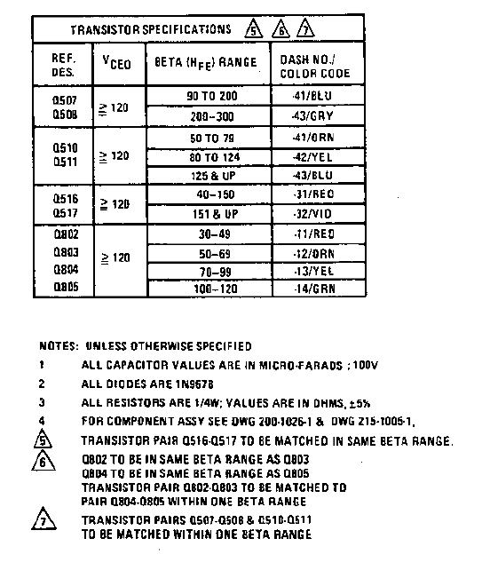

Everything is back together, but the amp is still oscillating, so I tried a little experiment today. Changed just the diff pair (Q501 and Q502) with matched BC550C transistors, then changed to a pair of 2N5961 transistors.
With BC550C transistors (hFE ~595), the amp oscillated. DC Offset jumped around like crazy, but I can adjust offset close to zero and watch it jump around between zero and ~.200 mV.
With the matched pair 2N5961, (hFE ~220), the amp stopped oscillating, but the DC offset won't adjust any lower than ~0.600mV.
Next step (unless someone can recommend something else), is to match all the transistors listed on the schematic.
If that doesn't work, I'm going to convert this thing into a Leach Amp.

Using high beta BC550C /BC560C in an already oscillating power amp isn't a good idea unless you understand compensation and layout in a power amp design.

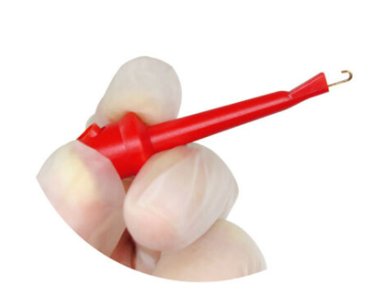

I'm using mini grabbers like the attached photo.

I learned a lot about this Marantz 1200. The differential amp pair is most important. With 2N5961 transistors, Hfe ~200, I could not adjust DC offset. With BC550C, Hfe ~600, the amp oscillates like crazy. I took some SPS1958 transistors off the phono board, Hfe ranged from high 300 to 520, and matched a pair in the 420 range.
The amp likes these. DC adjustment was easily made and bias is set at 12 mV on both channels.

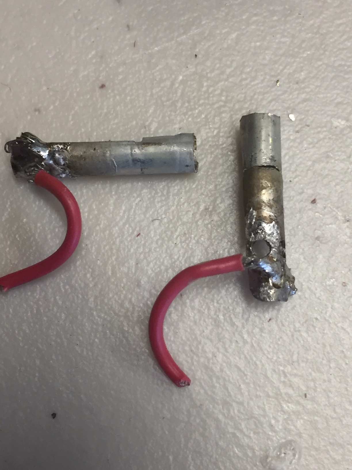

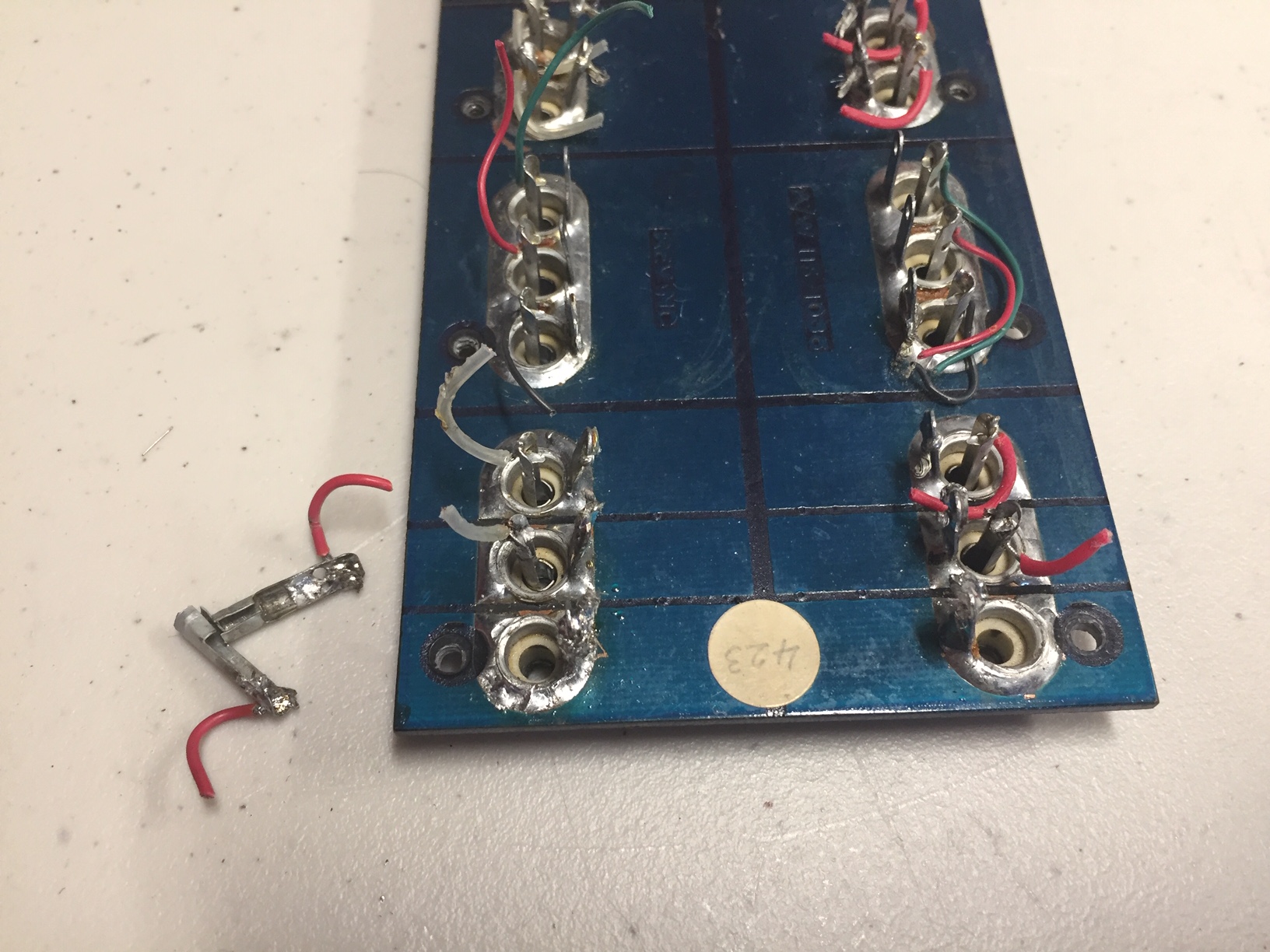

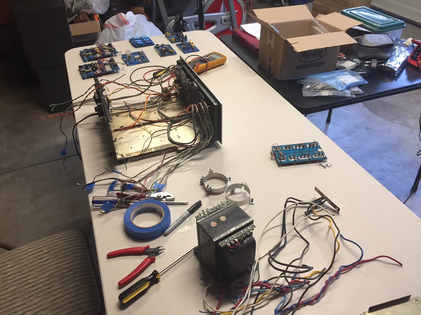

The amp couldn't play for a week without the ground hum returning. So yesterday, I took the amp apart, preparing to convert it to a Leach Amp. That's when I found the root of the problem, the RCA connectors for the Amp In. Right and left channels are shown. Only problem is, the amp is torn apart and all the parts are here for the Leach Amp.
What would you do? Install new RCA connectors and put the amp back together? Or, convert to a Leach Amp?
