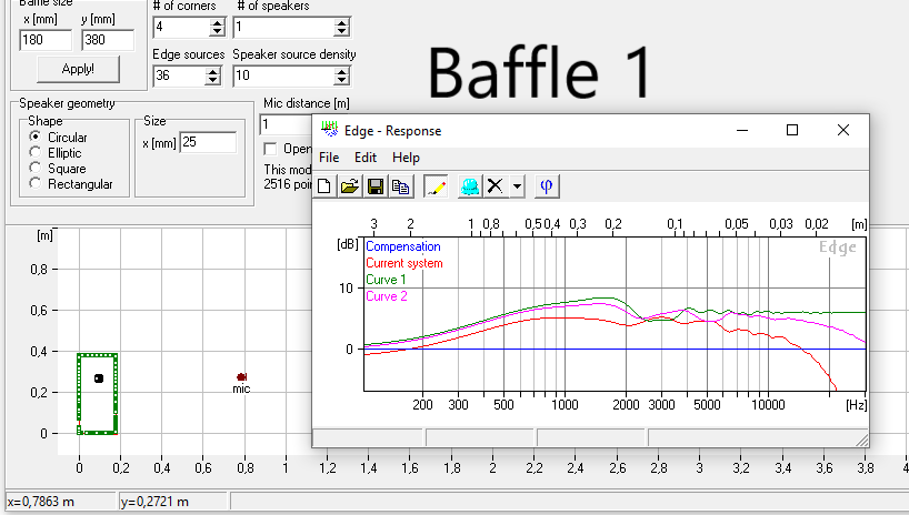

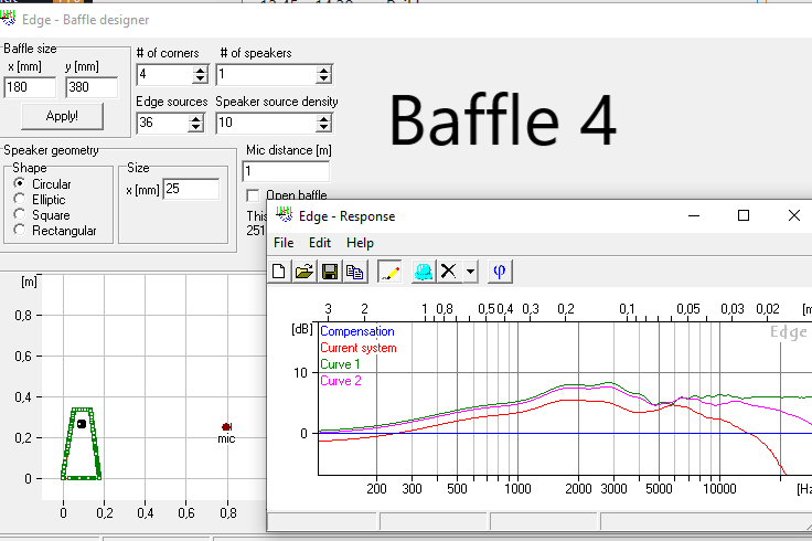

DaveFred, how's this for an experiment: Try to create a dipole, two tweeters mounted back to back on a baffle that tapers to nothing at the edge, time aligned with delay so that when the waves meet at the edge they cancel?

Geometrically, this sounds like a recipe for higher order modes.on a baffle that tapers to nothing at the edge,
You can't be talking about reducing the dipole moment for these high frequencies, the null isn't the issue, is it? The diffraction itself though I wouldn't agree a naked tweeter would be best. It would involve dissipating front and back independently, preferably before reaching the side as the opportunity is reducing.Yes, impossible to make it small enough as Juhazi says, no better than naked tweeter?
No, I was thinking purely of the diffraction at the edge. It stemmed from a conversation I had with Earl Geddes in the baffle diffraction thread relating to a naked driver with symmetrical front and rear radiation. https://www.diyaudio.com/forums/multi-way/317122-baffle-diffraction-60.html#post6001716 So you'd need a tweeter with no (minimal) baffle

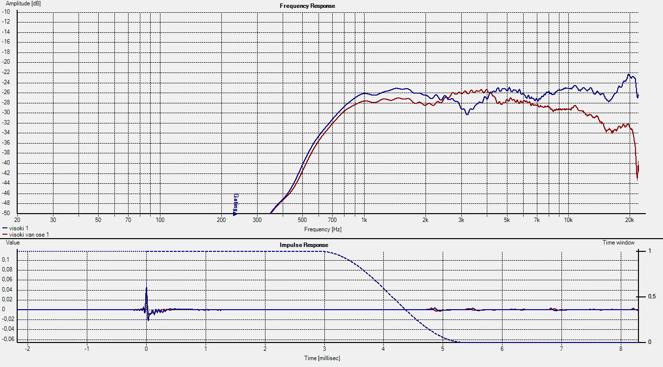

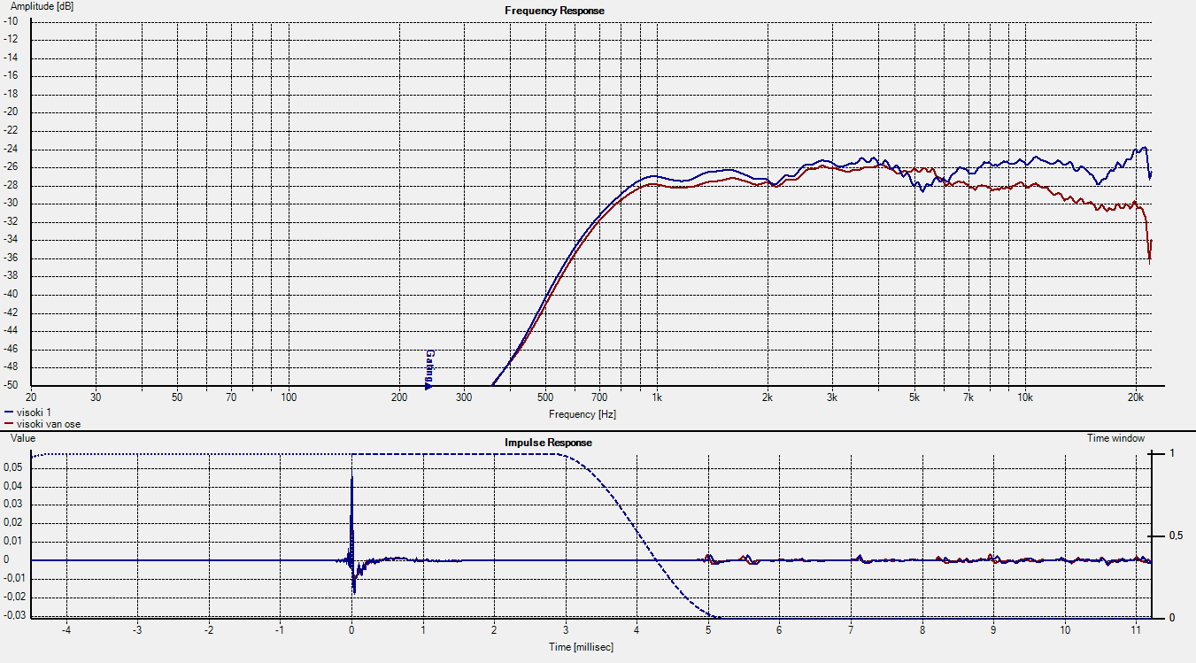

Thanks DaveFred for the dataset -- very much appreciated.
As a tangential question, can we assume that the oh-so-slight waveguiding of the tweeter face plate isn't relevant in the affected region (being more relevant >5 kHz)?

I tried a similar empirical approach and measured the results almost 35 years ago. I found that the greatest method to minimize edge diffraction effect and improve imaging in a box with a flat soundboard was to NEVER place the driver equidistant to any of any two adjacent sides. In other words, placing the driver off center and at an odd multiple distance from the top of the faceplate works to minimize diffraction. Edge shape had little (negligible) effect until you approached a sphere which is by far the best solution. Use a mirror image for the faceplate of other channel.
- Testing baffle edge treatments for tweeter diffraction.
