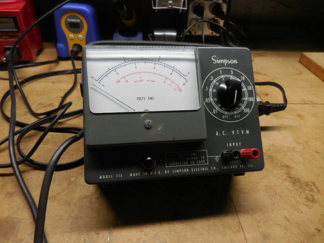

I obtained a free Simpson AC VTVM a few years ago. As I recall, it was completely dead - no light or anything. Tube complement is 2 12AT7s and a 6C4. On examination, it seems its only problem was the selenium half-wave rectifier went open. I replaced that with a 1N4007. The 6C4 also does not light up, but I will sub another tube to check that. Possible the 6C4 does not show a lot of glow - the 12AT7s glow fine.
Assuming it works now, how do I test it? Then if it works, how to calibrate? There's no adjustment to speak of other than the meter adjust screw on the front of the meter.
On my old heathkit vtvm there was a battery holder for ohms scale. On one of the low voltage DC scales there was a mark at 1.5? Vdc. You got a fresh 1.5 volt not alkaline but old style dry cell and measured the battery and adjusted the meter to match the battery. The zero pot may be for the ohms scale or to 0 the meter as the tubes drift. For the A.c. scale you measured the heater, hopefully at 6.3 volts A.C.. Back when everything was tubes close was usually good enough.
Model 715.

Being an AC VTVM, the trick of calibrating against a fresh flashlight cell is not useful (no AC in a battery).
Initial testing can be against a heater transformer or the 6V winding in a tube amp. Most likely problem is old tarnish: you have to jiggle or beat the probe or switch or tubes to get a reading.
Calibration is basically comparison to a "known-good" AC meter on the same source. If you were a Calibration Laboratory you would have a known-size AC source; but clearly you are not there yet.
Note that this meter has black probe bonded to chassis!! And maybe chassis bonded to wall-outlet 3rd pin ground. One of my first tech jobs, I didn't understand, and blew-out the power in the building.

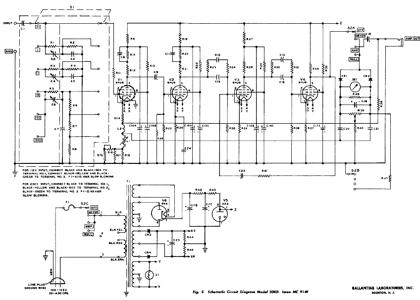

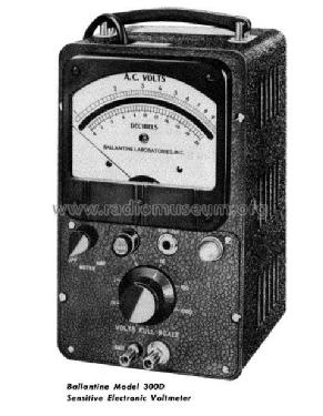

Did you look at the documentation?? This is an AC-ONLY amplifier meter. It will read to 0.03V FS which is well beyond an "RF probe" on a DC meter. It is a cheap version of the Ballantine 300 or the H-P AC-only meters. (Or multisync's Stark tube AC millivoltmeter.)
