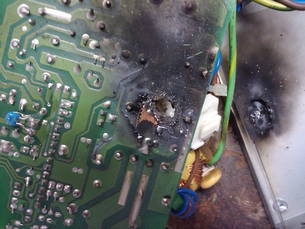

I'm replacing the PS in the son-in-law's computer. Here is what caused his problems...
Looks like the Soudnblaster Live is indeed died. I tried another el-cheapo sound card I had in my computer drawer and it works after a Passion. At least the FFT shows some peaks, and they go away when I pull the stereo Line In plug. The SBlive card just shows floor noise at -90dB. No change when the Line In plug is pulled.
Lightning can do weird things...jumping from one circuit to the next..blowning up some things and not others.
I'm not sure what caused the failure on this one. The exploded trace was after the rectifier. I have plenty of power supplies...just annoyed that it was one of the "good" ones.

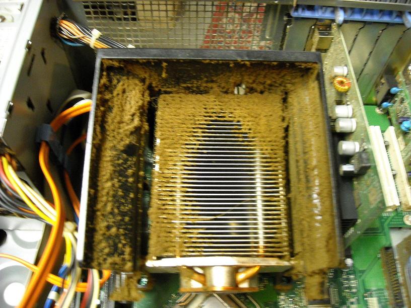

Gimp...what's all the crud from? Doesn't look like normal dust.
SIL is a heavy smoker and smokes at the computer. My best guess is the tars from the smoke combined with all the dust in the air and really gunked up all the filters. His power supply looked just as bad inside. His computer booted up when I took the PS out of my computer and used it to test the system, so I ordered a new PS for it. I just hope he hasn't damaged anything on the motherboard due to heat buildup. New power supply should be in this week. adn I'll have to let it run for a day to see if everything else is ok.
