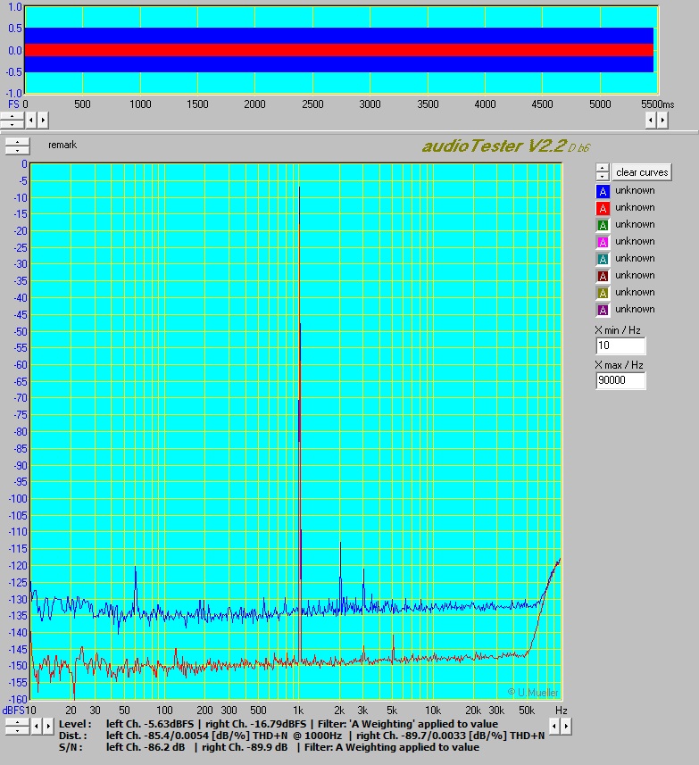

My original thought was to use a AC VTVM such as the Heathkit IM-5238 as a front end for a sound card analyzer, but it's just too noisy and distorted to use without major mods. With the Millett Meter (tm) 😀, I may have that budget Audio Precision test set I could never hope to afford...
