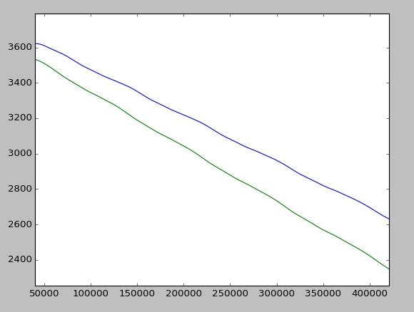

Sorry you were ill, I don't remember if you saw my plot of using the Hilbert transform on 20-20k sweep data. It should also work here.

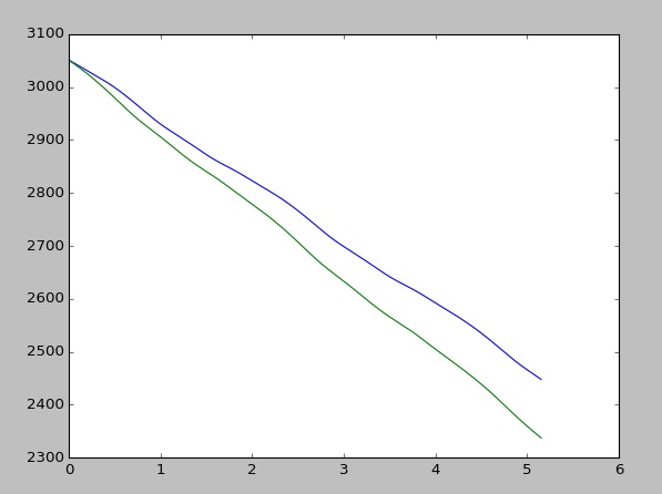

One more plot of the same data aligned and now with time on the x axis.
The top is with tracking force of 1.6gm the bottom with 2.6gm. The plots fit to a polynomial show pretty much a straight line over this range.
Blue - 3050 Hz - 116.7*time Hz + .134*time**2 Hz
Green - 3050 Hz - 137.7*time Hz + .25*time**2 Hz
If these numbers make some sense to anyone I might try to get more of the spin down (what should be the shape of a long one?)
The only reason for running further down would be if you could automagically extract any information about bearing friction from that, which I doubt. I think that certainly proves the analytic ability of the method.
