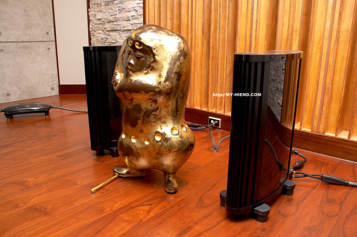

Hi Hiten,
That man's collection is lovely! Super nice!
-Chris
Chris,
here is the link from where the picture was taken. There are lots of picture links.
Link

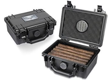

Using a humidor for spare carts is pretty brilliant.
They make some for travel which could be suitable for those of us in hostile environments. $40 on amazon isn’t bad.
That rest of that tiawanese showroom is ridiculous. But honestly if i could walk out of there with one thing it might be that giant bronze statue.
