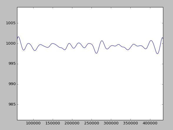

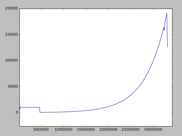

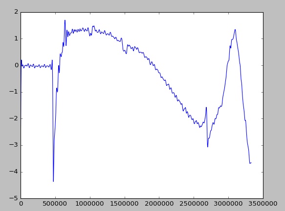

Experiment of the day.
Out of curiosity I used the Hilbert transform technique on the entire 60sec RIAA sweep on the CBS STR130 LP to see what I get.
What I did is take the entire 3,330,000 sample (44.1/16) waveform and compute the instantaneous frequency and amplitude directly using the Hilbert Transform.
The first plot is a blow up of the 1K reference (frequency). The second is the frequency vs sample (each sample is 1/44100 sec) and the third is the amplitude in dB re the 1k tone (40-20k).
The glitches on the amplitude plot are in the data and must be artifacts of their sweep generator (they are exactly the same on all the sweeps) as well as AM from cartridge wobble.
Just an example of what is now possible with a few lines of code and a second or so.

How good is Viktor's 1kHz oscillator directly (not master-cut, stamped onto vinyl, then played back thru a cartridge + phonostage)? Does it display drift and glitches like your third plot?
The third plot is a 40-20k sweep we would do this with a digital file hopefully eliminating the aberrations. I think we have a great advantage in technology at this time.
