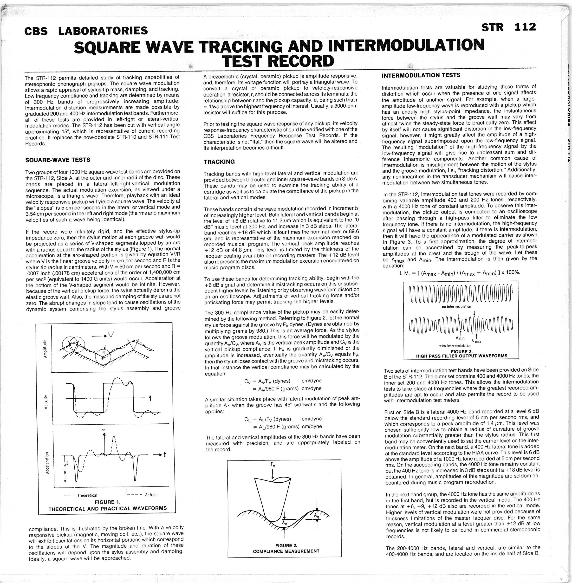

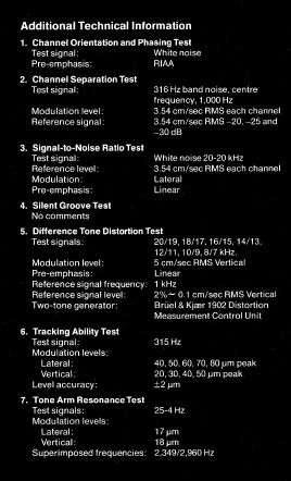

I compiled the first iteration of a tracklist. Some track can be moved to side B. Disc 2 could be same @ 45 RPM. I can imagine two options: a double set with 33/45, or a single 33 only for those not interested in 45.
Please feel free to edit the tracklist. Any ideas how a vertical azimuth test could be done?
Also please read this article about cartridge tests:
Cartridge tests
Information about Ortofon and CBS test records also attached (@moderator: please remove them if it breaks copyright rules)
