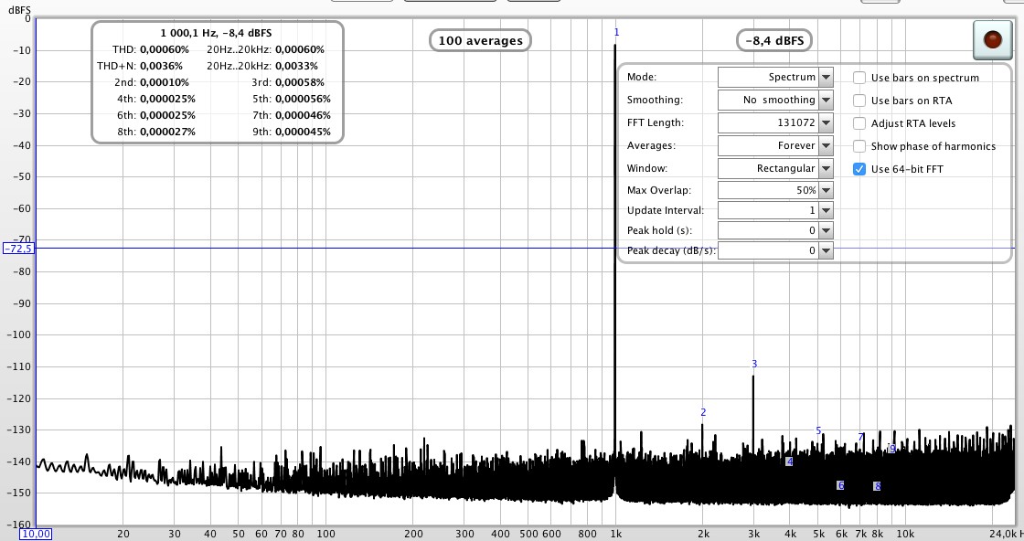

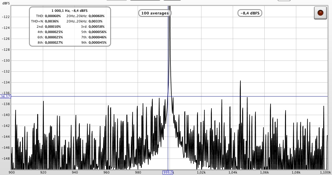

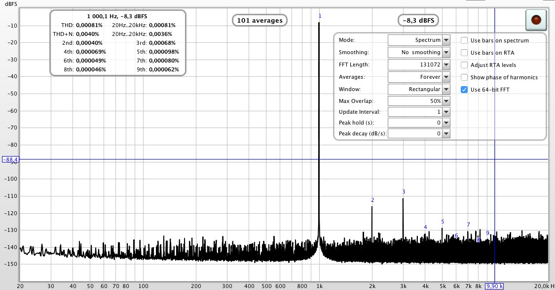

Hi, yes, sounds logical to me as well, the dac and adc are using same mclk and are probably triggered by same lrclk. but please look at that, just done few minutes ago

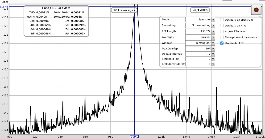

this is 2 RTA made with REW. first is EMU0404 in simple loopback. second is focusrite scarlett 6i6 2nd gen.
the jitter around the 1khz can be represented by the difference between the noise floor of the FFT and the point at say 999hz.
for the EMU it is 16db and for the 6i6 it is around 30 as you can see on the zoom...
so yes jitter should be represented here and fft should be very straight, but isn't.
for thoughts

It can either be:
1- Clock distribution jitter (ie, DAC clock and ADC clock both pick up different amounts of noise). This can also happen if noise crosstalks into the clock traces, or DAC/ADC use two clock buffers with noisy power supplies, or noise on DAC/ADC digital power supplies, or clocks are routed through a FPGA, etc.
2- Noise on DAC or ADC voltage reference. Since the reference is a ... reference ... then DAC output voltage is the sample value multiplied by this reference voltage. Likewise ADC digital output value is analog voltage divided by its voltage reference. Noise (random, or fixed frequency) on the reference will cause a graph which looks exactly like jitter.
The way to know which is which is to measure it as 2 different frequencies, like 10k and 40k.
Jitter influence is proportional to signal slew rate, therefore frequency. If it is jitter, then the skirts will go up and down. Skirts at 40k will be 4x higher (12dB) than at 10k. And skirts at 10k will be 20dB higher than at 1k.
Noise on voltage reference is not affected by frequency. Skirts will be identical wether the test frequency is 1k, 10k or 40k.
For example, a buddy had spikes 50 Hz on each side of the test frequency, which were caused by 50Hz ripple on the reference voltage.
So if you post measurements at 1k and 10k (or higher) then we'll know !
Note that it's all pretty low here... -130dB... not that bad eh !

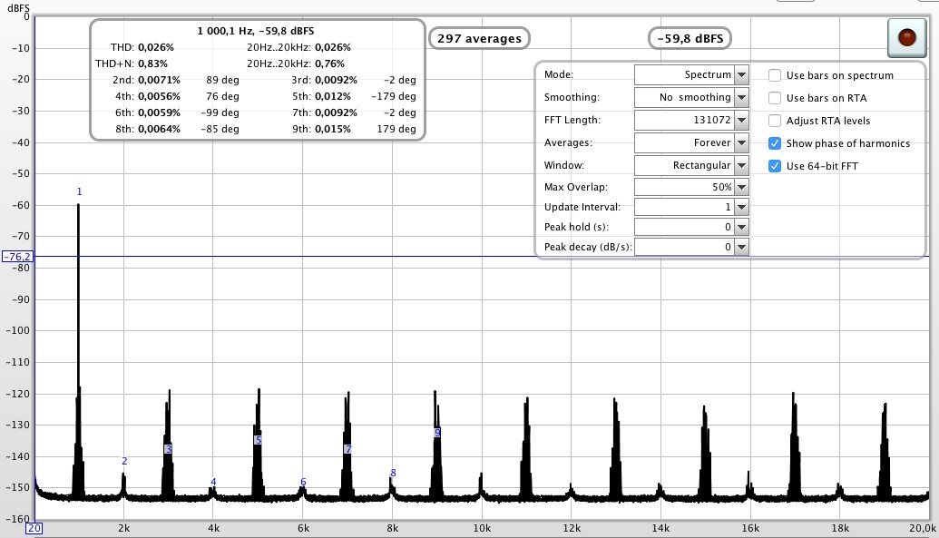

also, I was doing same kind of averaged FFT at -60db (ADC read with a 10db DAC signal and pot correction for -50db) and got this fancy figure which looks like a kind of j-test or result for a square signal
based on this , I ve used 16bits with dither and this has just reinforced the bin weight.
Can you or someone give feedback on how to interpret the ADC behavior based on this ?

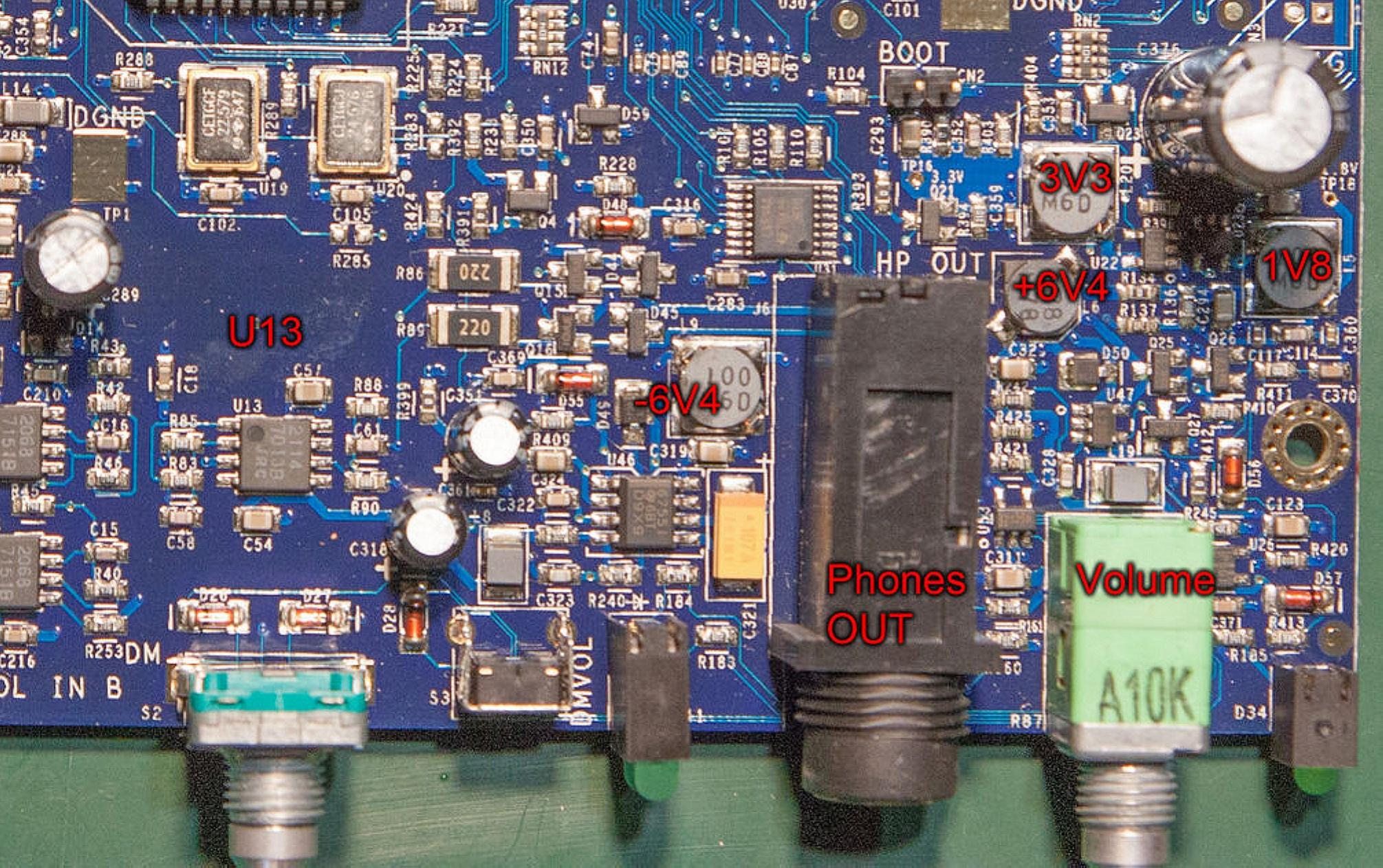

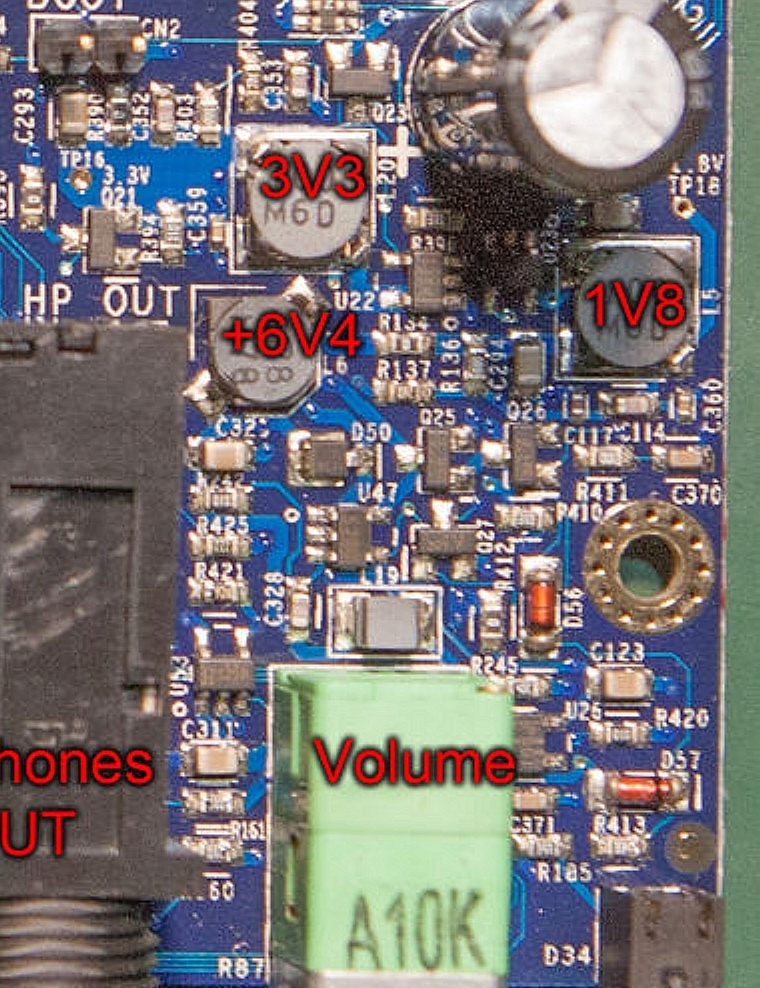

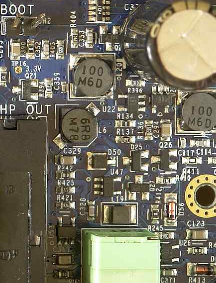

Hello
I don't want to do big modifications on my E-MU 0202, I just want to reduce the noise with simple modifications, any suggestions ?
First, on which pins at the 1V8 I should connect a capacitor on its output to reduce the 1MHz noise ?
And on which pins I should connect capacitor on the +3V3 , +6V4 and -6V4 output to reduce noise ?
Thank
Bye
Gaetan
