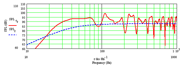

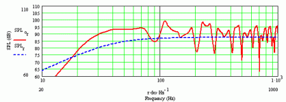

Oh boy. Lot of things to wade through.
OK, first up, FWIW, I'd shift the original non 'E' Sigma line length to 128in, with a zdriver at 27in. The 168ESigma can be pushed a little harder -a 140in line length with a zdriver of 30.25in would be nice.
The AER? Nice driver. I was listening to a pair yesterday, run OB with a Supravox bass driver (Jame's D's Quasar). Outstanding. A BIB for them will have to be pretty large owing to the migh Q and Vas (in BIB terms, mid Q is fine if Vas is low; flip side is that you can get away with a relatively high Vas if Q is low. YMMV).
Line length 160in. Zdriver 34in. Sl=250in^3.
Optimise for ceiling height? That'd need someone with more math ability that I have. Martin or Greg could do it I'm sure, but not me. Generally, they're pretty forgiving and work passably with just a rear wall to load them. In a corner, even if the ceiling is too high, you've got two reflection boundary conditions, so it should be happy enough.
