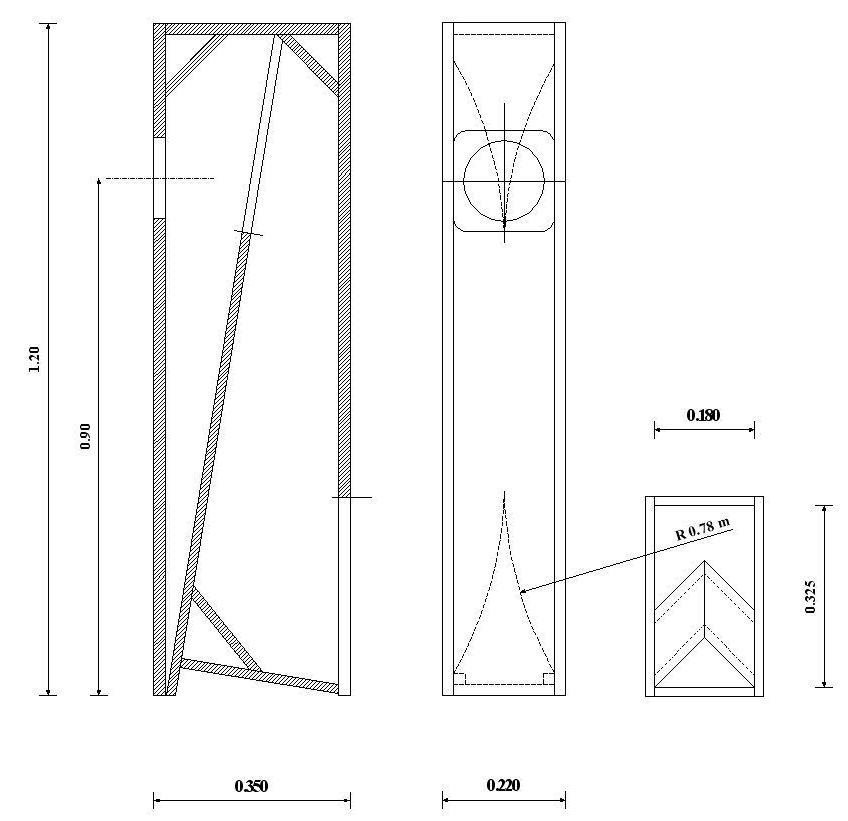

Re: Dutch design...
moray james said:
That is the enclosure i am planning to build
with the Fostex FE 167 E..
When they are playing.. i will post the results
