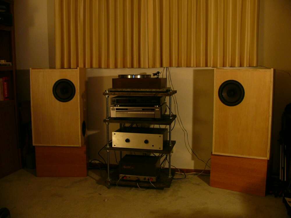

Your friend is obvoiusly a man of impeccable taste! 😉 EL34's and BR Hemptones are exactly what I'm listening to (Los Lobos' "Kiko and the Lavender Moon" at the moment). I wish I could give you a "solid description", but it's still early days with the Hemps, the cabinets are unfinished and undamped, and I don't have a broad enough experience with systems other than my own to feel confident in making broad proclamations. Not that that has stopped me before...
The Hemp's are under two weeks old, and still breaking in. They sound a bit bright, singers sound too 'nasal', but that's smoothing out day by day. Bass is good at least down to 40 Hz in my room, I feel no need for a sub, but the balance is a little hot. I'm trying to be patient as they break in, but I do wonder if a mild treble shelf / BSC circuit will be required in the end. Or a little damping on the whizzer.
Much of my listening (like now) to the Hemps is while I'm sitting across the room at the computer with them behind me. Every so often I hear someting from them that makes me turn around and stare slack jawed at the space between the speakers. Last night it was Norah Jones' piano hanging in space just inside the right speaker. The other speakers I've had in this room (like my FR125 BIB's) have never grabbed my attention like that. There is some magic in these speakers, but it will take some time and playing around to draw it all out.
The hemptones' break-in was a real roller coaster ride in my experience. Sometimes they sounded just awful, and abruptly changed, and vice versa. After about +100 hours, they very suddenly smoothed out. I suspect they need upward of 1000 hours of real playing to soften up. Also, like the Sigmae, if you do not play them for a time, they become "new" again, their break in somehow will backslide. I would say they have all the resolution of the Fostex E series, possibly more, or different, a more rounded, warmer tone. More musical. This is all about TONE.
I would suggest adding some Dacron polyester fluff in behind the whizzer, maybe tying it in with dental floss. I do not think they will need any correction which negates the "active" aspect, and can wreak havoc with the sonic of most tube amps. Play around with it. It is a killer driver, properly rolled, and ignited. It will pick up some sensitivity, and you should begin to get some more grunt in the lower register in the near future.
I bet PP EL34 has some nice sparkle and spank. EL84 very very smooth with these things also. Actually, they sound damn good with any amplifier, it seems, not picky at all.

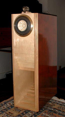

blumenco,
Looks like your new baby horns were inpsired by this one:
Yes, that is Jay Fisher's Fostex Rx horn for the FE168es-r which he picked up from J.A.Pan & Co. He swears by them. Also, Jay designed the look of the Big Boppers above, and GM calc'd the load itself. It is a load based on Martin's worksheets, with porting on the bottom. The stands are things of beauty, and you cannot see the lines from the front. That pair is Jay's, I believe, which now reside in Santa Monica, at his home. I will be visiting Jay and his wife, and hearing the speakers, in January. I look forward to that listening session. I believe two pairs have been built so far.
I know Jay is eternally grateful to GM for such a successful execution of design.
