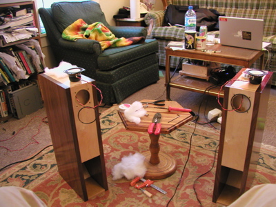

You could think about building the FF225K BIB to as size you and yours can stick, then contour the sound to taste. I haven't heard those drivers, but I know a couple of people with expert opinions on the matter, who believe Fostex were pretty damn successful in their attempt to come up with an inexpensive clone of the JBL LE-8. You can't beat that!! Possibly the 225K is the unsung hero of the 8 inch wideband parade.

That is good advice! I've built several cabinets for my fostex 168s... three ported (small, med and large), a bk161 back horn, a straight pipe and they are now waiting (and waiting...) for their bib to be finished.
Fortunately i have a pair of 127e's to enjoy as well as Pioneer/Piezo... maybe that's why the bib is taking me so long... i still have good sound at home or at the office.

Been cogitating on it. These are big, for sure. About 9 or 10 cubic feet. But they could become the next best thing to in wall speakers.
