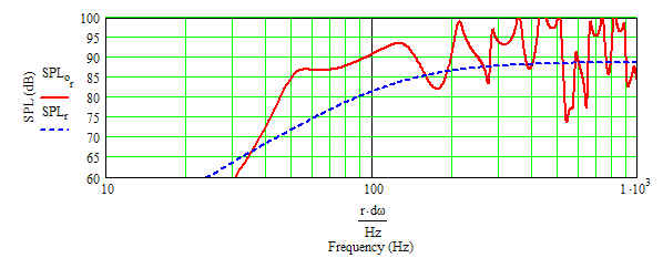

Strange. I'd like to believe the published ones too -you'd think they'd be relatively good for something like Vas, given that it's a rather critical parameter. More than double is a bit excessive, you would think.
BIB using published parameters:
Line length 150in
Zdriver 30in
Sl=109.375in^2
If K&T are correct, then it'll still work in the same enclosure, believe it or not. BL drops to ~8.8 from 13.025. The shape of the roll-off chenges, but luckily there's plenty of Vb with these boxes, so it's possible to still get away with it. Not as much LF power, but it should still do the job, and might even be more forgiving regarding placement. I say 'not as much LF power' in relative terms of course -I don't think there are many other FR horn enclosures that can kick out this sort of grunt.

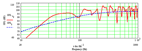

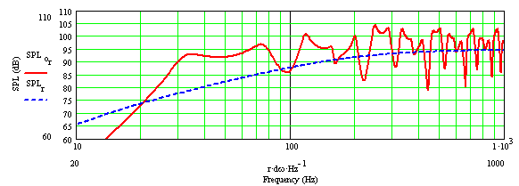

Dan, you said "the Hemps will require at least a 300in^2 cab", but Jim built a 200in^2 cab
as per Scotts' dims. Do you think you'd be losing much this way? I can argue the case for a
big cab, but not 300in big.

Hi John, Take a careful look at the graphs on the BIB site re 200^ in vs 300^in. I'm happy with the 200^ in. In corners bass is powerful and plenty. I had to build mine out of reg. ply because baltic birch here is 5'x5' I don't like MDF but BIB's are so easy to build you could do the MDF and if you like them upgrade later. I have played with visiton B220 and several of the Fostex. The hemp is the best sounding driver I have found to date. Go for it. Jim G.

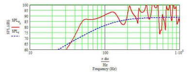

Nothing to write home about, so I recommend trying floor loading:
L = 84"
Sm = 15"^2
zdriver = 17.64"
GM
Yeah, Fs is too high to be ideal for this sort of load.
John -I agree with Jim; although I haven't tried it, just compare the graphs of the 200in^2 Hemp to, say, the 168ESigma. I hugely respect the Sig., but in this case, it's going to have to eat dust. Check the SPLs of the two at 30Hz. It's a good 10db higher. Still not small, but if you can live with the cabinet size... 😉
