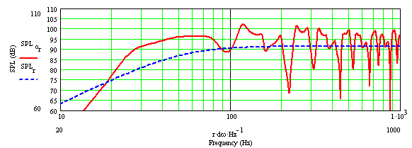

If you have the space, you could achieve this with the SP-200X:
150in line length.
Zdriver 30in
Sm=221.875in^2
I didn't bother with this before, because it's a very large enclosure for a relatively cheap driver, and I reasoned that those with cheaper drivers probably would not be wanting to spend as much on materials. The existing box, lengthened to 150in will also have a small improvement in the LF regions on the original, which isn't exactly a slouch itself.

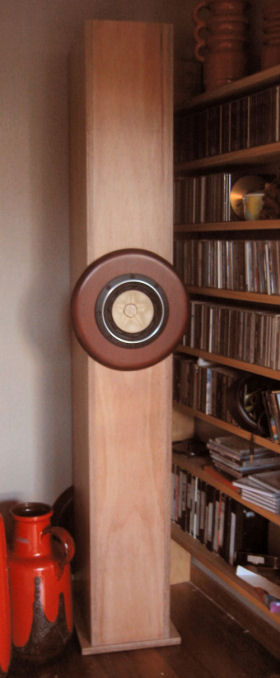

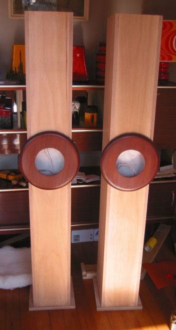

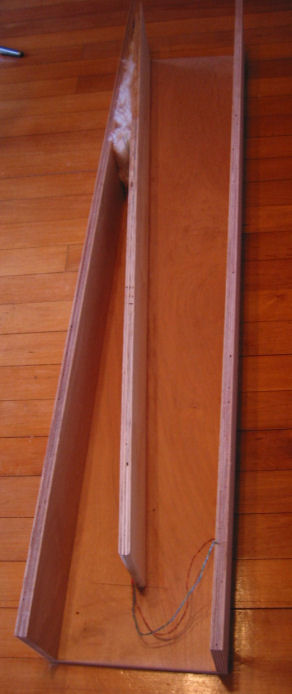

Just finished a pair of BIB-168 cabs and thought I would share my impressions and a few pics.
Cabs went together really easy using clamp and glue method - not much more to say on that really!
Having completed the cabs took the FE168s out of the Brines FT1600 cabs where they had been running in and put them in the BIBs. The drivers have had something like 50-70 hours and only just past that initial nasal sound - still more running in to come. They were sounding good in the Brines cabs - open midrange, good bass extension but the move to the BIB cabs was quite dramatic and beyond my expectations. The sound "grew", not just the awesome bass extension and control but a bigger, room filling sound along with BIG soundstage (speakers in the room corners). Ballance entirely different from the Brines cabs. Seem to produce more sound per watt as well, volume control typically 4-5 clicks down (stepped attenuator - 1.5db/step). More than just the 2-3db benefit from not using the BSC filter in the Brines cabs.
Last night changed amps replacing my mega$ Plinius SA100 (100W calss A) with a T-amp (AMP6). The amp6 very easily drive the BIB-168s LOUD and seem to free up the bass - even considering moving them in from the corners a bit! Clearly the T-amp is a good match, will try my Gainclone later.
BIG thanks to all who have made this design available and refined it - this is what DIY is all about guys!
And the pics - finished and making sounds!

Very nice work indeed. I take it you like them then Chris... ;>)
The lower damping factor of the T-amp works well with FR drivers -it's a pretty natural combination. The BIB will go louder for 1w input than Bob's superb FT-1600 MLTL (I'm a fan) even without the circuit because, being a horn, it produces considerably more gain. In only 1/2 space, it's up about 93-94 db 1/w 1/m, and you can add more to that due to room-gain -how much more depends on position.
Best
Scott
