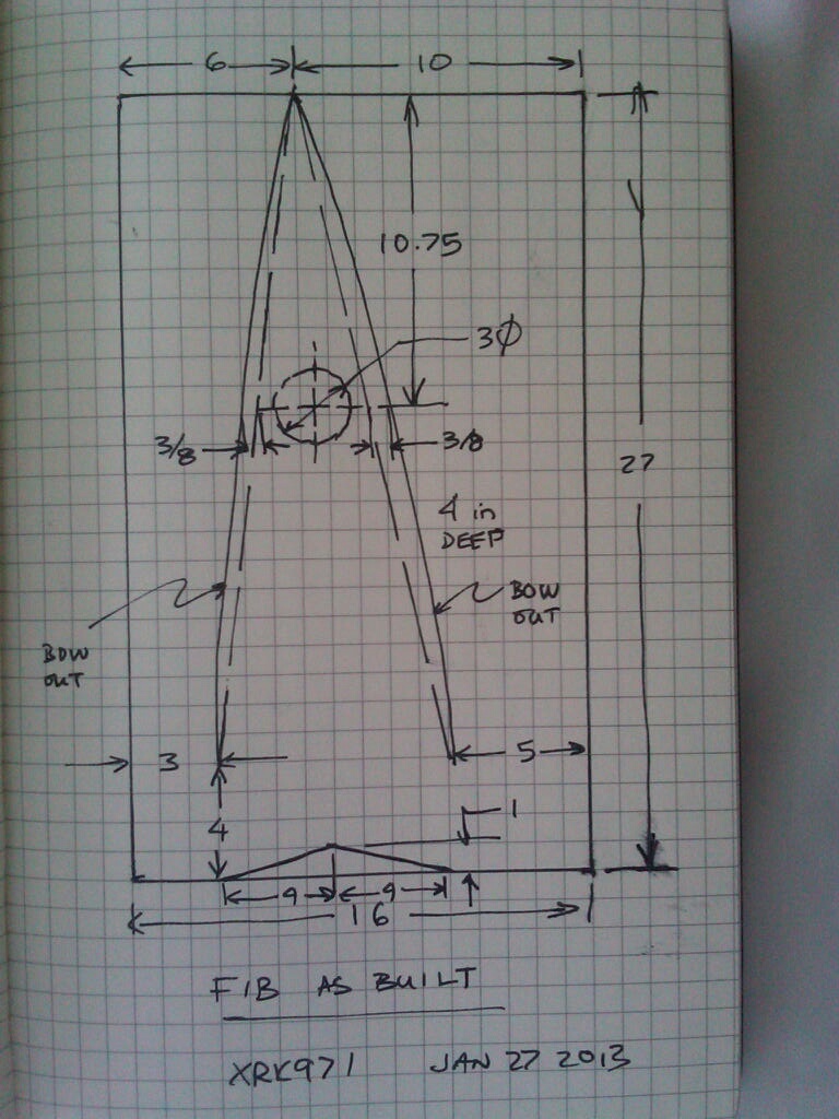

Update on FIB build in foam core - air leak solved
It is probably an air leak at the bottom cap. I will try sealing with plumbers putty before gluing. Everything says it should work, it must be the seal...
Should be monster bass if it works.
Ok, good news, it was an air leak on the bottom cap. Once I sealed it, it sounds great! Nice bass and it couples to the wall very nicely. I had to line the flat surface behind the driver with a layer of open cell foam and added more stuffing into the triangle cavity above the driver. This improved the tightness of the bass. Less boomy. Anyhow, it was a good result and I am now proceeding with the second unit build.

Kec,
The external dimensions are 27 in tall, 16 in wide, 3 in deep. Thickness of material is 3/16 in. The divider is an inverted V (mildly curved to make room for driver) and V comes down to 4 in from bottom so that 8 in x 3 in cross sectional area is preserved. V is laterally offset so that top of (vertex) is 2 in to the side of centerline. Driver is located 10.75 in from top edge. I offset V to reduce phase interference from centrally located driver and to reduce possible phase cancellation issues from two identical mouths combining at top. The curve in the V divider is such that an additional 3/8 in on each side of V is provided to original space next to driver location. Hope that helps.
FIB as built
As built dimensions in inches.

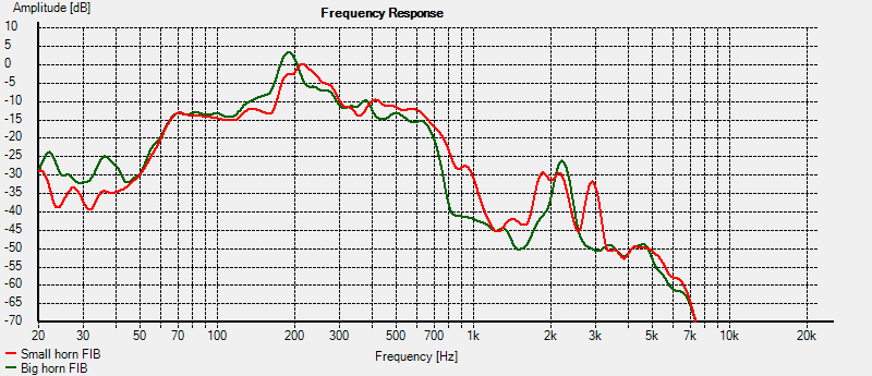

How much stuffing is usually required and where do you put it? I have the section under the driver loosely stuffed and notice a big bump at circa 200 Hz, maybe corresponding to the 16 in wide half-wave mode? I think that is what it is because it is shifted slightly depending on whether I measure the small or big mouth's output. It is huge, 10 to 15 dB above rest of bass platform. I am getting bass down to about 70 Hz so maybe combo of stuffing bottom and adding constrictor at top?
