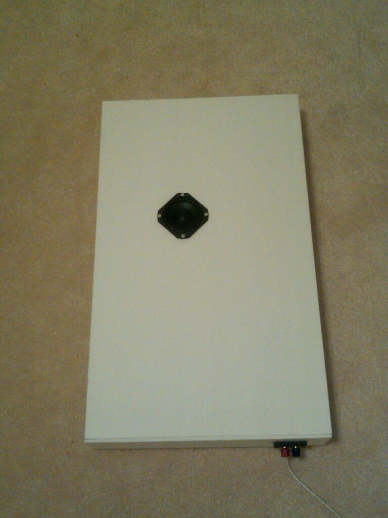

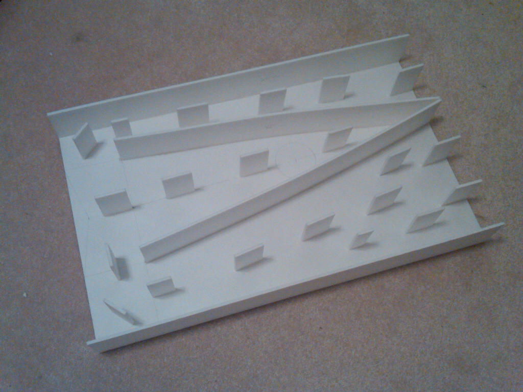

I decided to go with the 16 in wide x 27 in tall x 3 in deep FIB with an offset inverted V center channel. I am just about to glue the face on with PVA. The size feels good when I hold it up to a wall - like an average sized poster or painting.

I thought about the inverted V divider (if that is what you mean by a V shaped divider - good point about bracing), would that not split the mouth into two horns and thereby change the lowest freq the horn can reach due to reduction of the mouth circumference. The curved single divider wall is merely to provide additional clearance for the driver. One option is to make the V divider lower than the top of the box so that the two horns can merge back into one and maybe provide the larger horn mouth?

You could possibly put a bend, think very open V, in the end cap for strength. This could keep it from rattling. You could go from each end to the center brace you added. It could be one solid piece, with a crimp in the middle.

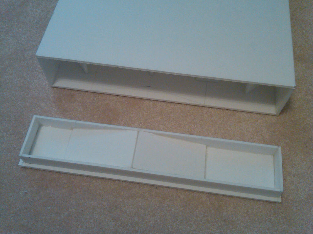

I just put the FIB together with the driver and it just does not sound like a BIB at all. I am afraid the split path with inverted V is completely different in character as the huge BIB mouth circumference is now replaced by two much smaller mouths. I had to really pull the stuffing to very little in closed end above driver and a little beneath. It could be that I have not sealed the bottom cap on with glue as I needed to adjust the stuffing. A tiny leak can cause problems in a horn- that might be the reason... Right now the bottom cap has a lip to help provide a static seal but probably still not airtight. Sealing it with glue will committ me to the stuffing in the lower section, although you can still pick at it thru driver cutout, just more difficult. Maybe all I can do is seal with glue and see.

Yeah, in the right place, a near pin prick is sufficient to let most of the horn's pressure bleed off. I've seen many drivers not perform well because their surround was a little porous.
You can temp seal it with neoprene gasket or even BluTak.
Two smaller mouths shouldn't make a difference if they sum to same CSA except higher up due to the shorter eigenmodes across them, so at worst you may need to damp their perimeters.
GM
As already said there is very little physical difference between the one-mouthed and two mouthed approach. If anything it probably has more to do with the radical shape of the cab. But I can't think of what the exact problem could be.
Have you boundery loaded it?
Idealy a BiB should be pushed in a corner or at least have some half-space boundary loading, like ceiling and wall.
Try inverting them.
Your spiral horn worked fine and since this looks to be the same driver, you shouldn't get that much of a difference in result. At least more bass quantitatively, because of the larger size of the cab.
